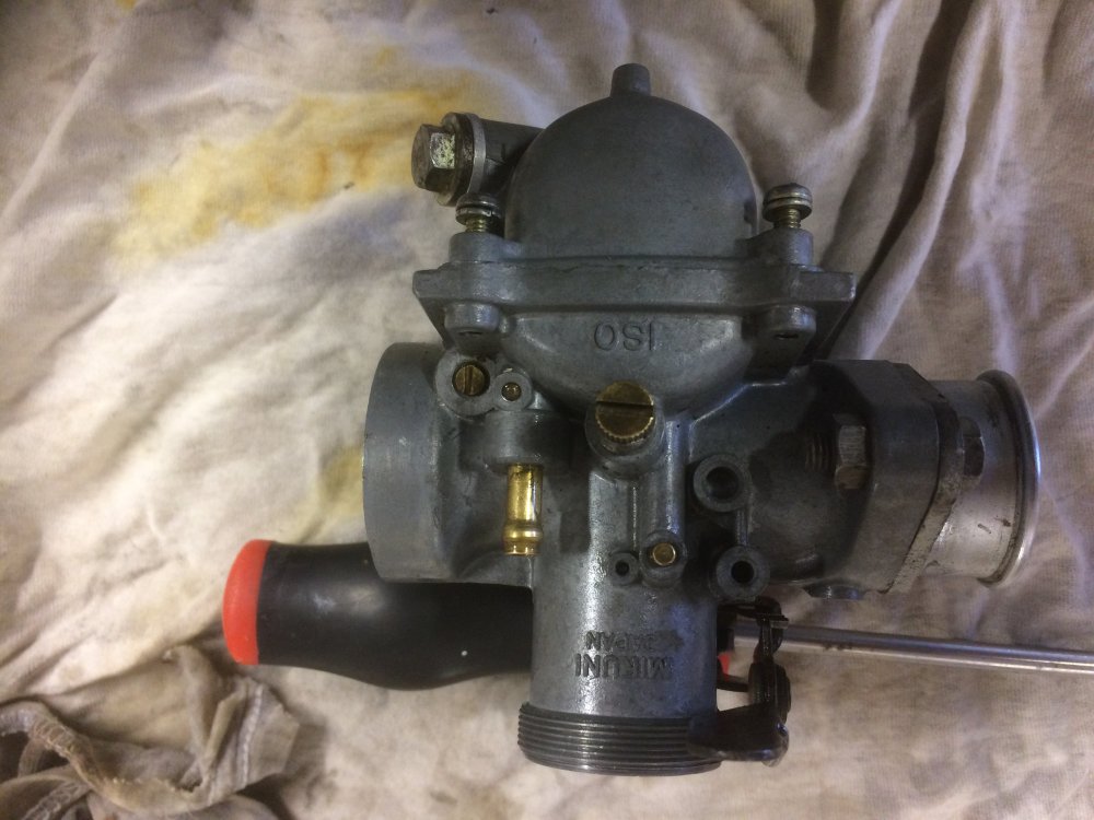

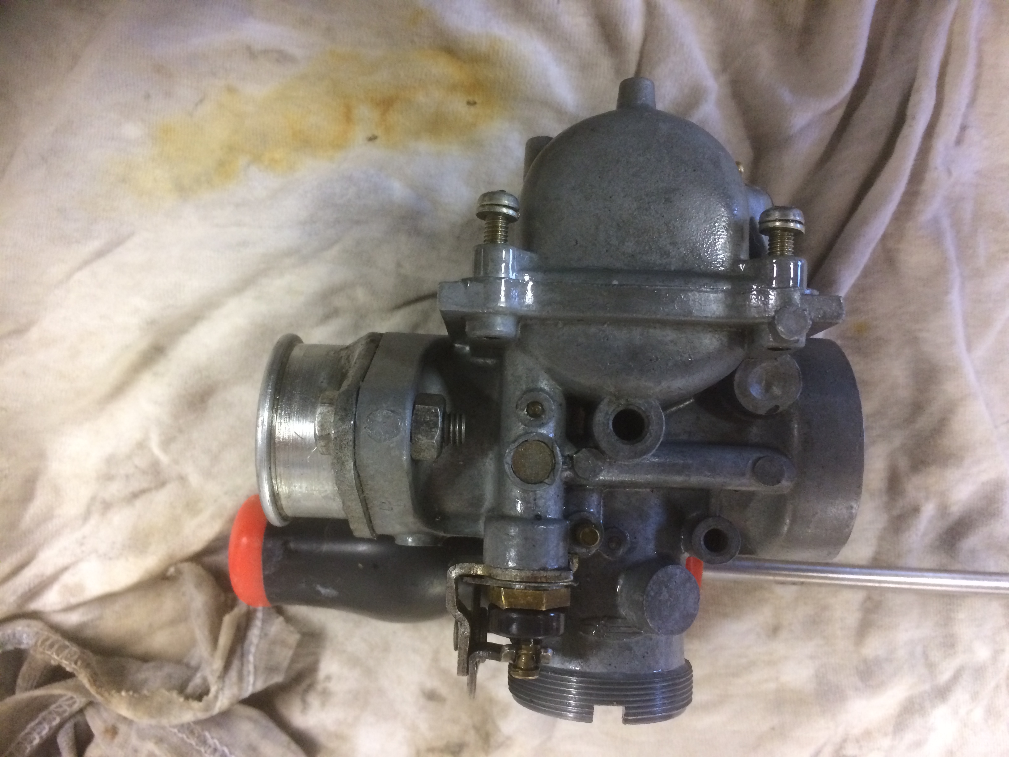

No idea fourex, all that's on the carb is mikuni Japan and ISO. Then on the bit where the manifold bolts on is T77. On the top is MIC. Is there anywhere else to look?
At least we now know it is a flange mount Mikuni, which narrows the field a lot. Most Mikunis are spigot mount. A photo showing both sides would make it easier. To measure the "size" of a carby you measure the venturi diameter, which requires taking it off the bike

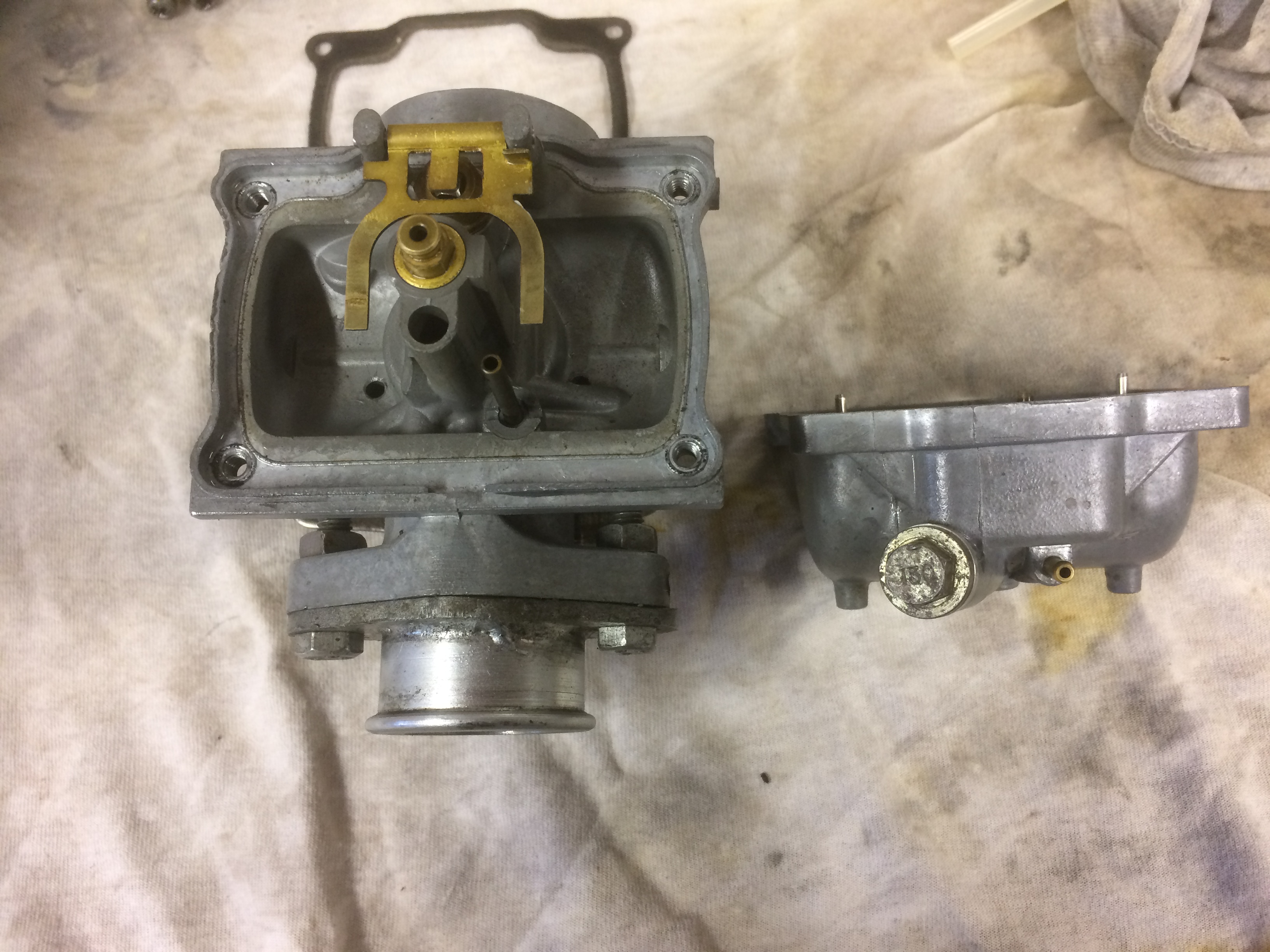

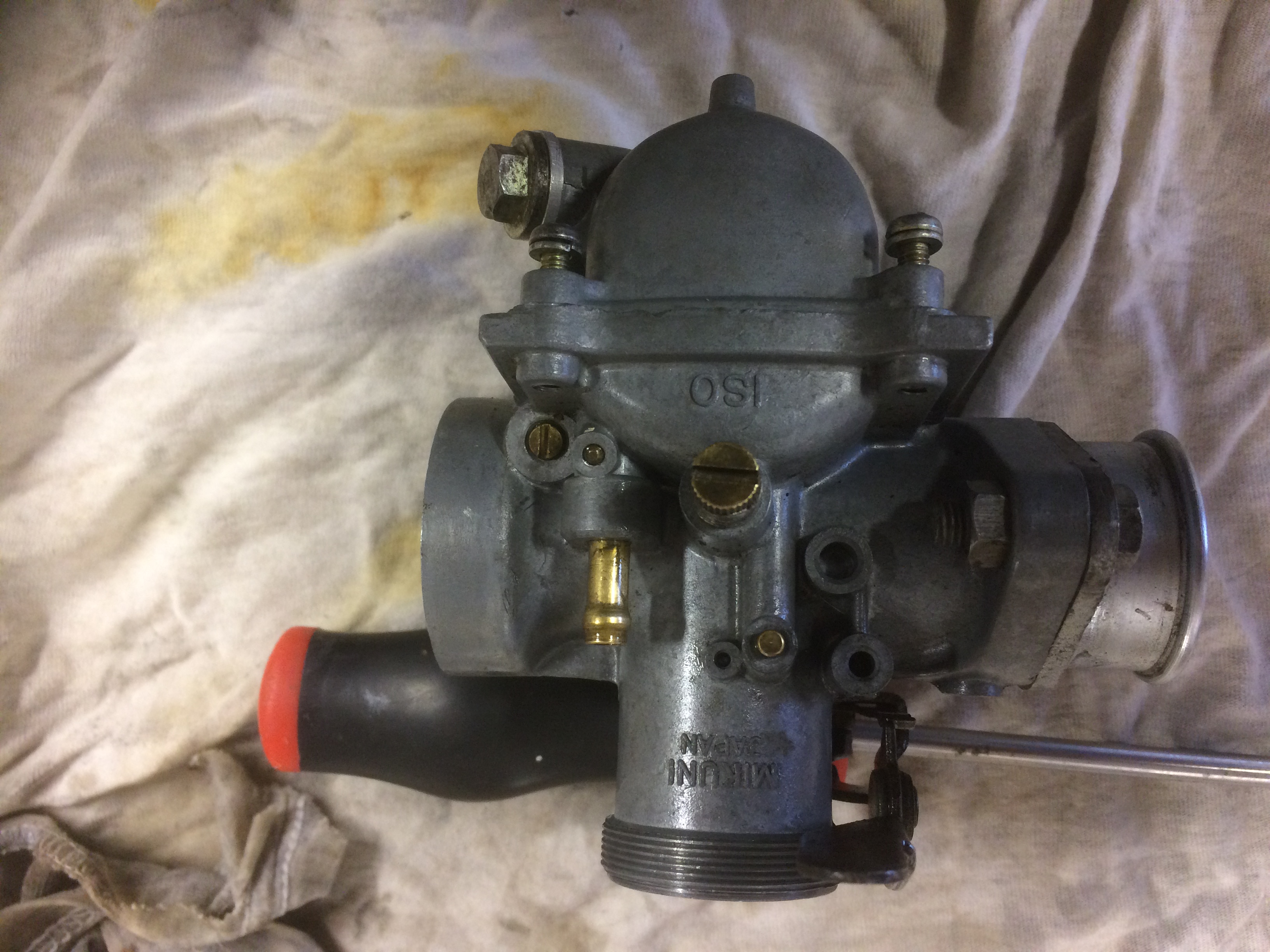

Right, eventually found time to take off the carb....it measures 27mm!! There's a 3.0 stamped on the needle slide. Hopefully I've managed to add a few pictures. The only thing that I can find wrong is that the o ring which seals in the float chamber is perished. Also now that the tank is fitted the carb leaks! I've cleaned the float needle and housing so hopefully it's sorted. I'm still unsure where to adjust the mixture, is it the small screw to the right of the idle screw?
