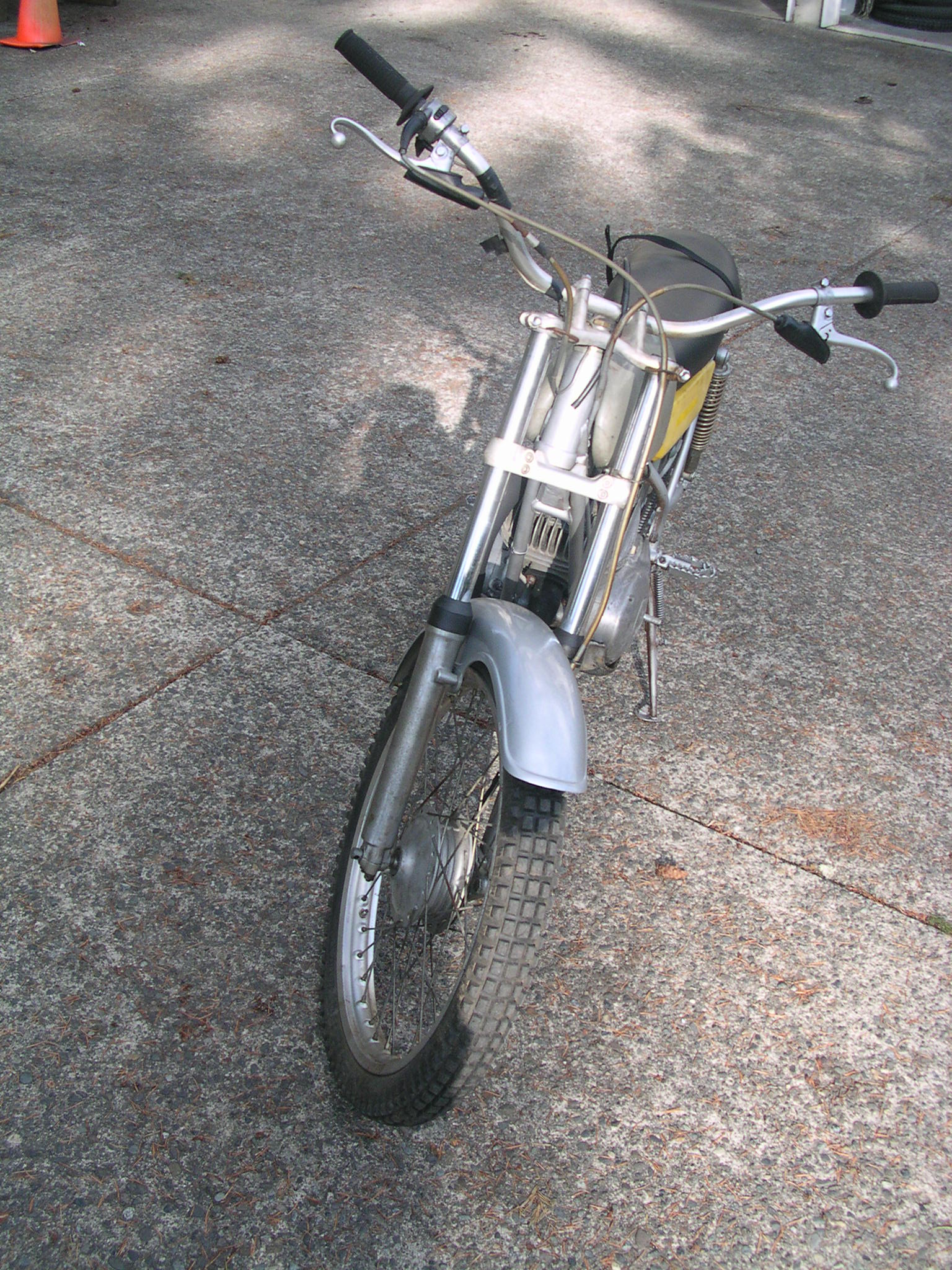

I had the same problem with my TY250A.  Did all the things as above with the same result you had.  I finally tracked it down to the lever actually bottoming against the throttle tube and grip.  With the lever removed from the bike and in a vice, I heated up and bent the lever to be farther from the bar.  I got a little extreme because I wanted to be able to use 2 fingers on the brake and have have the lever come out before the other 2 fingers.   It looks strange but works great.  On any surface, other than paved, I can lock the front wheel.
