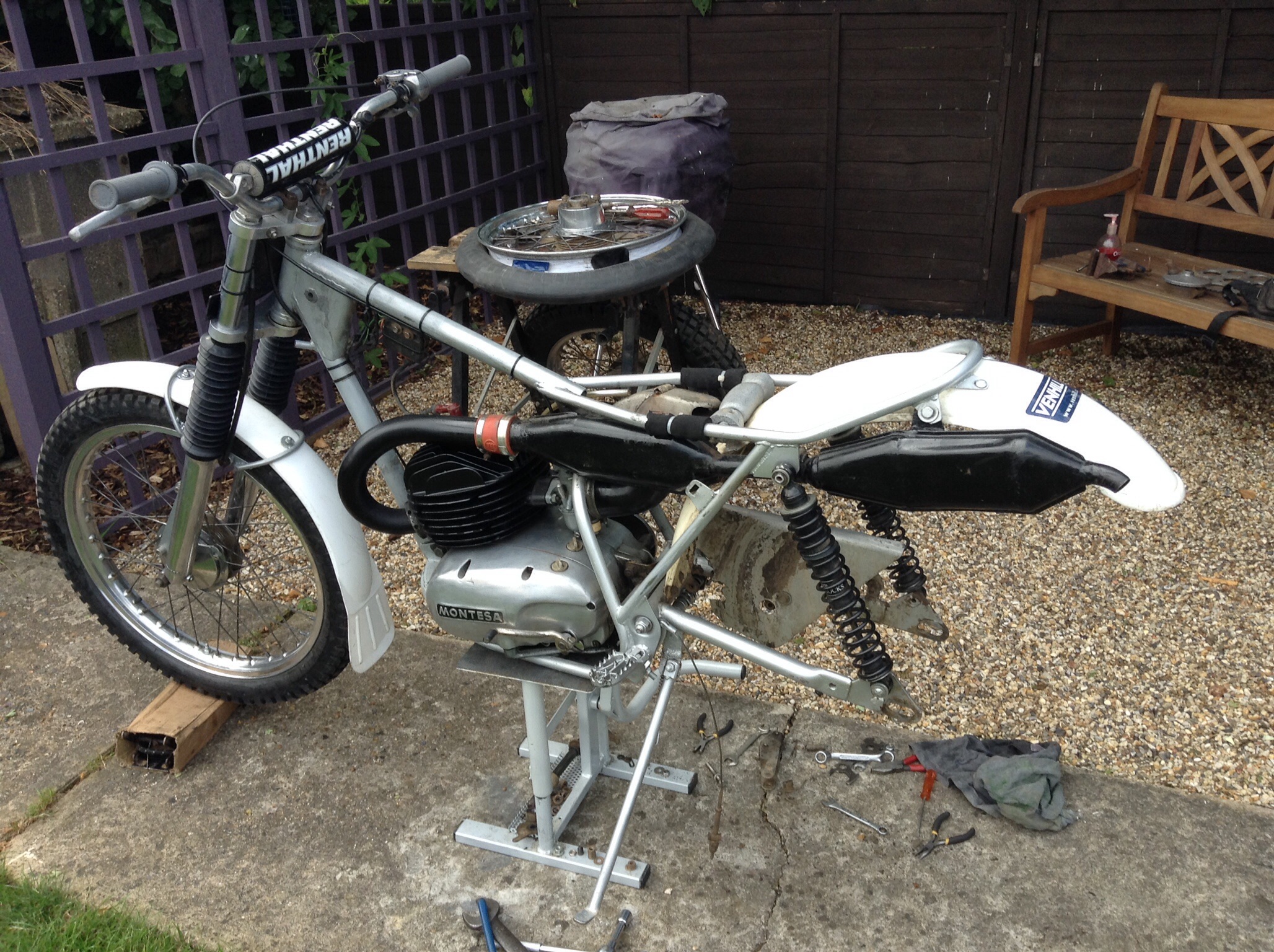

This photo shows a 21M17--- frame with swing arm , standard size.
You could lengthen by manufacturing copies of the rear spindle location plates with longer length from where it looks like the flat plate is welded into the tubular arm.
I would agree with other opinions though, that lengthening wheelbase would be detrimental to handling
