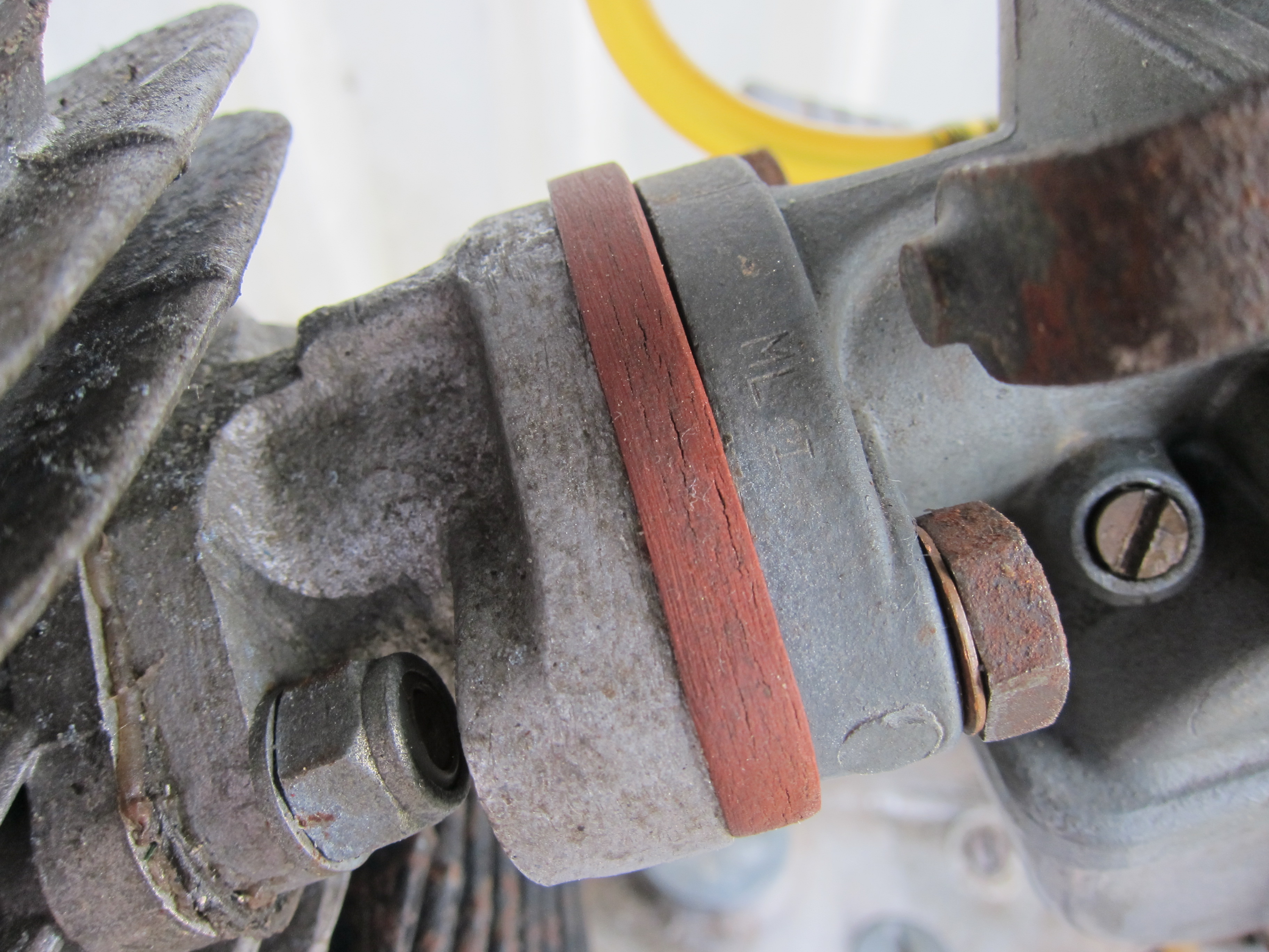

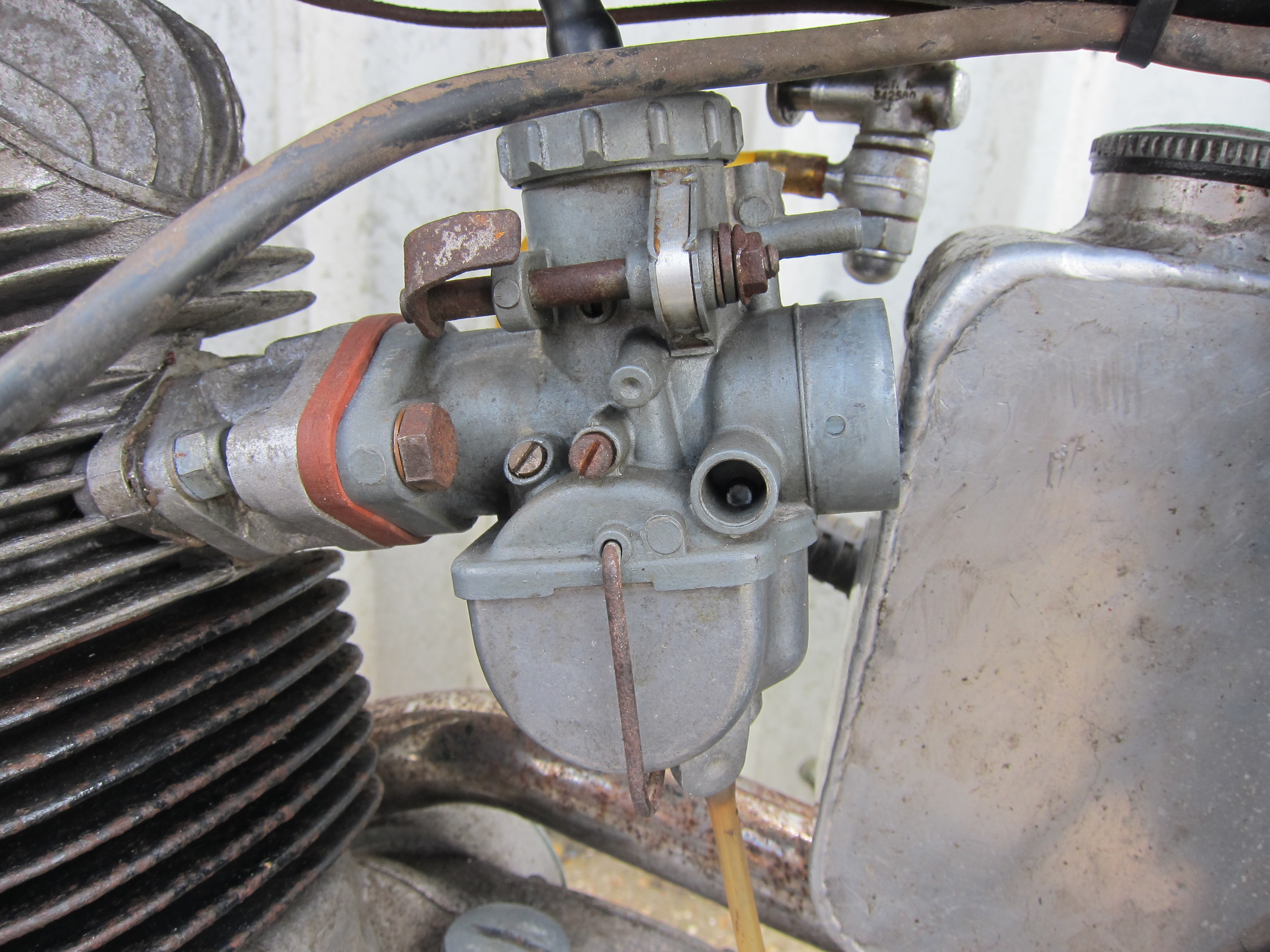

June 12, 20179 yr This is the carb that came on my cub, I am pretty sure it's the same carb you're talking about. Hopefully these shots help.
June 12, 20179 yr Author Thanks Samwise, I've got the thing on and running. It starts well but no tickover yet. Haven't tried it under load yet either.
