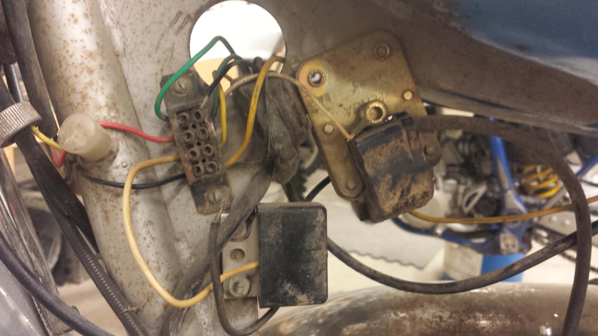

I've lost spark, model 85 250 alpina.  not sure if whats there is original as a brake light was added long ago.  mostly want to know how/where to test each component before buying new coil, etc.
been running fine then just quit like out of fuel.  added fuel (knew it was low) but would not start.  cleaned the carb, etc but still nothing.  then started and ran for few seconds then dead again.  that's when I checked for spark and saw none.
the two loose black wires (heavier one from the high tension coil, other from wire harness) were connected to terminal opposite the red wire.

This sounds like the grounding problem that the Alpina lighting system is known for. The stock Alpina's have the green (ground) wire from the engine grounded through the rear brake light bulb so if the bulb goes out, the engine stops (the engine looses it's ground).
To get it running make sure the black wire from the engine is connected to the black wire on the coil and connect the green wire from the engine to the coil ground (i.e. the bolt that holds the coil to the frame) and see if you get spark.

yes, the white wire (w/ ring terminal) is ground, or earth.  it was attached to the ht coil mounting bolt.  based on comments about the tail light bulb (ground going through it), I assume that this wire is not original.
Connect the white wire lug back to the coil bolt and connect the green wire to it. Try it and see if you have a spark. If no spark - it looks like the red wire is probably connected to the kill switch (seems to be hooked to the black wire from the engine to the coil) - unhook the red wire leaving the black wires connected and try it again - I once had the kill switch malfunction that gave me the same problem. If these don't work, next would be as pointed out above, plug, points, coil.

so I got it running again.  "start with the basics", they always say.  I re-attached the black wires at the terminal block- one from the ht coil and the other from..?  anyway, I cut the insulation back a little and made sure I got them both in the terminal all the way, etc.  ultimately I think what fixed it was the spark plug terminal, though.  the boot is disintegrated and WAS taped but that had failed.  I taped it good and tight and ta-da! spark!
