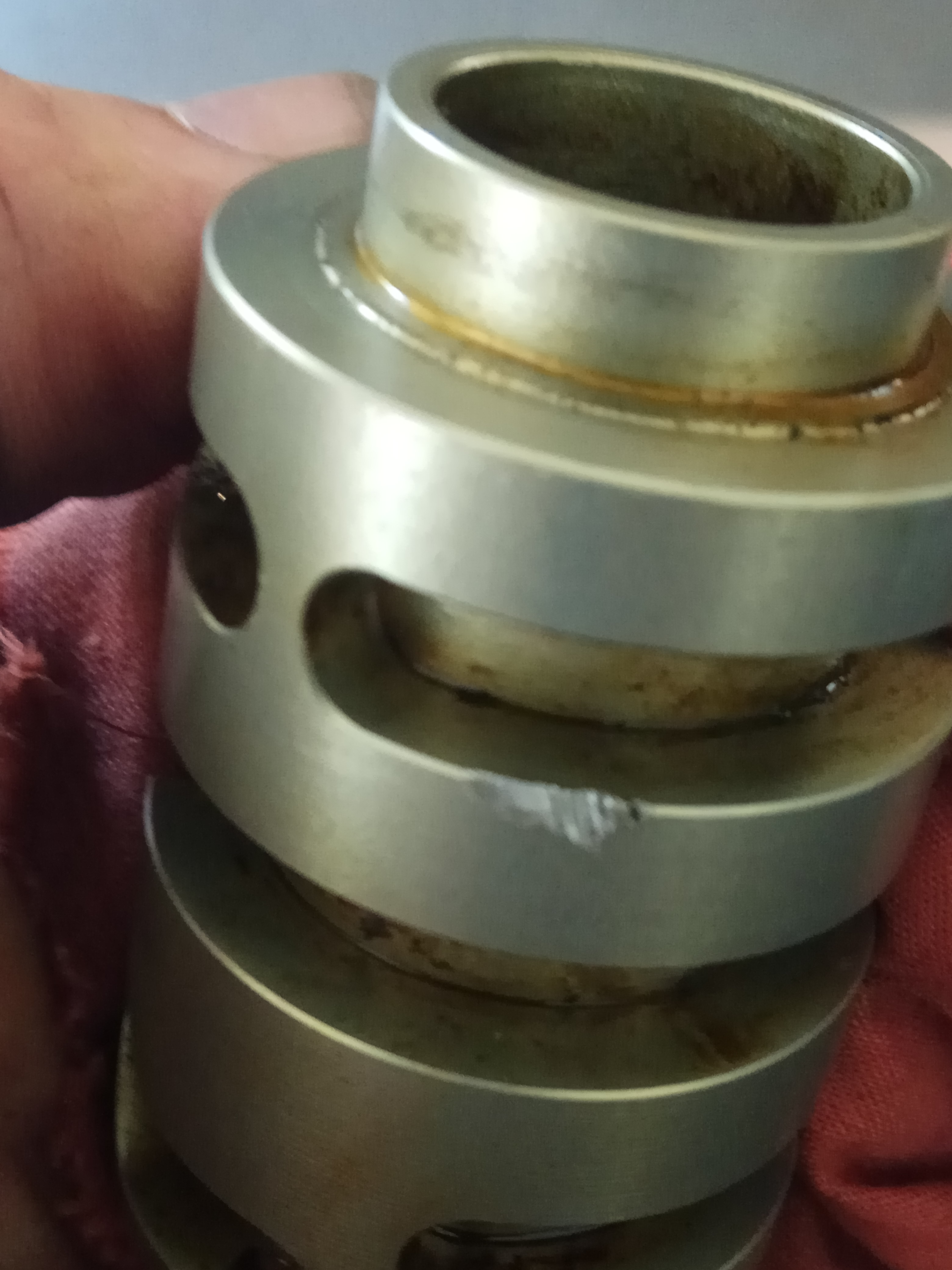

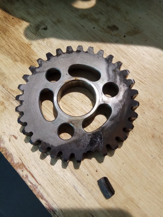

September 27, 20179 yr Author Finally got around to splitting the engine. Found the problen straight away. 1 tooth had come off one of the gears and was lodged in the slot on the selector barrel.
September 28, 20179 yr Ouch. Lucky the tooth didn't get into any of the other gears, would have made a major mess
September 30, 20179 yr WoW, now that is something new reported! In the last 17 years, I have only heard of one other broken gear tooth on a Sherco, yet nothing is impossible!
