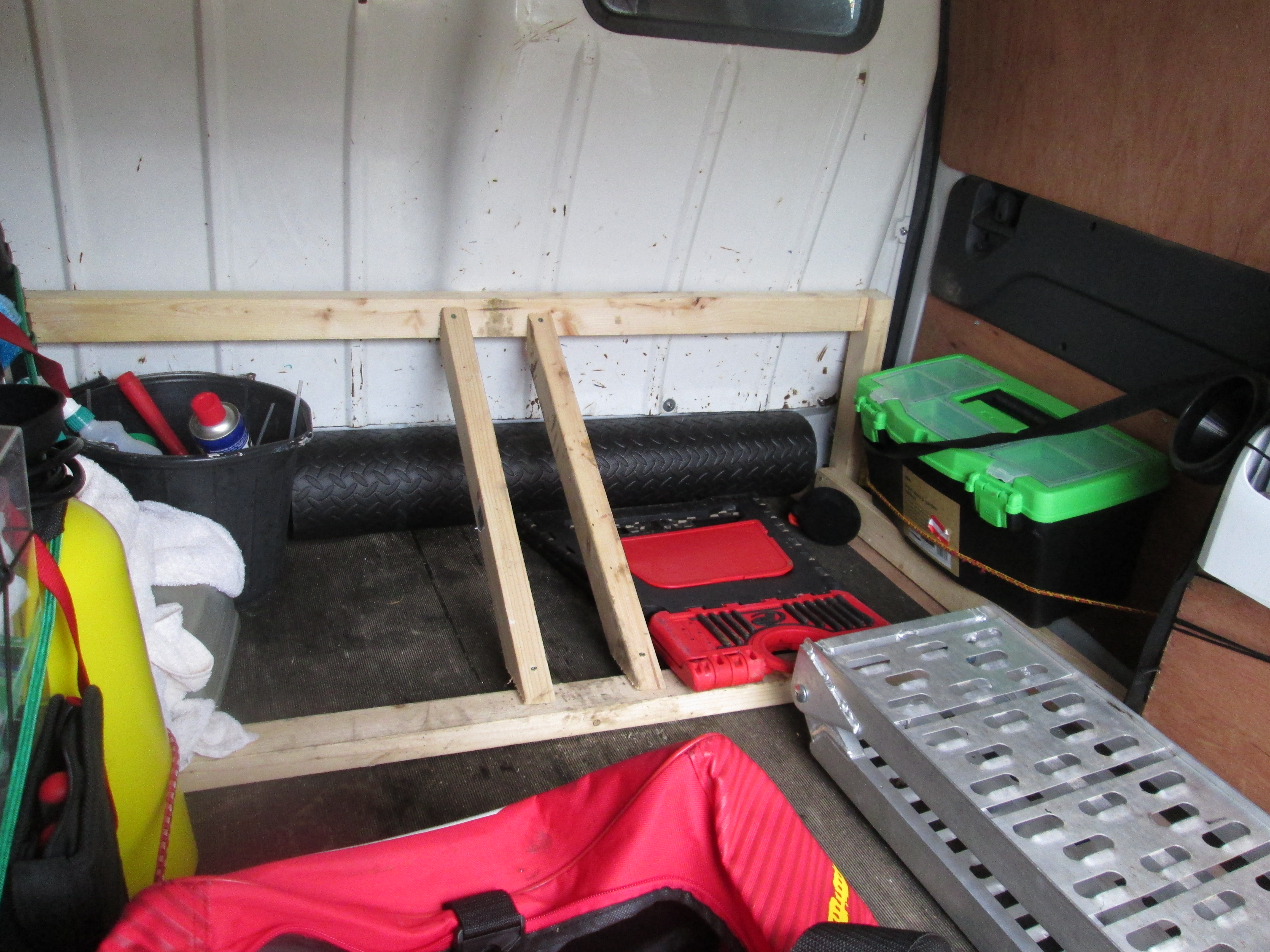

Hi - i used to jam front wheel in corner where bulkhead/van side meet and then use tie downs, but having bars at that angle meant I had to rotate clutch lever round and ended up with fluid level low and hence no clutch at one trial. So I knocked up this little frame from wood I had lying about - it jams between bulkhead and wheel arch to help fix its position.
Looking about, I saw several others using chocks etc. as above, but my frame holds bike upright via front wheel without any straps making it easier to then strap down.
