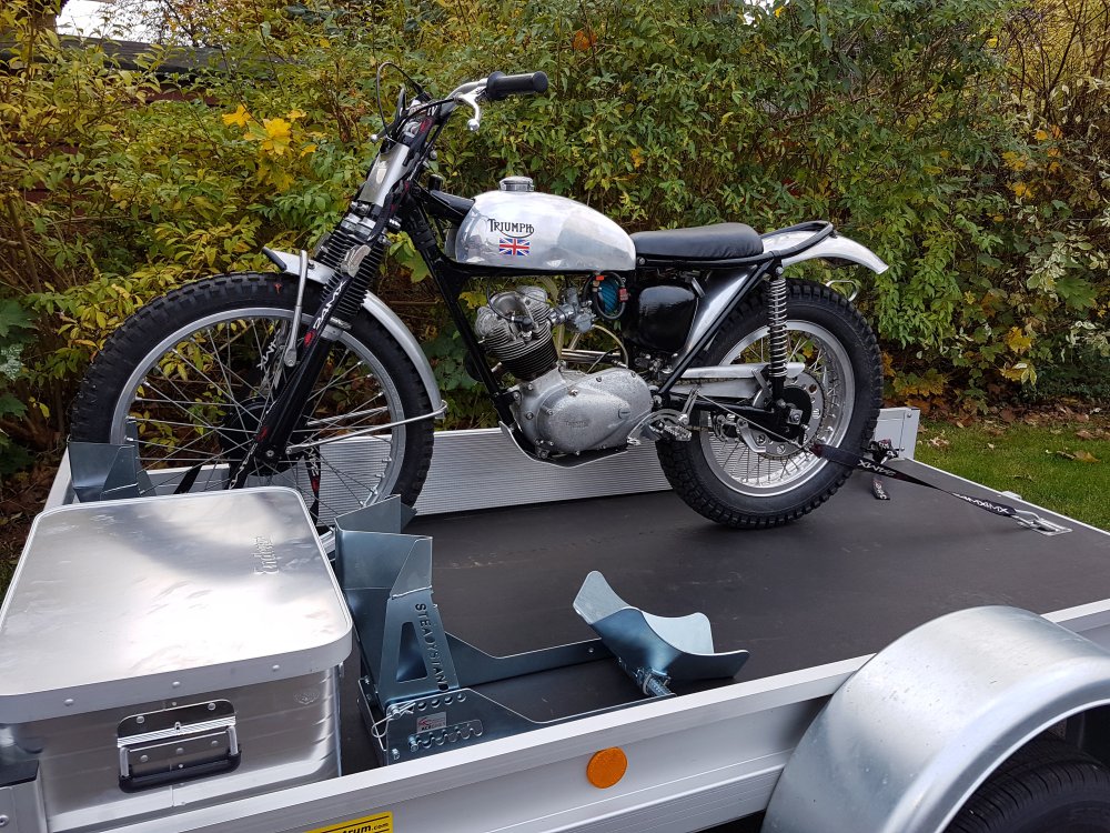

Bought a T20 cub, want to optimise it, but it should still be a pre 65, not a Twin shock with old engine....
What are youre experiences with the fork, oil, springs, modified interials ?
Rear shocks in which lenght ?

Nice Pre65 Mikuni carb there.
Nice looking bike :thumbup:
Nice trailer!
Nice ally box!
(got one just like it but covered in Hello Kitty stickers and dents :) )
Very funny guys here in this forum....
Mikuni was fitted by the previus owner, Trailer is a "Koch M4", alloy box from ebay, bike stand from steadystand.....

I normaly use NJB experts or Rockshocks on my trials bikes, perhaps the new NJB ultimates will be a good choice , lenght can be adjusted...
The forks are very soft, found nowere in the net harder or progressive springs, don't want to change the complete fork....

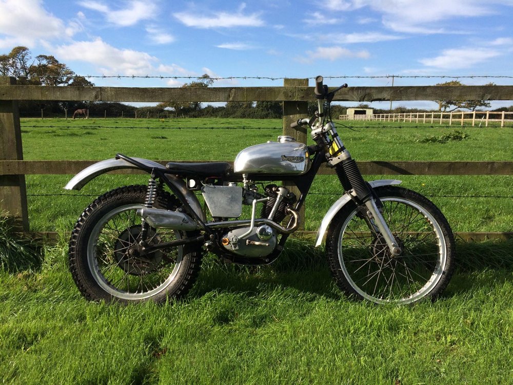

Cub is nearly finished now, I use NJB ultimate shocks, mount Miller swing arm, sub frame and seat, also new alloy mudguards, oil is now in the frame.
Exhaust made by  progressiveclassicproducts
