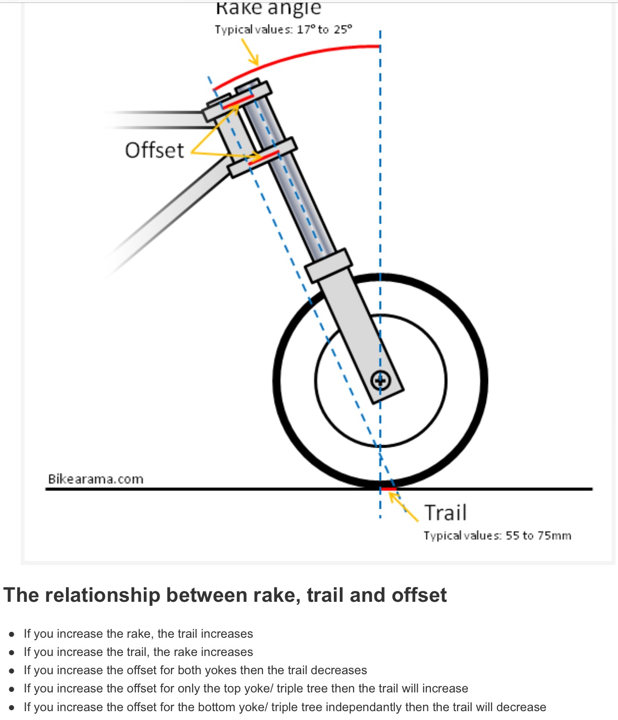

All you have done by fitting parallel yokes is increase the trail, so it takes more effort to turn now.
Unfortunately some so called experts (usually ones that manufacture parts) dont understand the basics of steering geometry. Making the forks looks steeper is assumed to be a good thing.  If it is acheived by merely altering the offset of one of the yokes it increases trail. ( Unless you increase the offset of both yokes to compensate - in which case you end up with tiller like steering and the mass of the forks and front wheel acting on a long lever around the steering head bearings).
 If it is done by altering the rake angle of the frame it decreases trail.
If you dont want to cut the frame the simplest options are to put longer shocks on the rear or drop the stanchions through the yokes.

That man Alan is a smart one, but here are some links with good information on the subject.
After reading these articles I decided to limit my overall efforts to the foot pegs. I couldn't convince my self cutting the frame would lead me to where I wanted to go. Many applaud the results. I just think I had more questions after reading a bit. I really like the first link.
http://www.trials.com.au/forum/viewtopic.php?f=16&t=9348&sid=0cfc5184470361131cd8c6386e8c65de
https://tonyfoale.com/Articles/RakeEx/RakeEx.htm
Have fun.
