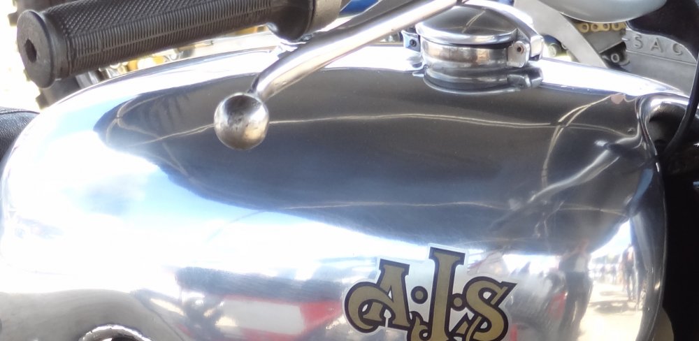

There is another way to do this, if you have basic metalworking skills and like the sound of your AC/DC TIG's HF arc. Once you get the hang of it, you can do one for yourself and then another for ...... and so on. Perhaps a bit of a long way to an affordable alloy tank, but very rewarding even before you have finished  your first one. Great therapy after a hectic day at work. :D

very impressive work. how to make tank pattern first from wood block . ?
A simple little question there. Unfortunately, the answer is .....not so simple. Please, have a look at the link below as it shows just about the same approach as I prefer, except for the welding, where I prefer my (modern) AC/DC TIG. No very special tools or other equipment, just practice and more practice and a little patience.
