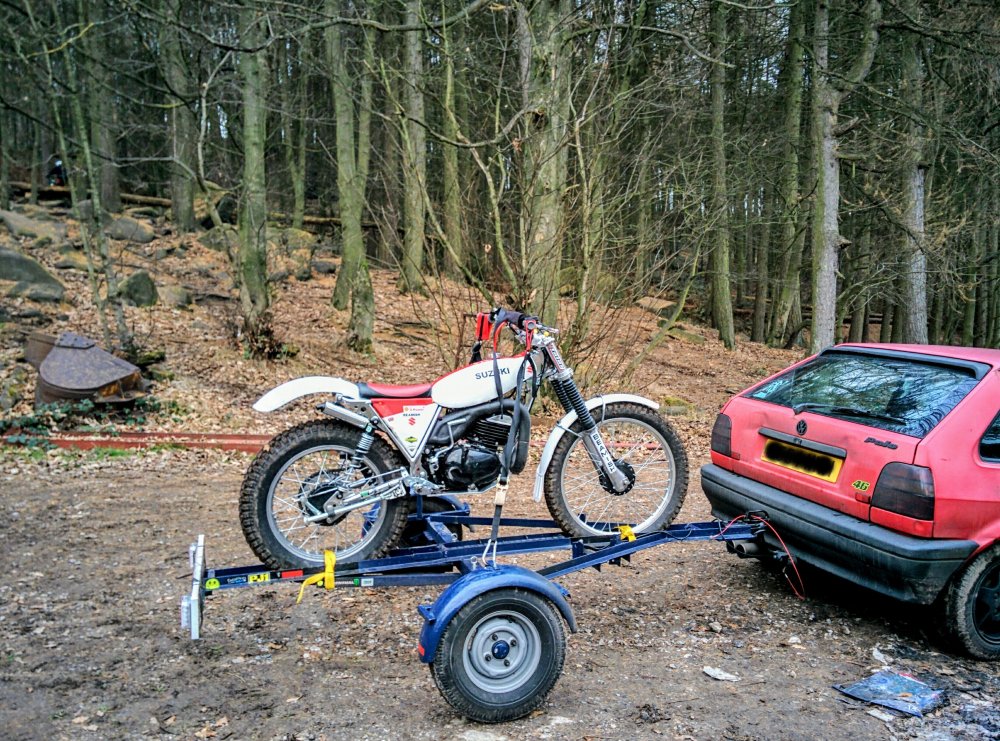

Mine doesn't move at all and I don't compress the suspension much if at all.

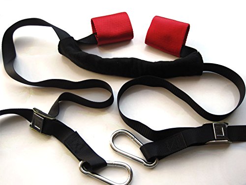

I put 1 on each side of the frame near the foot pegs(not on the pic) and then 1 of these on the bars
and just for my piece of mind the 2 around the wheels and the trailer.
The bike never moves
