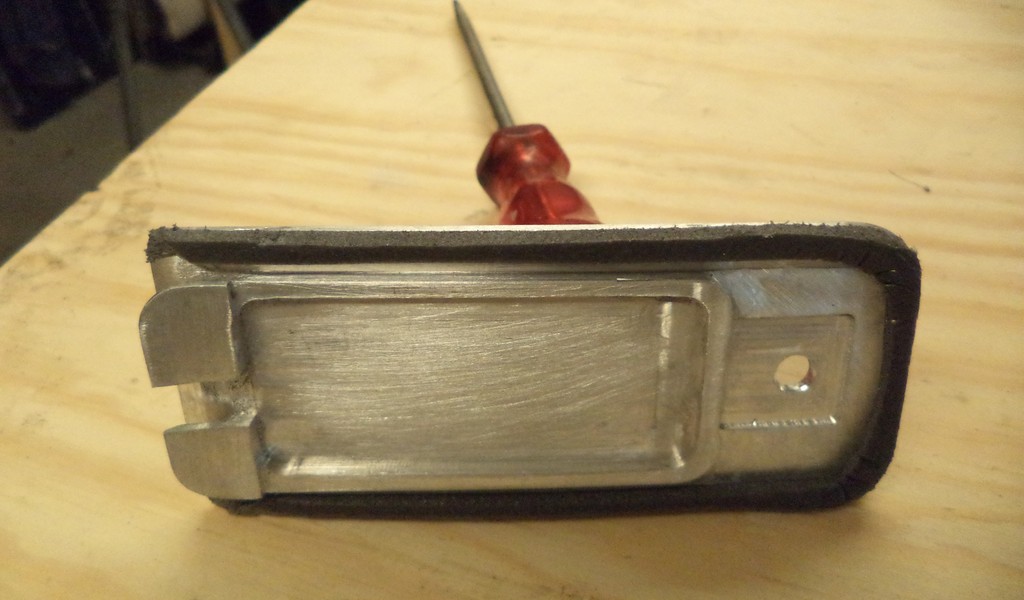

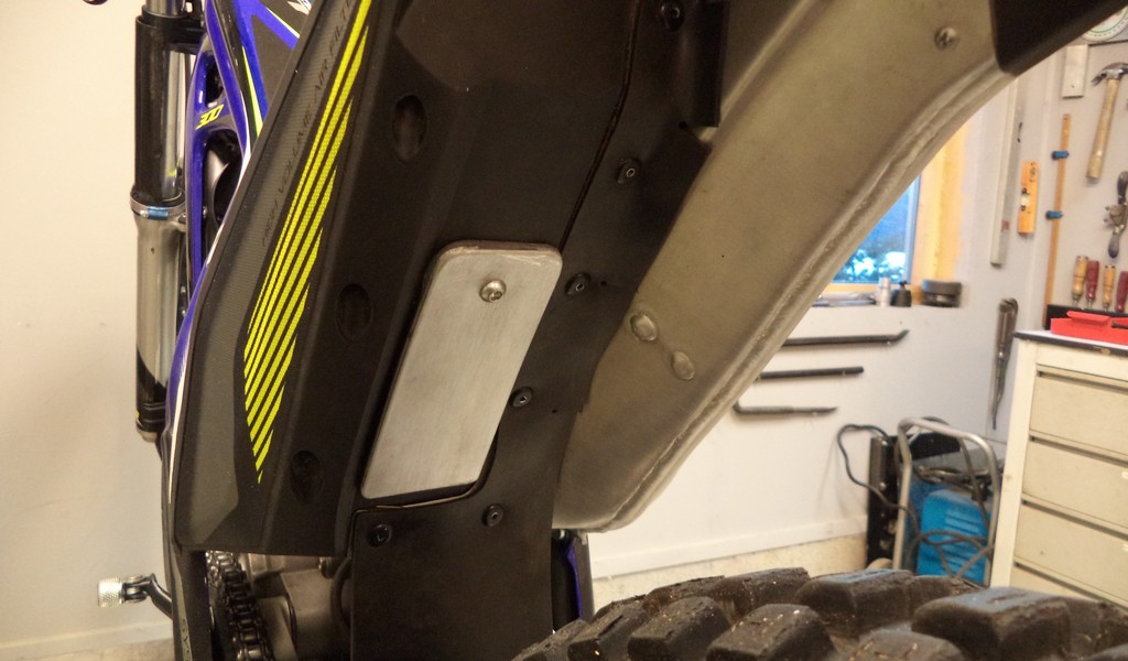

I have a girlfriend with small hands, that helps for sure. But besides that, I modified the backside of the airbox, so i can install the air filter from that side.  And replaced the bolt for a modified one with a butterfly nut.
The new opening is not big enough to install the filter from that side, but it helps a lot though.
