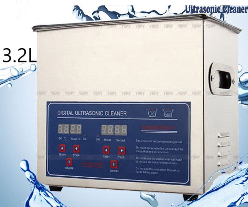

I use a sonic cleaner to make sure it's totally clean.
I picked this up off eBay, The 3.2 Ltr is big enough for a single carb to be fully submerged.
egr valve cleaner super strong stuff thanks anyway for your help

Yeah but didn't seem to work or you wouldn't still be having starting problems.
