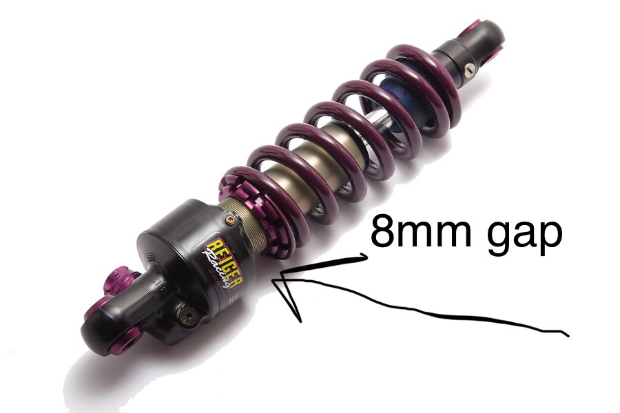

Its great you have found this out and made it easier to suss  , by starting adjustments from scratch or zero . But I still  dont understand the 8mm "pre - load" bit . And what about the forks , Or have I missed them bits  ?cheers . Just found forks bit  . But still 8mm preload on rear shock ?

The 8mm is the space between the shock spring collar/ring , if you look at the ring on the shock with the teeth , that gap should be 8mm between the ring and the shock, hope this helps , it’s also set at factory at 8mm , as regards the forks if you look at the top of the thread you’ll see the settings we’ve been discussing , hope this helps ???
Not as above.If for example the spring is 200mm long uncompressed,8 mm preload means turning the threaded rings clockwise till it measures 192mm

Niceone , got the 8mm bit now , thanks !?
