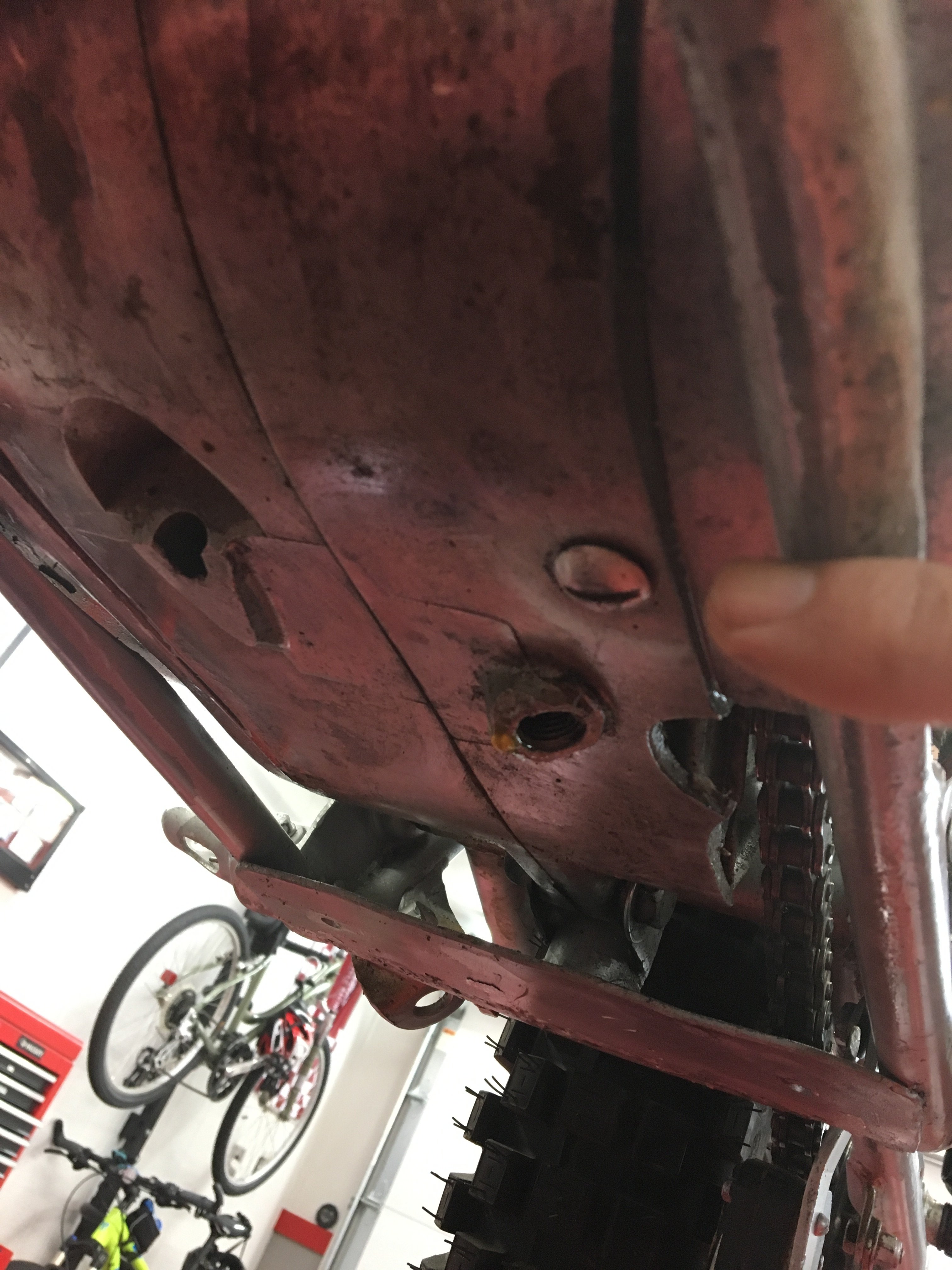

I removed two of the screws on the bottom of the clutch primary case and they were not drain screws.  There is a screw on the bottom of the left side case, underneath...is that what you are referring to...it’s about the size of a nickel and has a flat blade screwdriver slit in the head?
Here is what I can’t figure out what it is...the plug with the flat blade screwdriver head.

In your photo the original gearbox drain plug is the one behind the one you are pointing to, although I can't see that it has a drain bolt in it. The one you are pointing to is something that someone has added, maybe made their own gearbox drain if the original is damaged. I can't tell where exactly it's positioned but could also be a drain for the ignition should water get in there
The casting on the other side is for a speedo drive which is a hangover from older engines. Thyey weren't used on later bikes, It's blank and isn't drilled

Thanks guys.  The reason I couldn't find the primary drain plug is because it was apparently sheared off in this bike's past life.  The hole had been filled with what looks like epoxy.  I wound up using my brake bleeder vacuum pump to suck the fluid from the primary.  Not really happy to find a patched hole in the primary.
