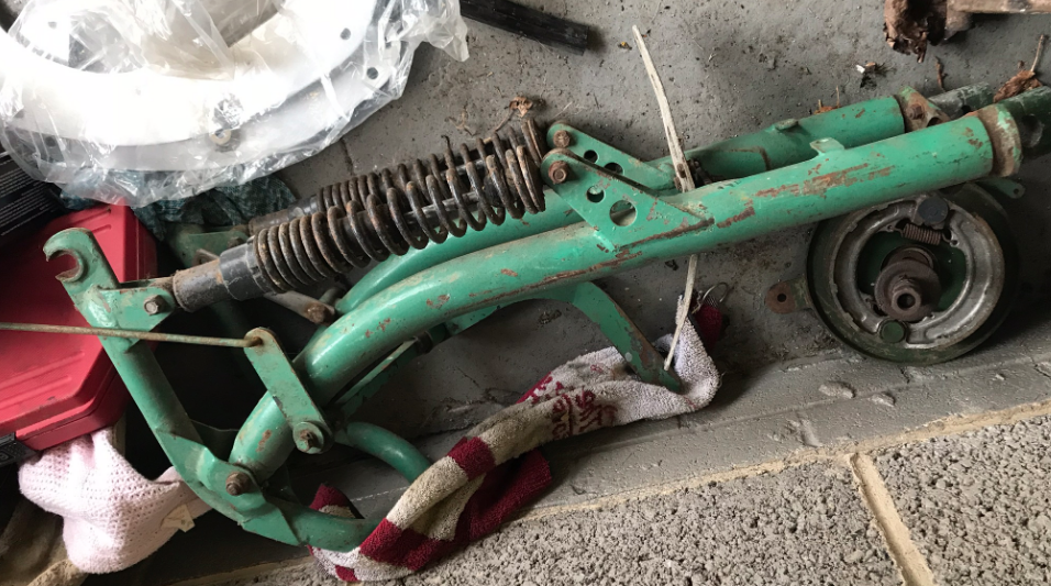

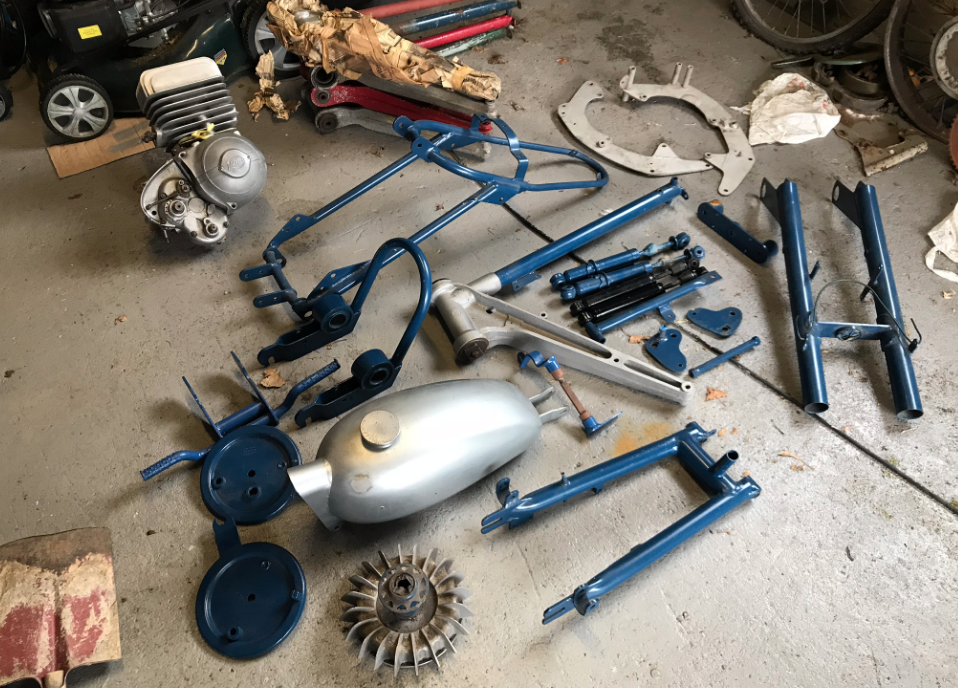

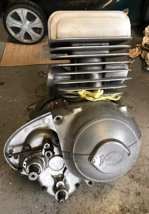

As promised - some pics... I've pulled together the one that is most obvious in terms of bits. The engine isn't the correct one for this frame... the right one is on my work bench, fully overhauled and ready to go...
The final pic is the banana forks off the scrambler... I could see the engine pictured in that!

At the risk of putting my head in a noose, that ignition cover doesn’t look very much like any I’ve seen on comp. Villiers engines. Looks as though it’s Bond car related, hence the extra lugs on the casing/cover.
The front fork (blue painted)judging by the silentbloc bushes are most likely of the mid 50’s early 60’s era.
The square barrel maybe a Parkinson and this type was also used on DOT’S, Butler, Cotton etc advertised in the bike papers quite extensively. You need to establish if it’s a Trials or Scrambles barrel, I could wrong but I’m sure a more knowledgable member will be along to put things straight.??
You are right, the engine has the dynastart ignition cover. My old man thought it might be nice in his dotage to have an electric start bike!
Is it just the cover, which can easily be changed, or does it have a dynastart crank ? If so it will need changing as not viable to modify them. Used to be able to pick them up for next to nowt because the crank and crankcases nobody wants them. Barrel and head got to be worth £300 all day.
Not sure, I will ask my dad.. I’m guessing the crank is dynasties as he wanted a push button bike!
