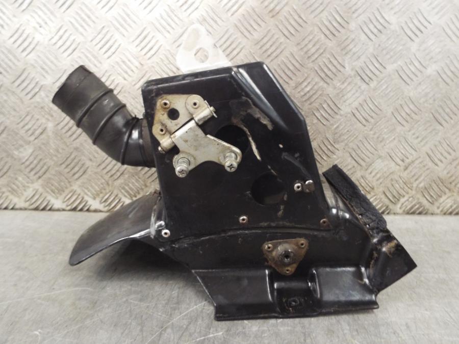

I don't really know which is the best option to go with. This is the airbox that came with the bike which has just been screwed to rear fender.
That's the correct airbox, if you had the correct lower guard it would have sealant between the airbox edges & the guard & small rivets holding it in place.
Unfortunately it looks like part of the airbox on the left side has been cut off, it normally comes partway along the side of the guard if that makes sense
This is what the airbox & inner guard should look like, see how there are some rivets at the back that go sideways
This is the listing for it, from what I can tell it would probably be cheaper than just buying a new inner guard & you already have the filter & lid. In their other listings is a used rear guard which also has free UK postage so you could sort it all in 1 go

Is the one in the picture in your post the same as this one from majesty, you just have to attach the airbox to it?
I have already just brought a new rear fender just need to sort the bottom out now
Same part but you may be missing part of the airbox were the rivets attach at the side
I have brought the whole unit from eBay,
got lots of parts now ready to go onto the frame
