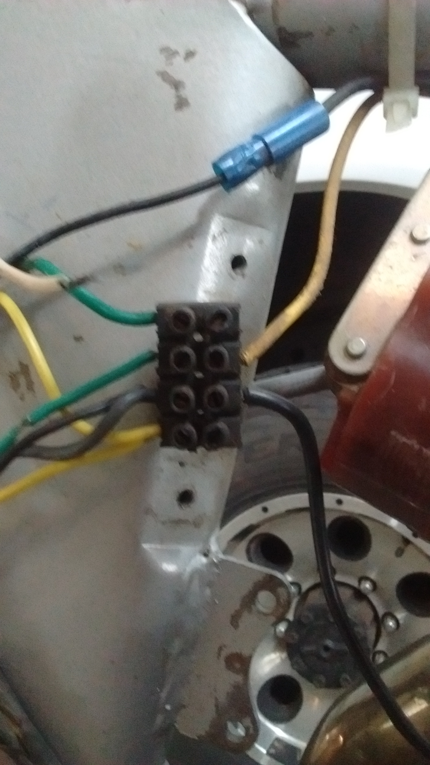

My first move was to clean and tighten the wires going to the wire connector block. The white wire going up to the headlight was loose. It looked like it was grounded to the screw holding the wire block in place. To narrow things down, I disconnected the green wire to the headlight, the yellow wire to the headlight, and the grey wire going to the kill switch. Then I cleaned the wire connector block.
At this point I got a lit test light on the green wire that goes to the motor. I also got a light on the black wire to the motor but only with it disconnected from the terminal block. When I connect the black wire from the motor to the block with the coil connected the test light doesn't go on. I couldn't get a light out of the yellow wire.

The test light is way brighter from the green and black wires. I am getting a faint light from the yellow wire. I know the black wire is the key to getting this running but I can only get the light when the coil wire is disconnected from the connection box. I read that the green wire is supposed to go to ground the coil nut. When I touched the green wire to ground and it sparked.

The yellow and red wires are for lighting only, suggest red to power horn and yellow for lights including stop light. As Stevem75 says green to a good earth and Black is ignition live coming from low tension coil in magneto and going to condenser and then travelling up to chocolate box connector near headstock, this then is connected to the low tension side of high tension coil under tank mounted to frame. It’s a popular modification to move the condenser from inside magneto to under frame near to ht coil as it is easier to get at if trouble happens.??

The green wire from the engine goes from the connector block and grounds out at a resistor near the air box. The ground tested good, but the green wire is getting power all the way from the motor, to connector box, and to the resistor. If its a ground wire should it have power?
When I test the black wire at the connector block with a test light, it doesn't have power when the coil wire is attached to the connector block. If I unplug the coil wire from the connector box the black wire from the engine will light up.

I think your original post said when you grounded the green you had spark.  Problem solved.  Yes the green does terminate at the resistor ground.  This is normal. It could also be grounded to the ignition coil bracket.  Both ways will work

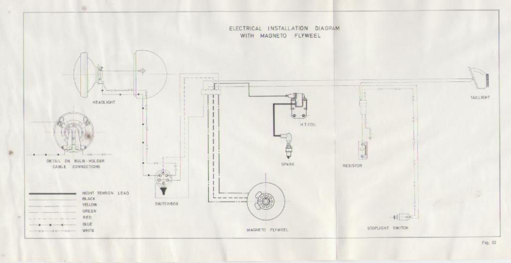

As your bike appears to be largely original spec. (surprisingly so, in fact) you may find this of interest :
Hope this helps.

That is a lot of good information. Thanks for the diagram.I looked a bit and couldn't find one that looked right. Most were in Spanish or German. haha.
In the first post I said the green wire was sparking when it was grounded. That was confusing, sorry. I meant that the green wire itself was sparking when I touched it to the frame. Not that the spark plug was sparking. Sorry for the confusion. I was surprised that a ground wire would have power running to it. I will remove it from the connector block and ground it directly to the frame at the coil.

 take a look around the internet at articles focusing on the theory and principles of whats happening in a points style ignition, I think u will find it a good read . my point is u can gain an understanding of the components of a typical system and once u see what each piece does and when and why u can apply that to getting your bike right . the key is to understand what happens in one cycle of the engine to create one single spark . then it all gets much clearer the goal of each connection and item. and I notice the terminal block on the bike I believe only connects across left to right not top to bottom, so your green wires are not connected together as currently configured.

Thank you guys so much for helping me with this. I really didn't know how a magneto ignition system worked before this. I have learned a lot. That wiring diagram looks like the right one. Thanks again.

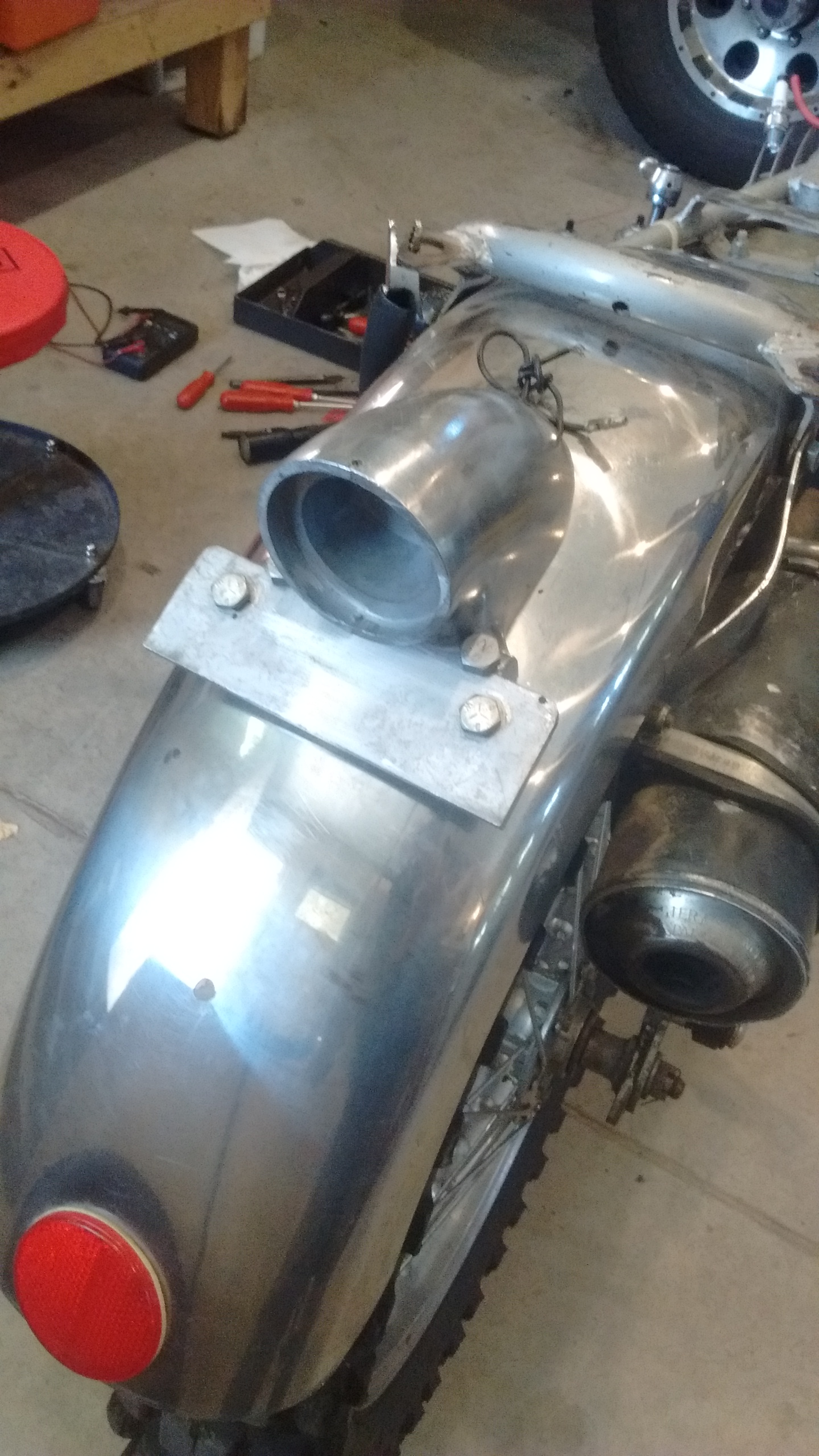

Is the brake light a stock item or was it aftermarket?  It is missing the lens so I may use a bit of red tape to start. Does anyone have a lens laying around their shop?
Great news what solved the issue when I might ask please.
If the rear light is original try:
Hughs Bultaco in USA,
Orlando Calonder in Switzerland, or
Hansjörg Pfahler in Germany,
for a spare lens, otherwise try in Spain:
Ivan Cirre cimes in my mind here.
