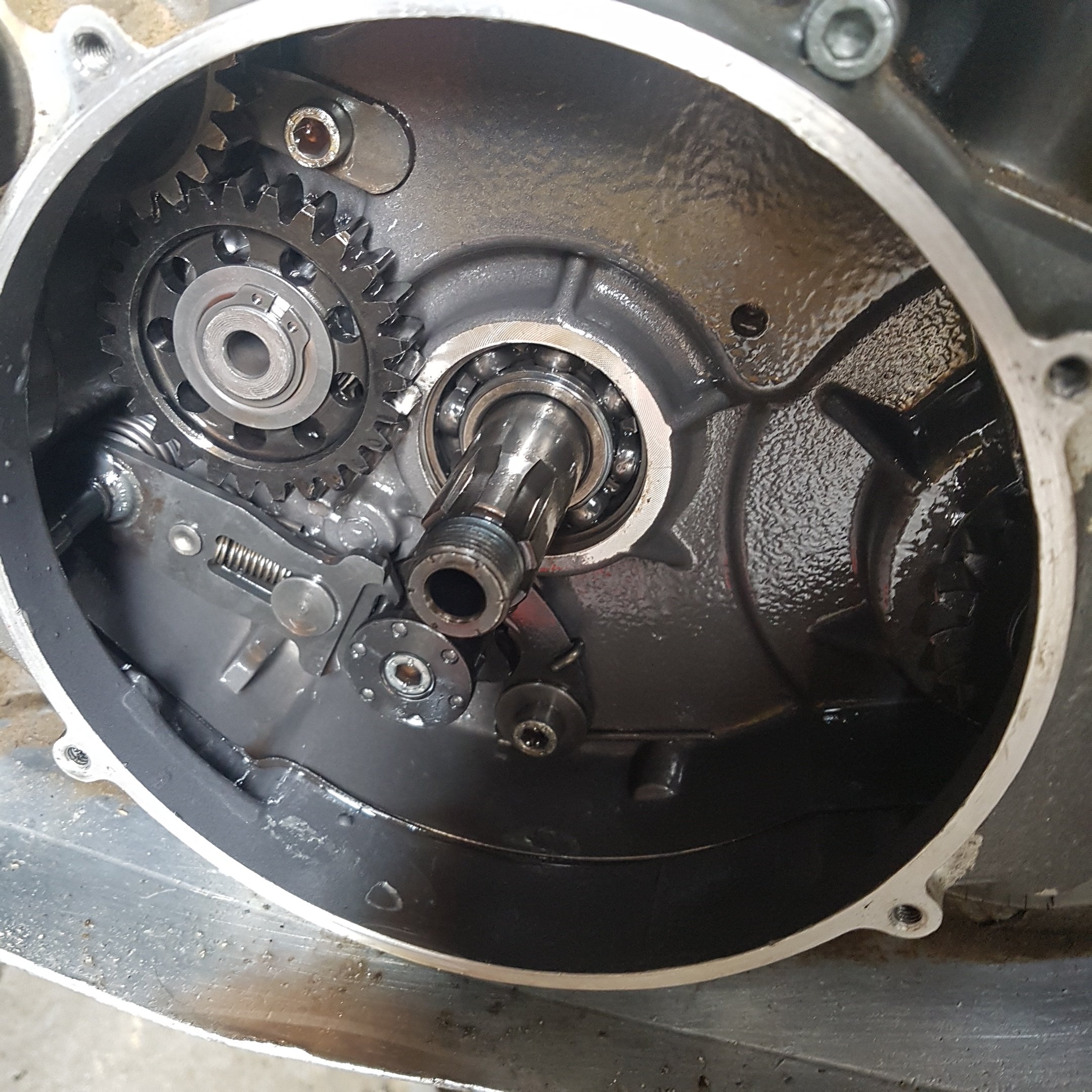

I wanted to replace the crank seal clutch side too, which I thought would be the same setup as the ignition side.
But there doesn't seem to be a seal there, I can see the main bearing. Which had a small thin bearing cover on it, until I pulled it off thinking it was the seal.?
So now I can see the main bearing cage and bearings. There doesn't seem to be enough depth for a seal in case. I can't believe the sealed bearing would be sealing the joint between the clutch oil and bottom end.... is it located on the inner side of the LHS case?
Thoughts??
Thanks
Something strange with your cases from the sound of it, should have the sealed main bearings by now like you describe & a viton crankseal between the bearing & primary drive gear
That's the gearbox mainshaft bearing, no seal needed there. Crankseal is behind the gear that the clutch case is covering on the right, water needs draining to remove the casing & if you pull the waterpump cover with the hose still connected it helps with getting the waterpump gear meshed correctly when reassembling. Probably a good idea to do the waterpump seals while the case is off & check the condition of the shaft at the same time
