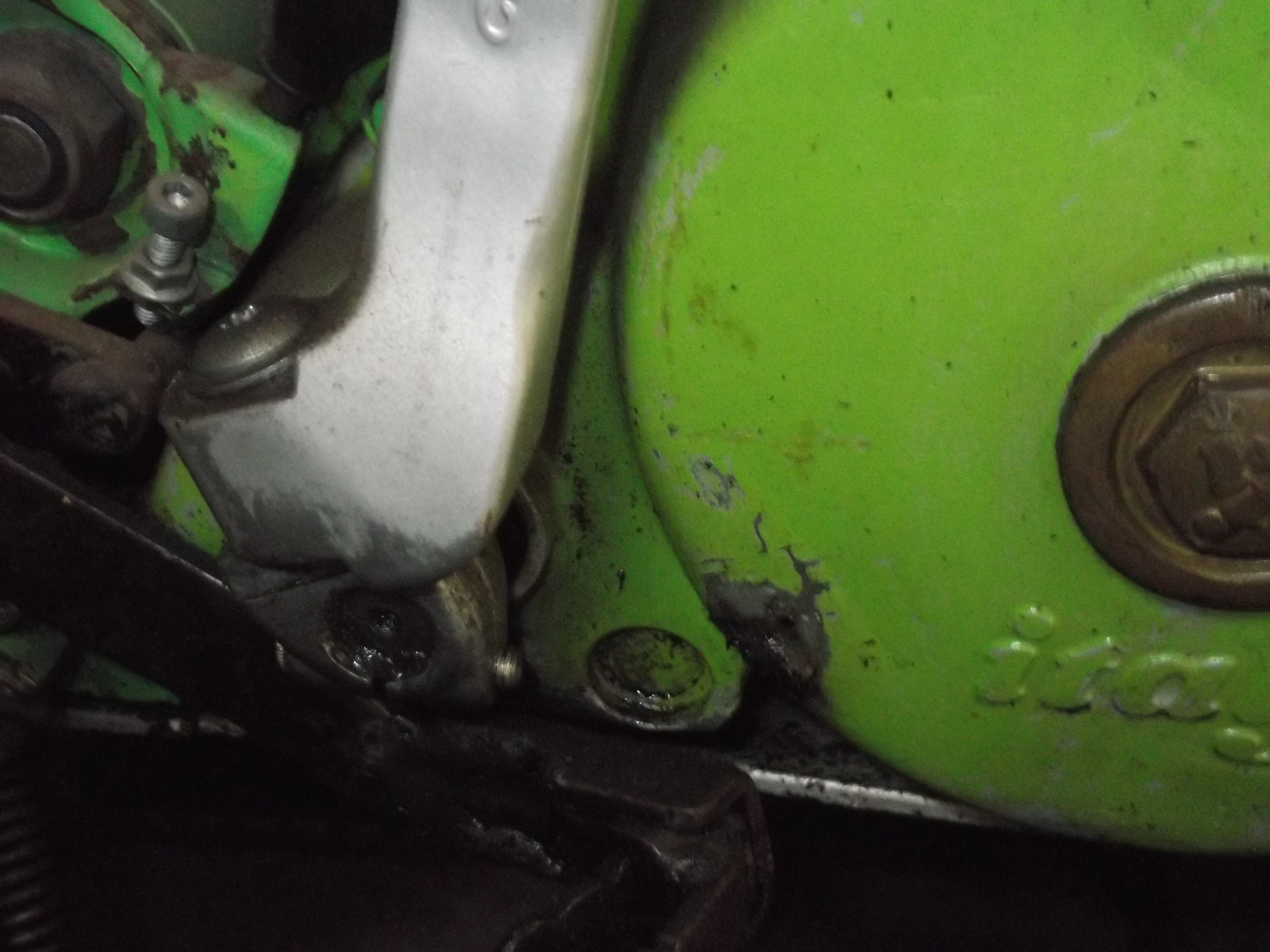

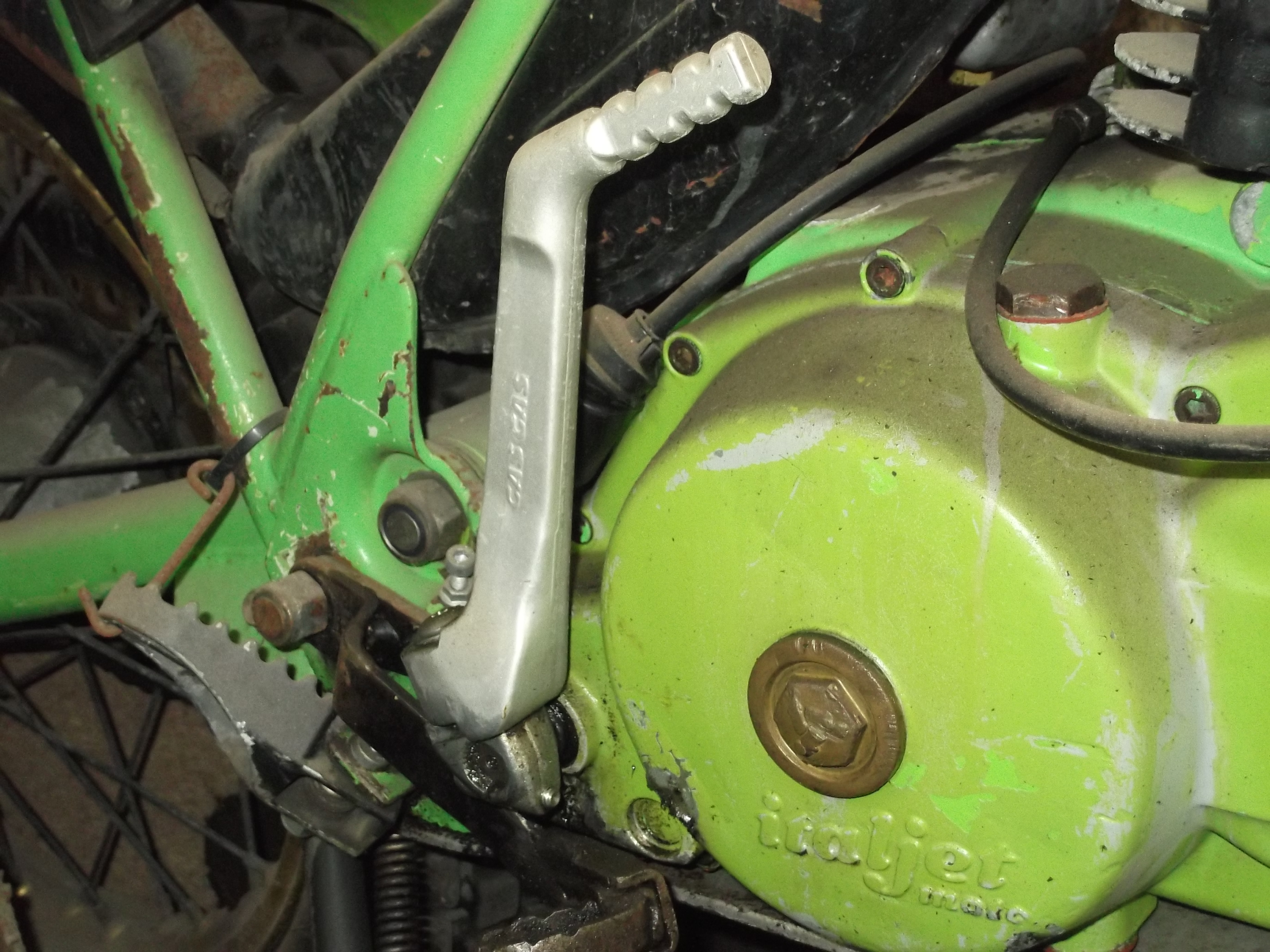

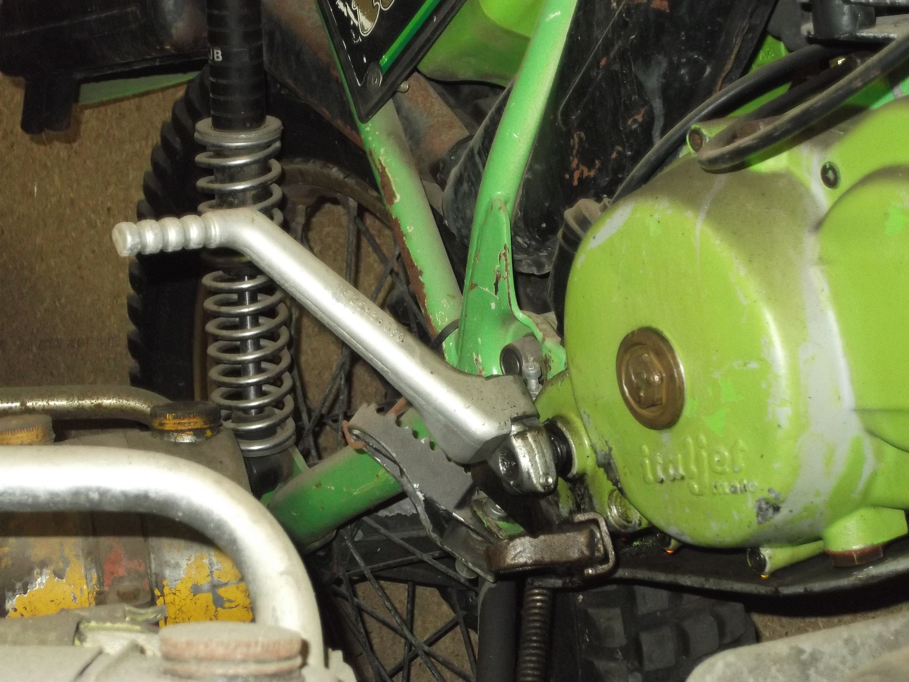

Hello Mark and Fourex. I have bought one from Steve Goode a few years ago but it was not for me and I can`t remember which Gas Gas it was from. I should be able to find out though. I can also take a photo of the kickstart which someone else might be able to identify which model it is from. Steve Goode would also know so maybe just contact him. Graham.

Mark, the kickstart is off a 1998/1999 Gas Gas. They are an all alloy one. Sorry I couldn`t get a bit closer to get good photos but the bike is up on a shelf thing with not much room around it.
