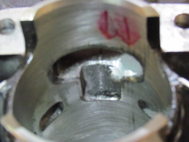

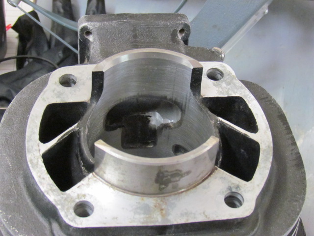

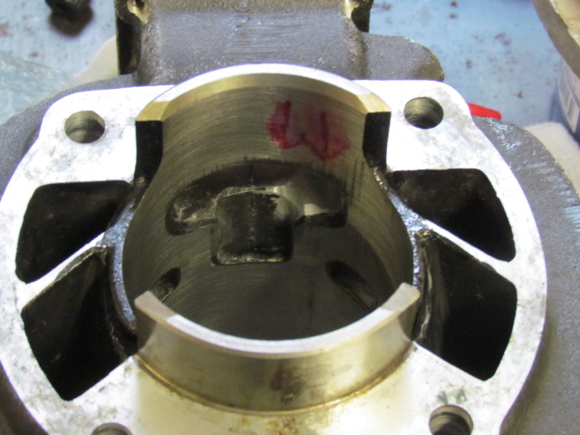

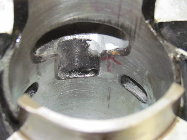

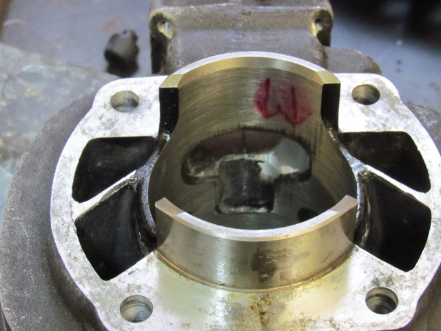

Well this old bike is still giving me surprises and while I'm waiting on the cylinder re-bore and new piston,  I thought I should look at how much crud was hiding in the tail pipe.  Not to be disappointed, the tail pipe decided to cough up a couple of peanut sized chunks of pure carbon.  So I know there is more in there somewhere.  took off the expansion chamber too of course and it was not as bad ( I think) but the engine (when it was together) would belch 2 stroke smoke from all angles when it first started up.  Could be that this carbon was what was causing the detonation during deceleration?  Something was definitely going on in the cylinder. (see pictures below)
And now the packing that resides in the tail pipe is completely soaked with dirty goo.  So I think the engine was not breathing properly when i ran it last.  I did not get a heads up from the previous owner or understand that this tail pipe cleanup was even needed.  Never had a TY before.  I'm running Amsoil Saber at about 40 to 1 which is probably too much oil.
So is this packing material really just fiberglass?
