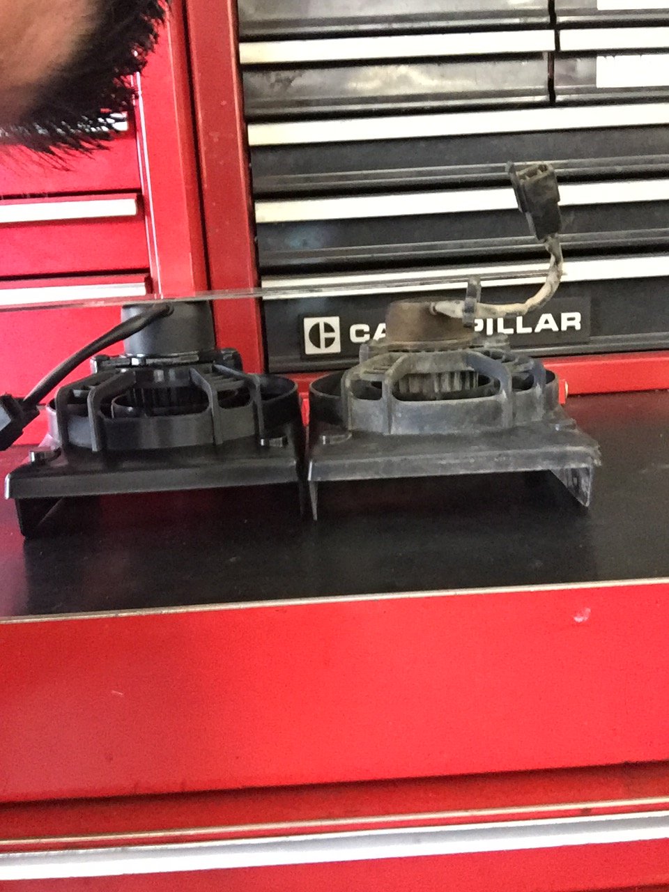

Hi, my fan started sqeeking so I bought a replacement from Adrian @ Lewisport here in Ca. What is the best way to remove the fan?
Fyi the fan is from Jitsie, fits 02-12 gasgas and jotagas 12-16

Well, it ended up being a very easy swap, the radiator and fan squeeze right up through the frame. Just had to figure out how to remove the fancy radiator hose clamps Ossa uses and it came right out. The replacement fan was ~5/16” taller at the motor but that was not an issue.
Good idea to replace if it started making noise.  If the fan fails it will overheat quite quickly.  And riding doesn’t help- since almost no air goes through without the fan.

Kim, as far as I can tell the fan is identical except for the slightly longer motor. Air flow and noise seem to be also the same.
