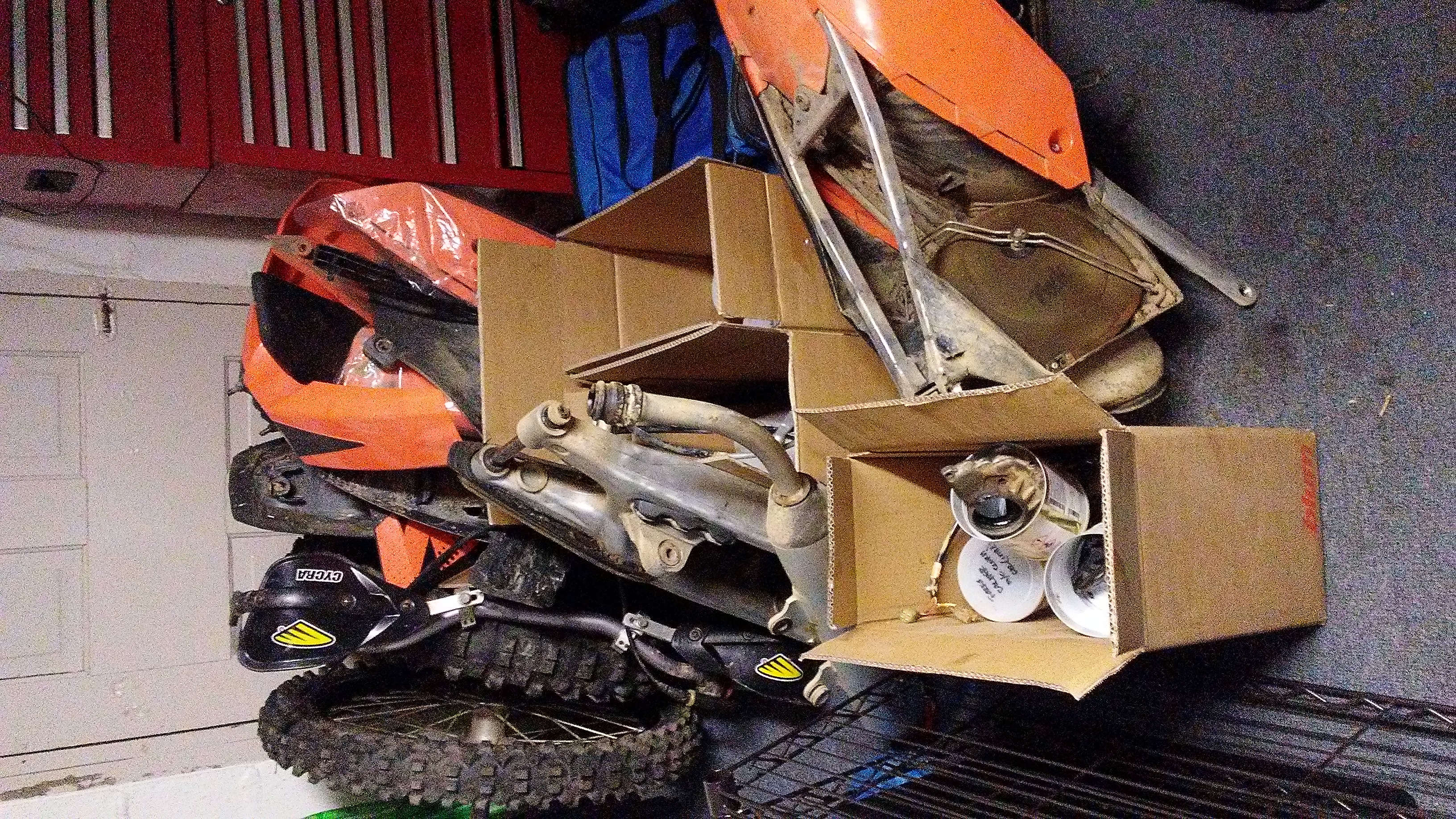

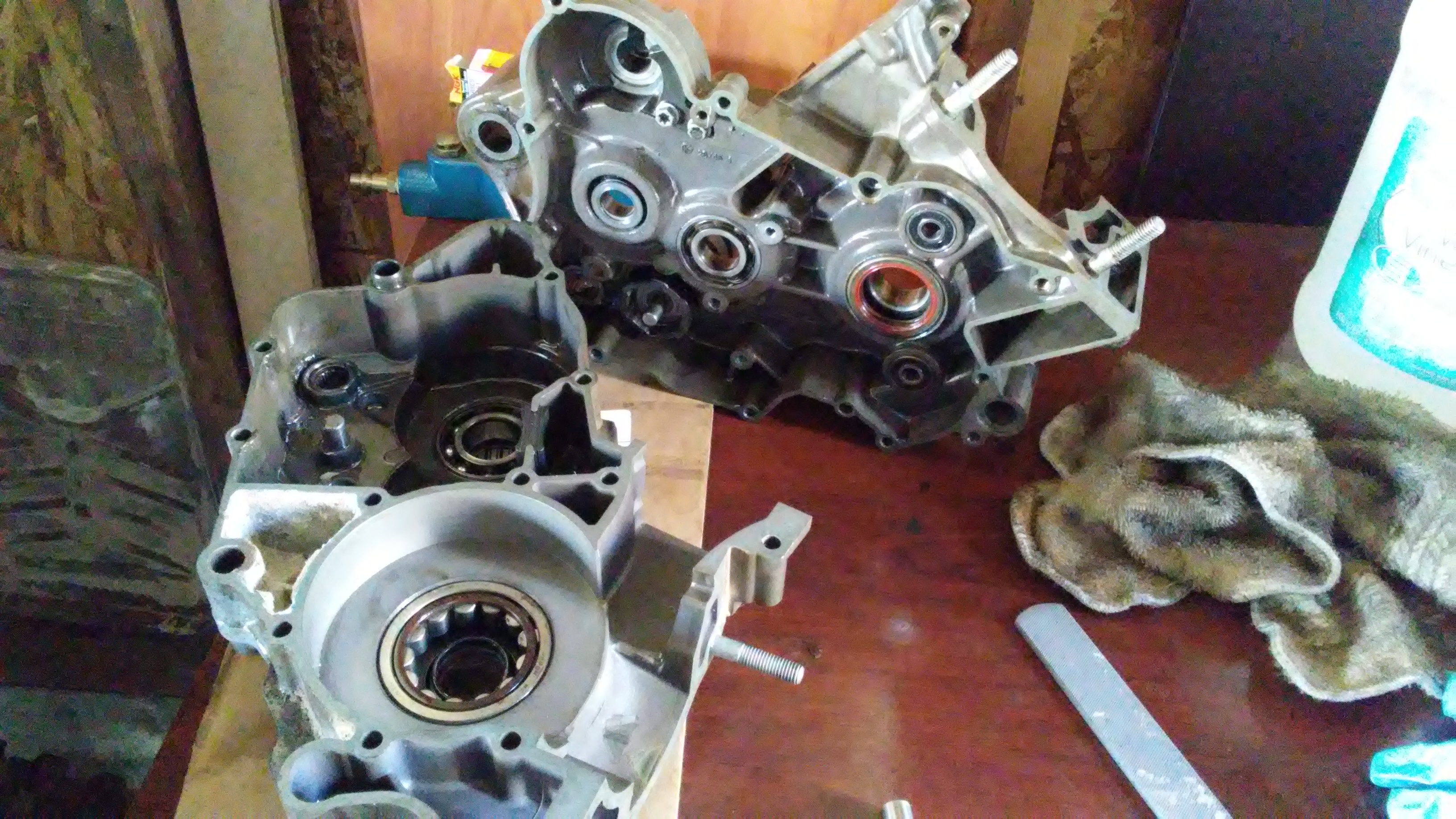

PS just a couple pics from the build (since you asked) :)
The first is from June, the second sometime in July, and the last is me and my boy in August. I'm jealous of his height even though he's only 13 there lol.
