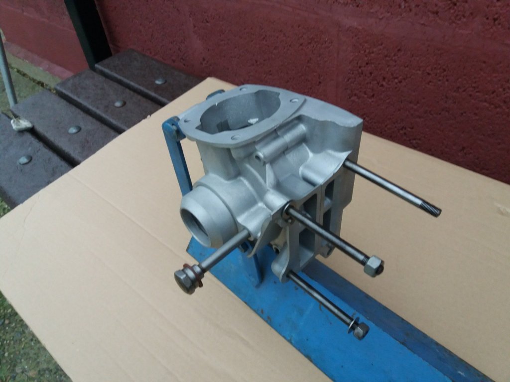

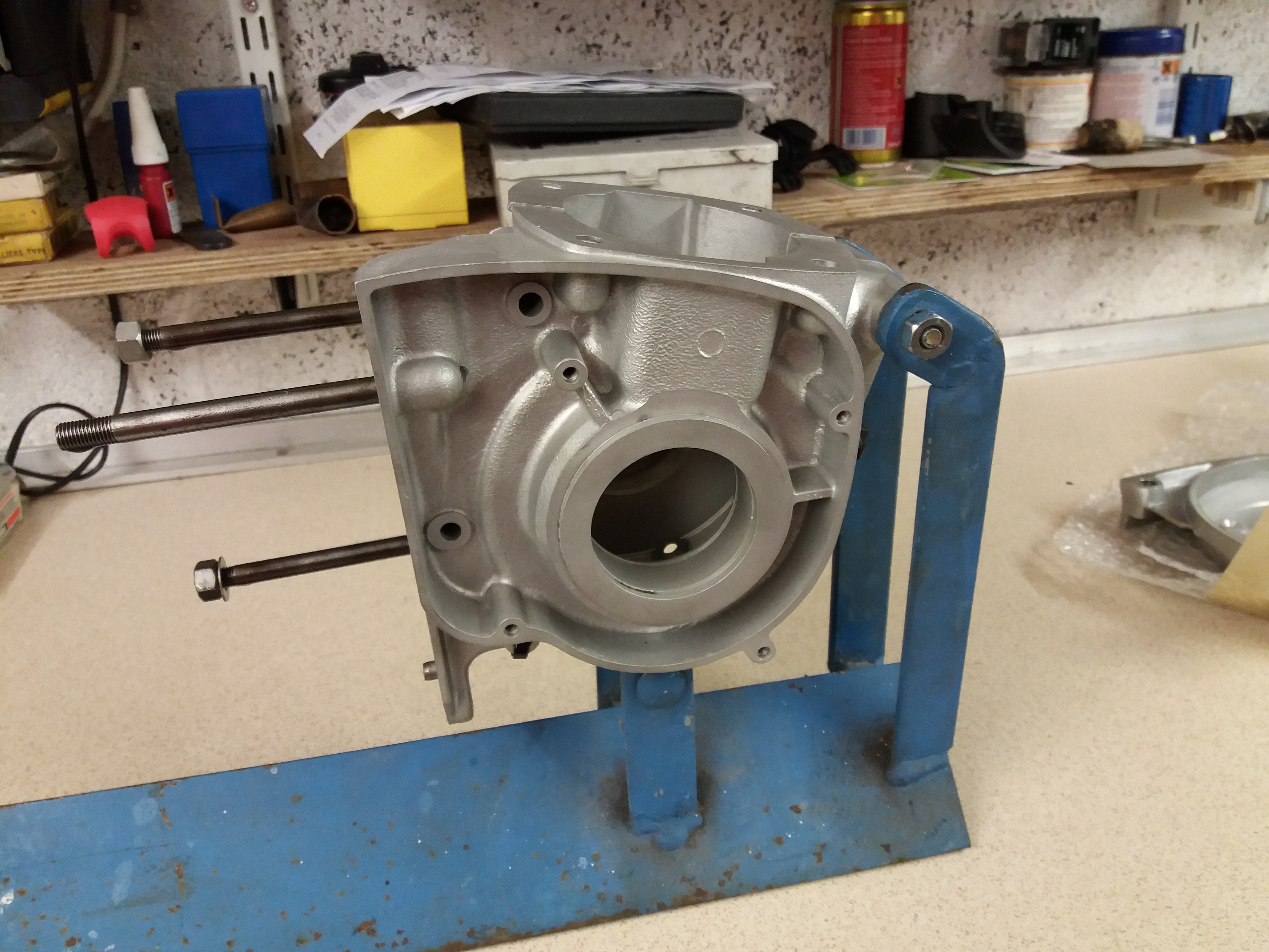

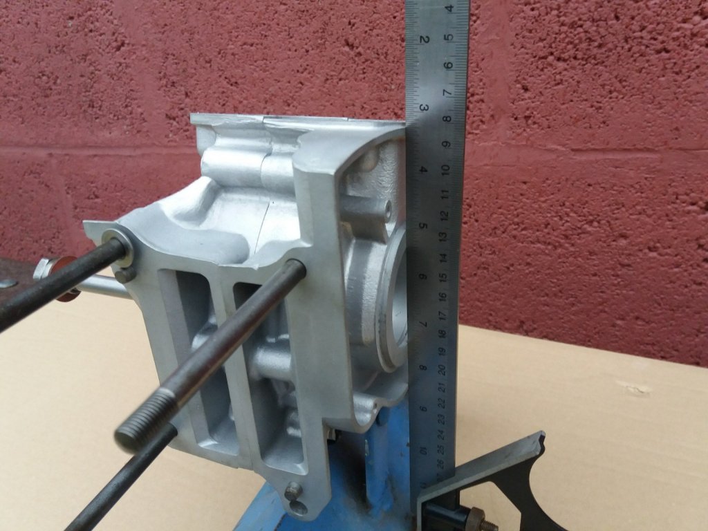

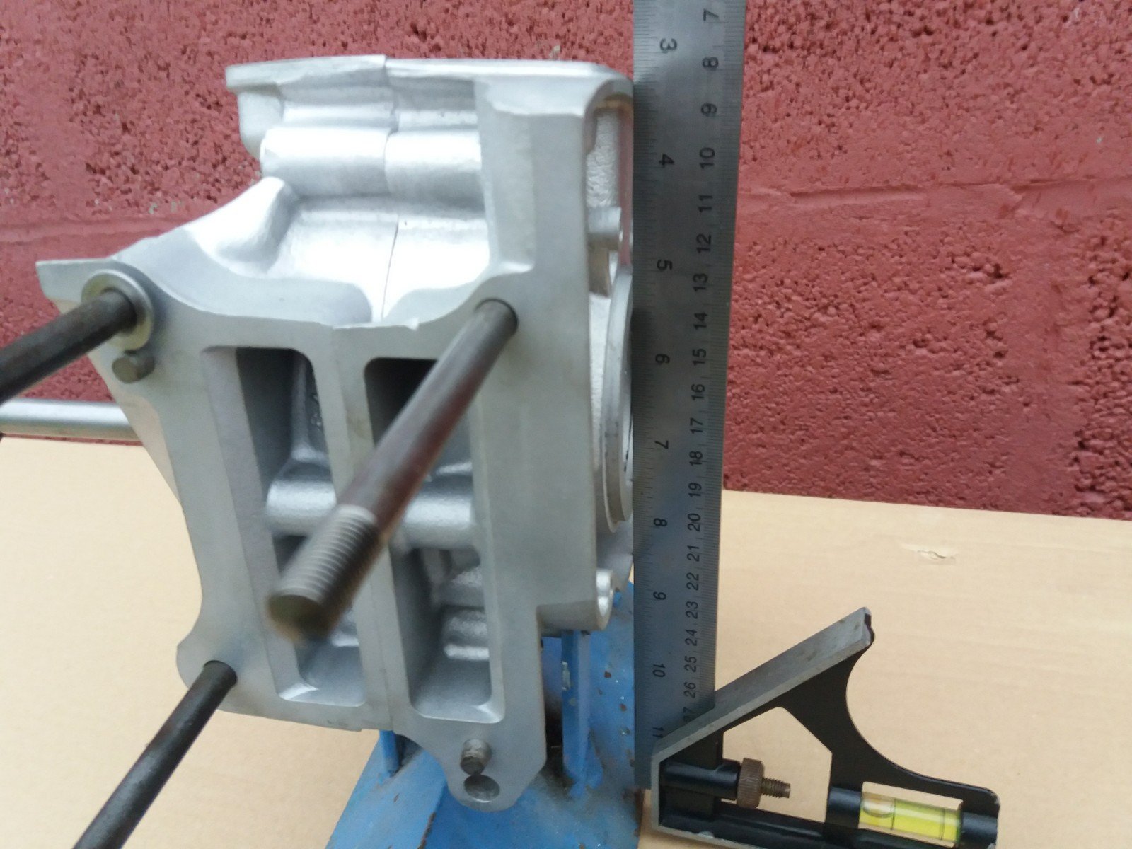

The crankcase castings were an issue as with the 9E onwards, in terms of their aesthetic finish this tended to shroud the main bearing housings and created excess heat that could not effectively be passed to the surrounding air. Many had the excess aluminium cut away to expose the main bearing housing to the air, as with the 37A type. Hope that makes sense.

Section Swept & Hewson; Thanks for the info  on the timing side shroud and the photo, my casings don't look that clean at the moment. Your comments do make sense. Is the normal approach to machine the shroud back level with the casting for the main bearing, it's hard to get perspective from the photo?

Hewson, thanks for the photos. They're brilliant, a great help and just what I needed.
