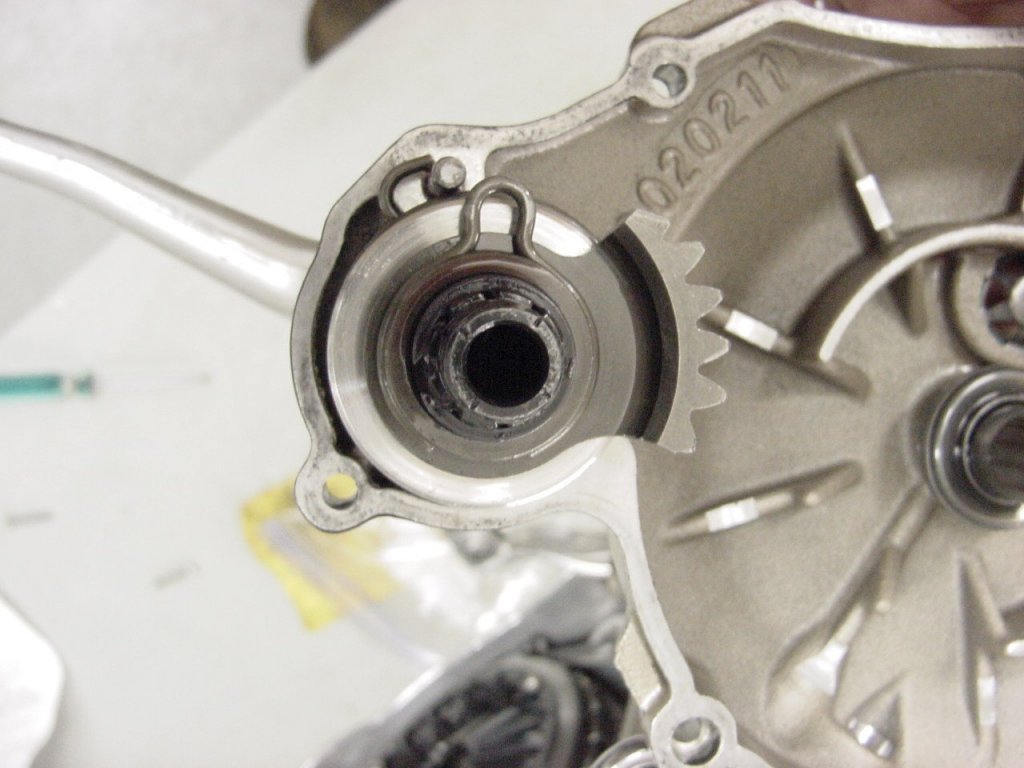

I suspect it's just been misassembled.  You must wind the kickstart return spring up slightly from its relaxed position prior to putting the clutch cover back on.
Make note of the thrust washer at the end of the kickstart shaft (not shown in the photo below).  It's easy for this to fall off during reassembly.  I grease this washer to help keep it in place, and lean the bike to the right when installing the clutch cover.
Take reference photos during disassembly.   The "loop" in the kickstart spring fits into a mating area in the engine casting.

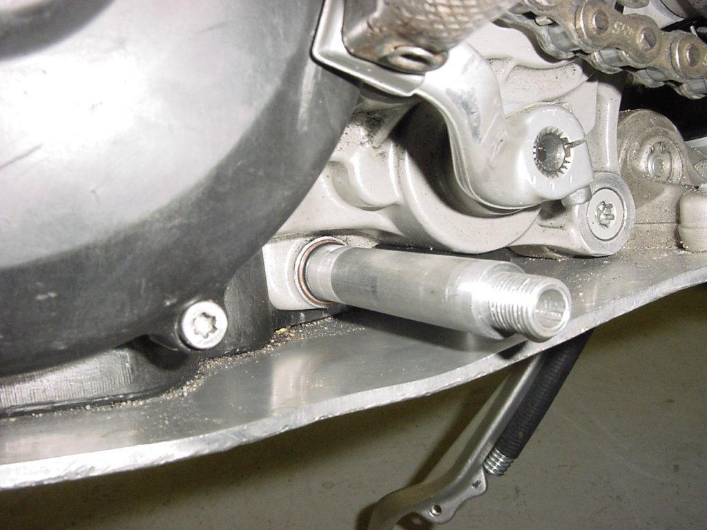

Pindie, you don't need to remove the cover completely.  Just loosen the screws and pull the cover away from the engine case slightly.  But this makes a mess!   I made this little extension specifically for trials bikes to keep the mess at bay.

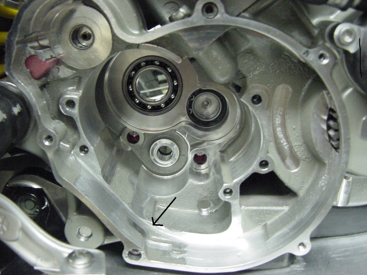

Works fine on the 2011, but I can't get anywhere near all the oil out of the 2014 via the drain plug alone.  Anyone know why this is?  Does the locker shaft have something to do with it?
My 2014 has some additional machining that allows clutch cavity oil to drain by removing one case screw.

The he plot thickens. Today I removed the case. It’s definitely been off before as the gaskets damaged and a dab of sealant had been used to seal it.
I followed the guide. Rotated kicker anti clockwise till roughly lined up and gently eased into place. First kick it returned perfectly, same for second (started!!!) and third but on the fourth it went slack again and with each kick got slacker till it hovers just above the foot peg instead of returning. What’s going on? Have I missed the recess again and slowly but surely tension is lost or do I have another issue? All seems to work fine at first though so I’m confident the spring itself is not the problem.
Pics of the inside of your case....sounds like the spring is slipping somehow
check the inside case casting where the loop fits to make sure the casting that holds the rubber stopper in place has not worn or cracked which would allow the loop to slip down past the rubber thus leading to the original issue again

Definitely no wear in the recess for the spring loop section nor the rubber plug bit. It all looks new. I’ve ordered up a new gasket too so will re visit this and check and double check. I was very happy and excited when it first sprung back! I love riding it so would just like everything perfect (ish).
