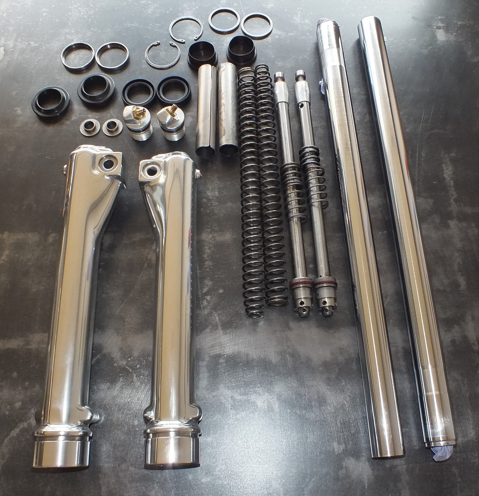

Hi all, I need some help please with assembling the forks on my Beamish. It's been quite some time since I took them apart so my memory for the position of the parts is faint, The drawing of the forks on the Beamish owners club differs from mine so i'm uncertain as to the position of all the parts.
I'm hoping someone on this forum has pictures of the correct assembly for the parts in the picture I have attached. my main concern is for the position of the small springs on the damper rod.  Thanks in advance.  Phil.DSCF3355.thumb.JPG.56a800fb81e798801dd60e6db3abb151.JPG

Thank you very much for the information, just what I needed. I was looking in the parts book section under "forks" but it has a different picture, only has  the long spring shown.
Cheers.
I can't offer any help but I just wanted to say you have done an amazing job refurbishing those parts!
Phil
Glad these were of use. They came from an old Beamish manual that I kept from when I used to own one myself many moons ago - in days when manuals were provided with new bikes. If you need any more info there are full parts descriptions and assembly drawings for the whole bike. I want to keep the manual, as I may buy a bike myself to refurb at some point - however I can easily scan and email information if you are struggling to find what you need. Maybe I should check out the owners club and see if this information is of interest to them.

Can anyone explain what the the two small springs in the Suzuki Beamish  forks do?  The bottom of the damper  rod is fixed and the valve [ ? ] at the top is retained in the top position by a circlip so there seems nothing will move to act on the springs which can then float up and down  on the damper rod, making them superfluous.  Or am I missing something???
Think about what happens as the forks extend. Those little springs cushion the end of the fork extension travel. They are important when riding up steep hills.
Short springs are usually for top out 👍 so it doesn't go 'thunk' when you pop a wheelie.
