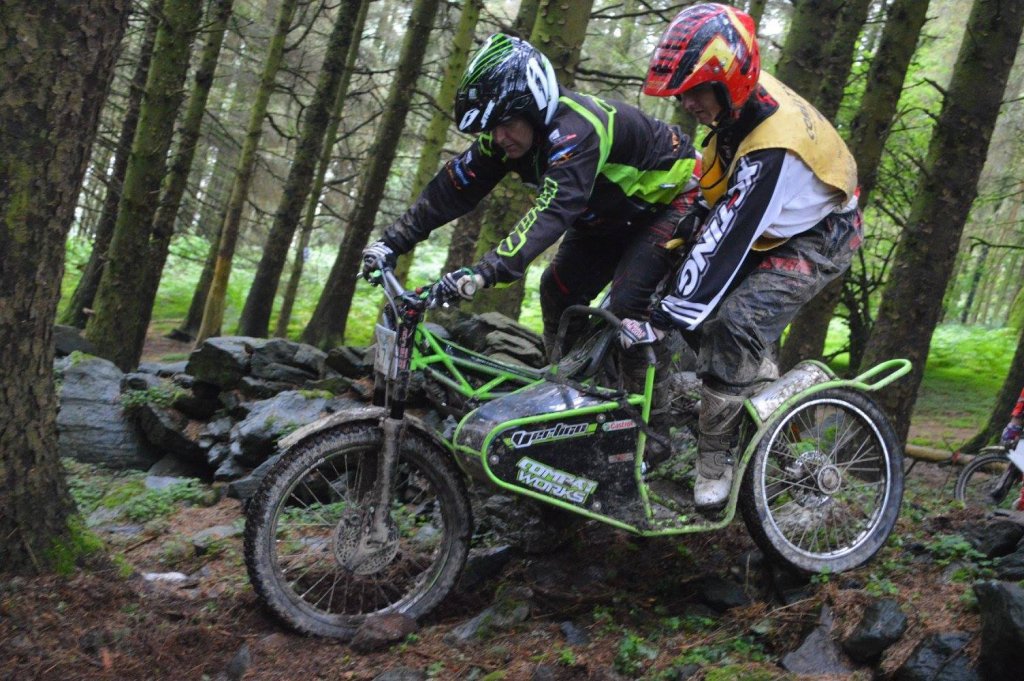

My 2017 300 Combat came new with 9:38 sprockets fitted and my 2017 300 Ice Hell 10:42. Both give the same 4.2 to 1 gearing i have gone to a 9:40 set up on the Combat as it's pulling a sidecar.
