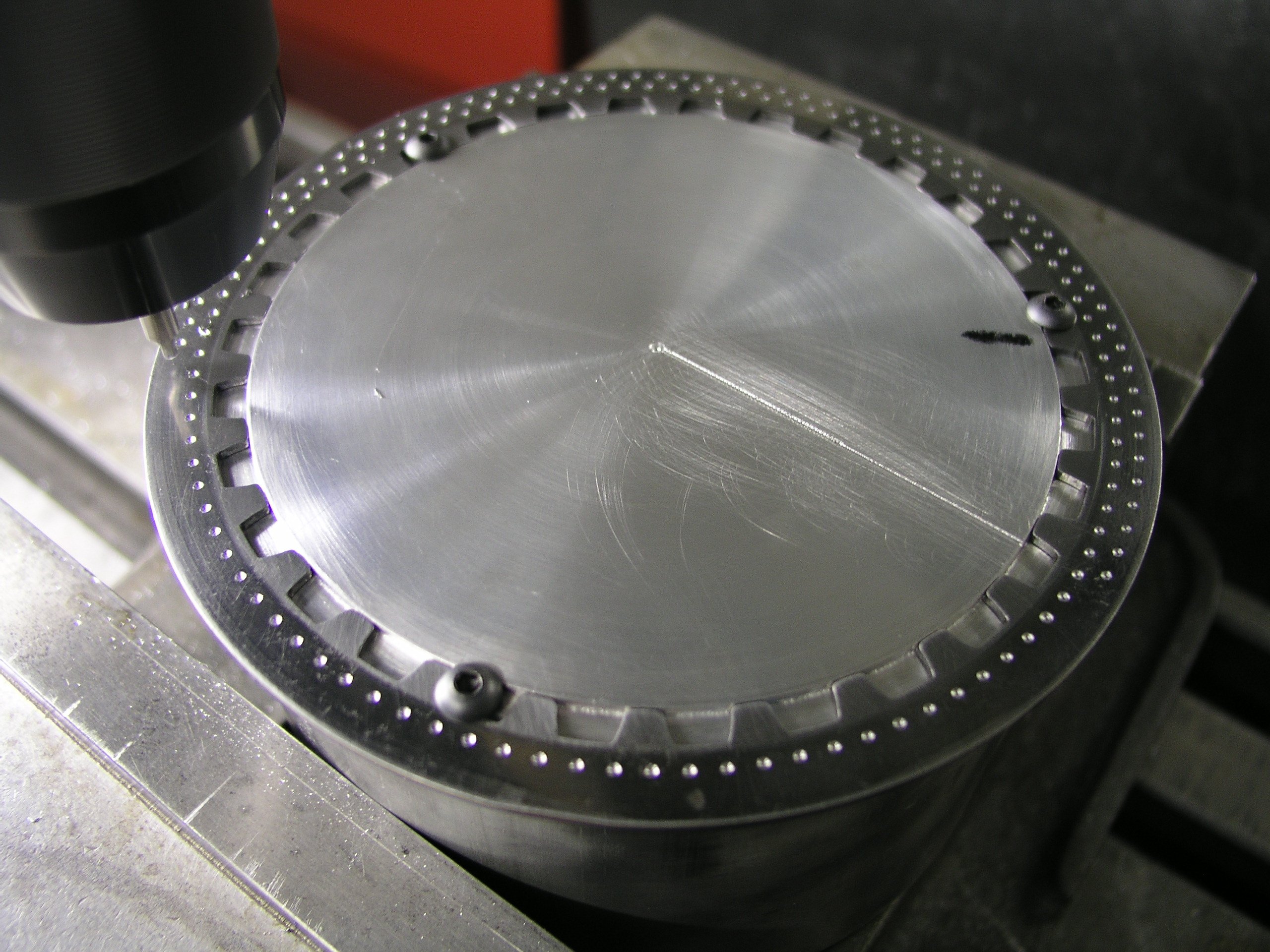

Dimpling the steel plates completely fixed that problem on my Shercos.

Another thought... I suspect new steel plates may work better.  With my Shercos, the sticking behavior did not start until the clutches had a lot of hours on them.

Thanks for that picture of how dimple.  Can you share details on diameter and depth?  Do you use a CNC or are you super patient?
Definitely not super patient.  It was done on a late 1980s CNC machine with a "conversational" programming aid.  The bolt hole circle subroutine allowed a maximum of 99 holes -- so that's what I did.  Still, that's nearly 2000 dimples for a set of 5 steels.  I used a #3 center drill, but I don't think the dimensions of the dimples are at all critical (and I could not tell you what they are at this point).
I was amazed how well it worked.
