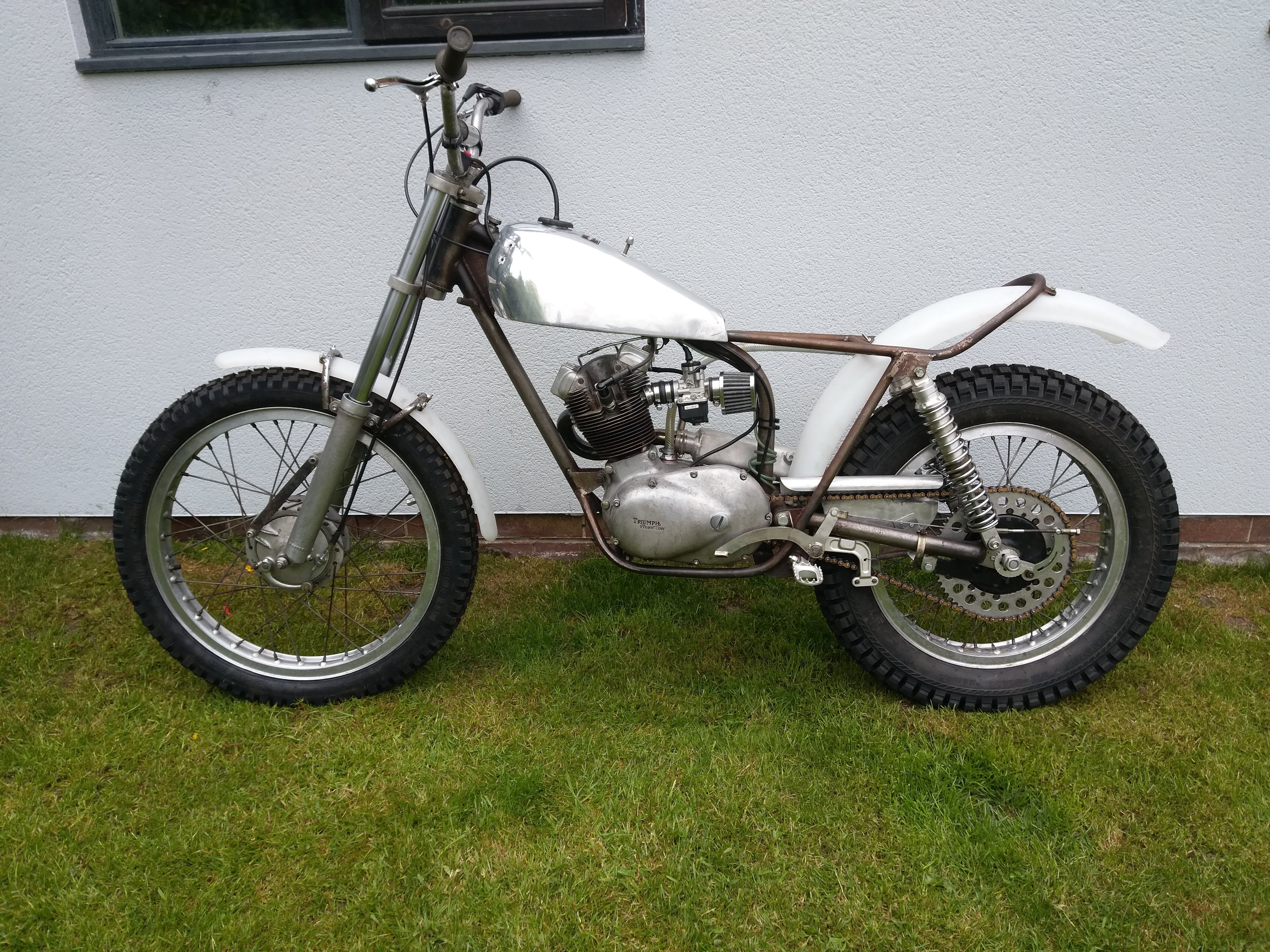

does anyone have one of these or photos of one, I have managed to get hold of a frame for a build and am looking for info around the frames?
any input appreciated

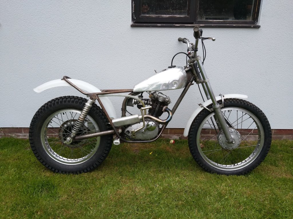

Do the pictures show the bike you have?
On 5/27/2019 at 6:22 PM, detective 21 said:
yes, doing the dry build to see how everything will work together at the moment
It is looking good already, what engine set up will it be 199cc, also are you staying with the Montesa forks?
at the moment I am staying with the monty forks, may change the yokes though a there appears to be a couple degrees rake in them but will see how it rides first, the engine is a pretty standard set up, dellorto carb, electrixworld ignition, standard clutch with alloy pressure plate, gearing- 16 engine/ 13 gearbox/  62 sprocket, it weighs 77kg currently with no fuel or engine oil.
