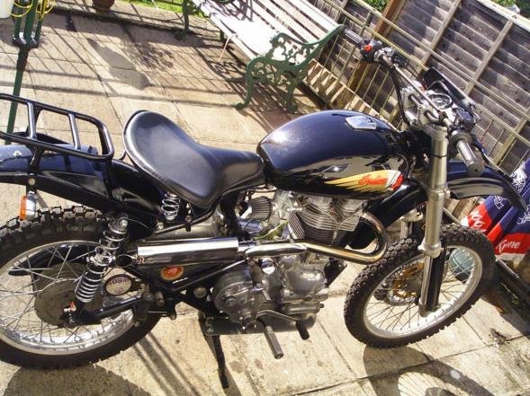

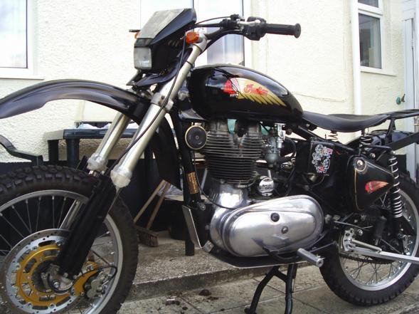

Hitchcocks for parts uk lots of online parts can be found on the web from India  lots can be dun with an old Enfield
