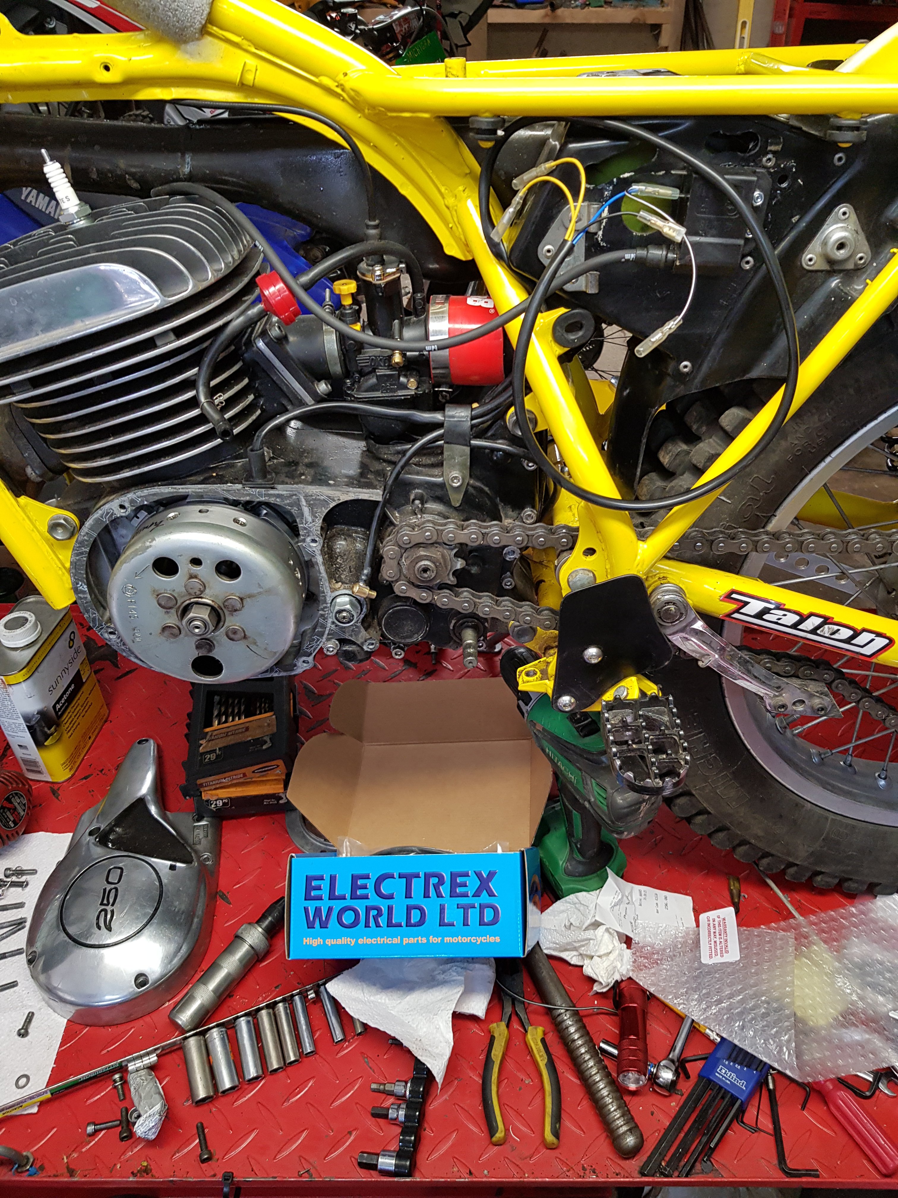

Does anyone have advice regarding torque specs for the TY-250A , 1974 bike?  currently reassembling after adding electronic ignition would like to know the torque for the flywheel nut. also would like to know after finding TDC what is the optimal advance or retard of the timing.  I will be using a strobe with advance degrees on it.  Thanks for any help.

I just installed a kit on my 74 250 2 days ago.I put it center slot and bike ran well but it had bit more pull off bottom with points.I shot it with light and timing was pretty retarded.Ended up setting timing light aside and tune by how bike runs.Set at full advance and bike did not like it.It is now set slightly advanced of center position and bike pulls well off bottom and revs out better than it ever has.The trouble with the timing on stock is it is a compromise because lack of advance. The electronic advance gives you ability to make bike run better bottom to top.The old timing mark is not super usable for the electronic kit.It is a nice piece of kit and happy I have it.I actually find the motor works better for me than my modern GG 300 pro which is crazy.I am going to add a flywheel weight to my GG to see if I can make it more like the TY engine.I do notice the front end is easier to lift with the new kit plus added run out is a win win.

the flywheel nut (magneto) gets 4.0- to  4.5 kg-m or 28.9-32.5foot pounds  of torque, but you need a special tool to hold on to the flywheel.
the timing is normally set with a dial indicator riding on top of the piston with the head removed.  the spec is 3.1 +/- 0.15mm BTDC and the engine rotates CCW as viewed from the left side. At that position, if you had points, the points should just open right then.
But with your electronic ignition and if you have a degree wheel and a timing light, and your conn rod is 125mm long, then you should get the equivalent timing at 22.74 degrees BTDC on the wheel.  This is only a ballpark figure and assumes a maximum amount of advance at that point.  Depending on the rpm, your electronic ignition will regulate the amount of advance. At the very low rpm's you would want less than 22.74 degrees to make the bike easier to start and reduce the chances of a kickback. I hop this makes sense to you.  I keep getting notified that you are still looking for this information, but this is my last attempt to reach you without feedback.

Who made your electronic ignition kit and how do you like it?

The rod length for the 74 250A is 125 mm and using the calculator above, the angle you seek is 22.74 degrees on the wheel.  That is the starting point anyway.  So is your kit from electrex? how do you like it?
Electrex World ignition can be difficult to set or check with a strobe, some strobe lamps get confused with them,my Snap On one did when I was sorting out my sons D14/4 Bantam. The boss of EW told me that strobing could be difficult with his system. It was a couple of years back now,but I seem to remember there are two firing events per rotation,so there is a spark as well near BDC. The strobe would jump between the two events,making it difficult to see what was happening.
I'd be inclined to set it as per the EW instructions and see how it runs.

That explains why my stobe was acting so wierd.Ran bike without cover so I could pull flywheel quick to test adjustments. Was reasonably easy to find sweet spot.
