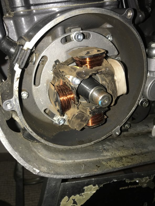

Got the flywheel tool today and discovered this? Would dirt and grime be a factor at all??

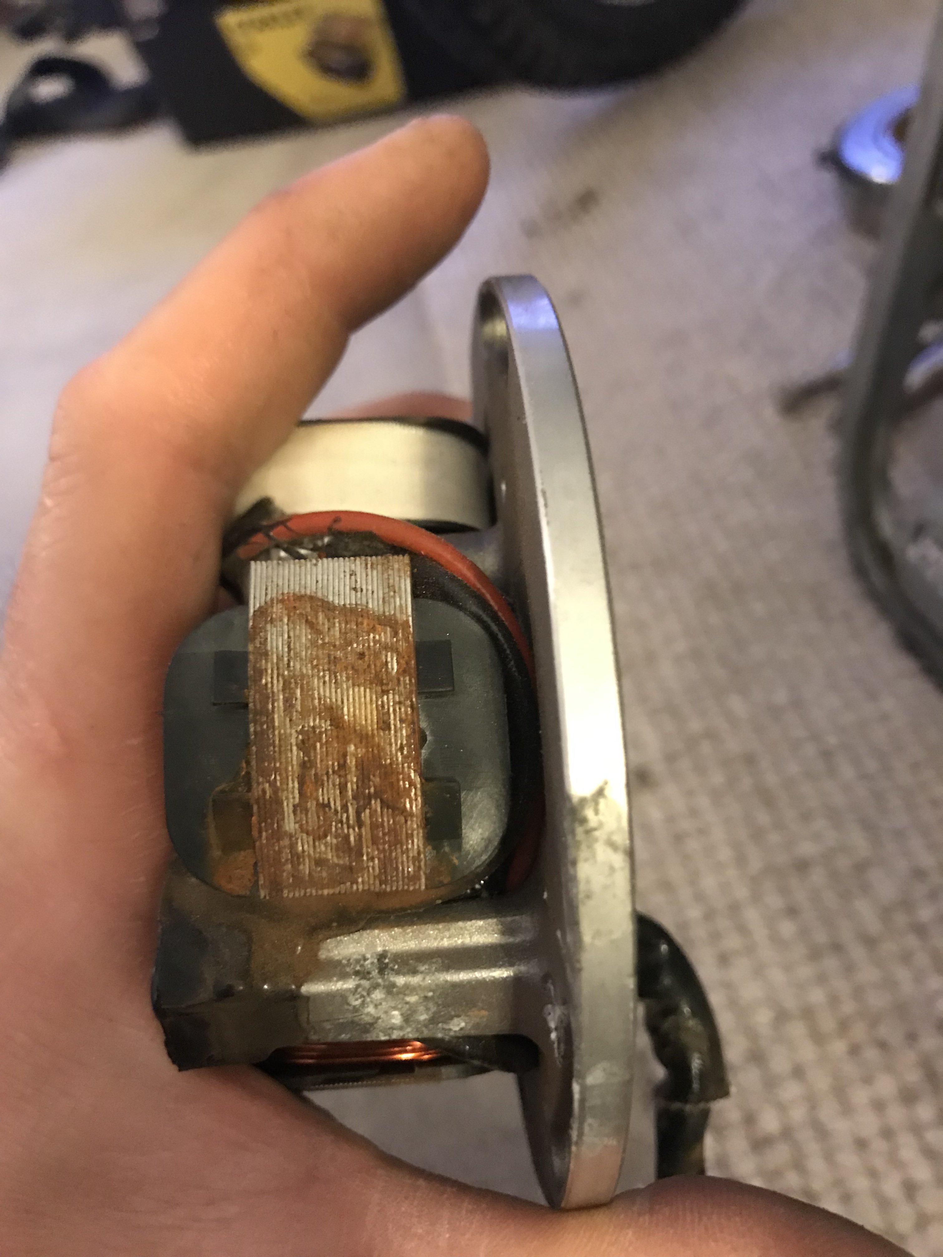

Just saw this slightly rusty terminal....another potential non sparking issue or is this normal? ??
I would assume the rusty coil was the 1 at the bottom? That shouldn't be the cause & neither will the dirt at the bottom of the cases. By all means clean everything but I doubt that is your problem
Scroll down this link to the readings you should have from the stator, usually 1 of them is a long way out if there is a problem
https://www.splatshop.co.uk/stator-repair-exchange-new-style.html
