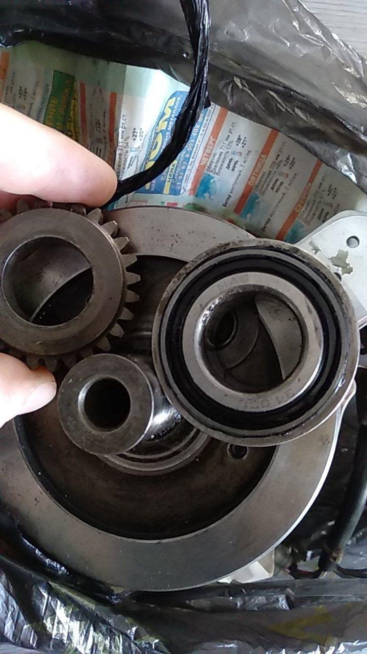

Oil form gearbox comes to engine, because rubber on the bearing is bad. I changed out ring rubber, but it still dont work, and oil going to engine.
Is anybody know, how to change bearing?? I dont understant how to unlock this bearing.
I cant find information on manuals...
I think, i need pull gear and make hot, and after pull bearing...

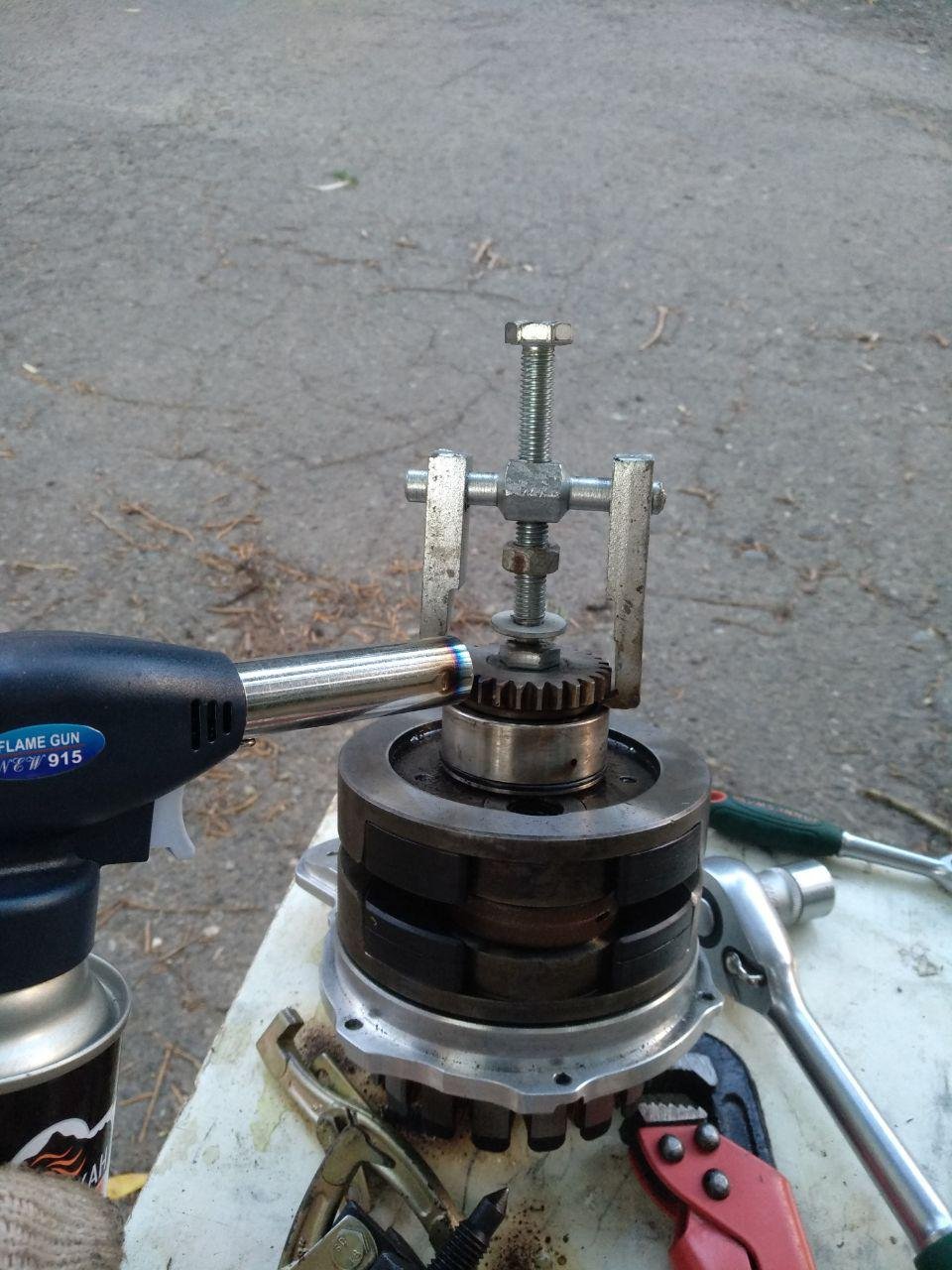

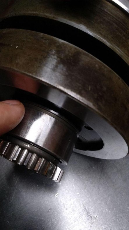

Thanks so much. Can you look please, is it correct action on the photo?
I would use a stronger puller, here is a photo of a bearing separator image.png.ff155f12fc9a85509ad852e191e0f13b.png
This type is better to get in behind the gear. Best not to use a flame to heat the gear, use a hot air gun. The gear will be hardened and tempered and you may damage the tempering with a flame.

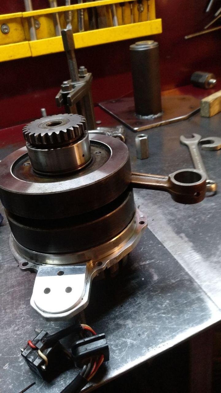

I have to remove gear and after bearing like this?
Yes, with hot air first on the gear. The bearing is easier, but you might not be able to get the bearing puller halves behind the bearing and so would need to use two wedges. Use the puller like in this image: image.png.2fbef8dd1812a77e0a1120582c034fba.png

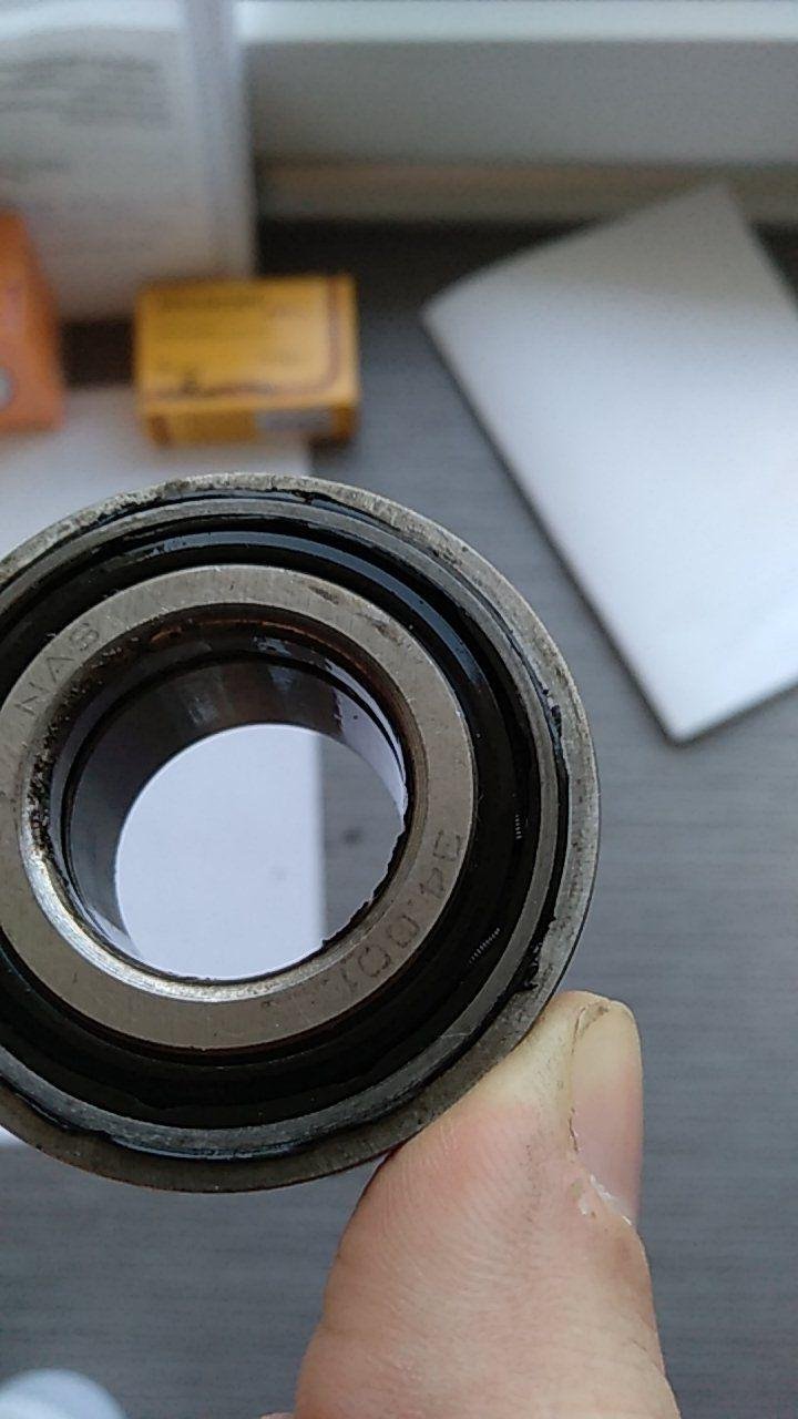

Somebody open engine before me, i think bearing is not original, because bearing has i line, and its not stock.
Spring on the rubber is broken.

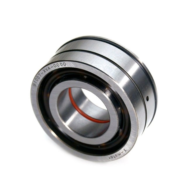

Bearing has model NAS 34.001 size 52*25*23 mm. Can you help me, i need to buy the same bearing, or maybe buy other model? Maybe from Gas-Gas, like this https://www.zonetrial.com/ArticleDetail.aspx?langue=E&Modele=Crankshaft+bearing+GasGas+TxT+pro&Id_Article=12118

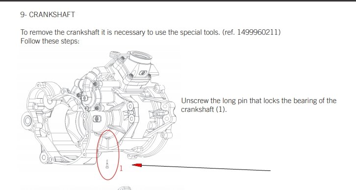

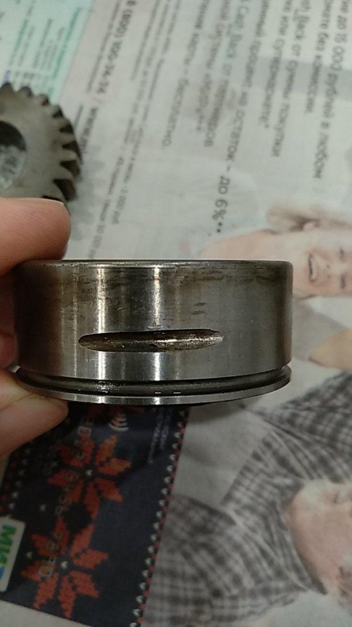

Can i use this hole for lock pin?
150954761_2019-9-4_22-23-31_857.jpg.a20241e32405e07fe3c449e43afc0710.jpg1250247829_2019-9-4_22-24-47_484.jpg.7cb3c81847d4e73a8a9b83b60bec5098.jpg

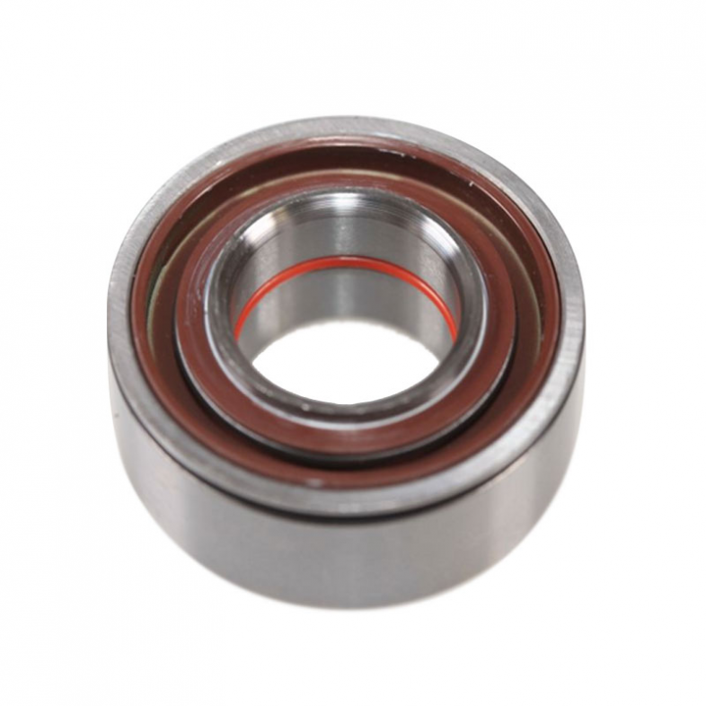

Dobroe utro, I would say that you cannot use the oil hole in the bearing outer as the hole for the locking screw. Even if the hole was the correct distance from the edge of the bearing outer, it would be almost impossible to get the hole lined up to the retaining screw. The bearing outer needs to have a slot cut in the correct place. If you cannot get an Ossa bearing, look for a GG one, then calculate where the slot should go and grind one in. The slot was quite a narrow cut. The intention of the location screw was to help prevent the crankshaft from moving out to the left, your model year would have tighter crankcase bearing housing dimensions than the first models and this really alleviated the chance of crankshaft float. You should have the internal and external viton bearing O ring fitted. When you get the new bearings, sometimes the seals are supplied loose, make sure the oil seal is fitted the right way round with the spring facing the pressure area like this photo. The bearing should go all the way home on the crank shaft, then the gear. The gear should be a really tight interference fit, which you can press on or use a puller to draw on the gear. Dosvidania, Peter B.
