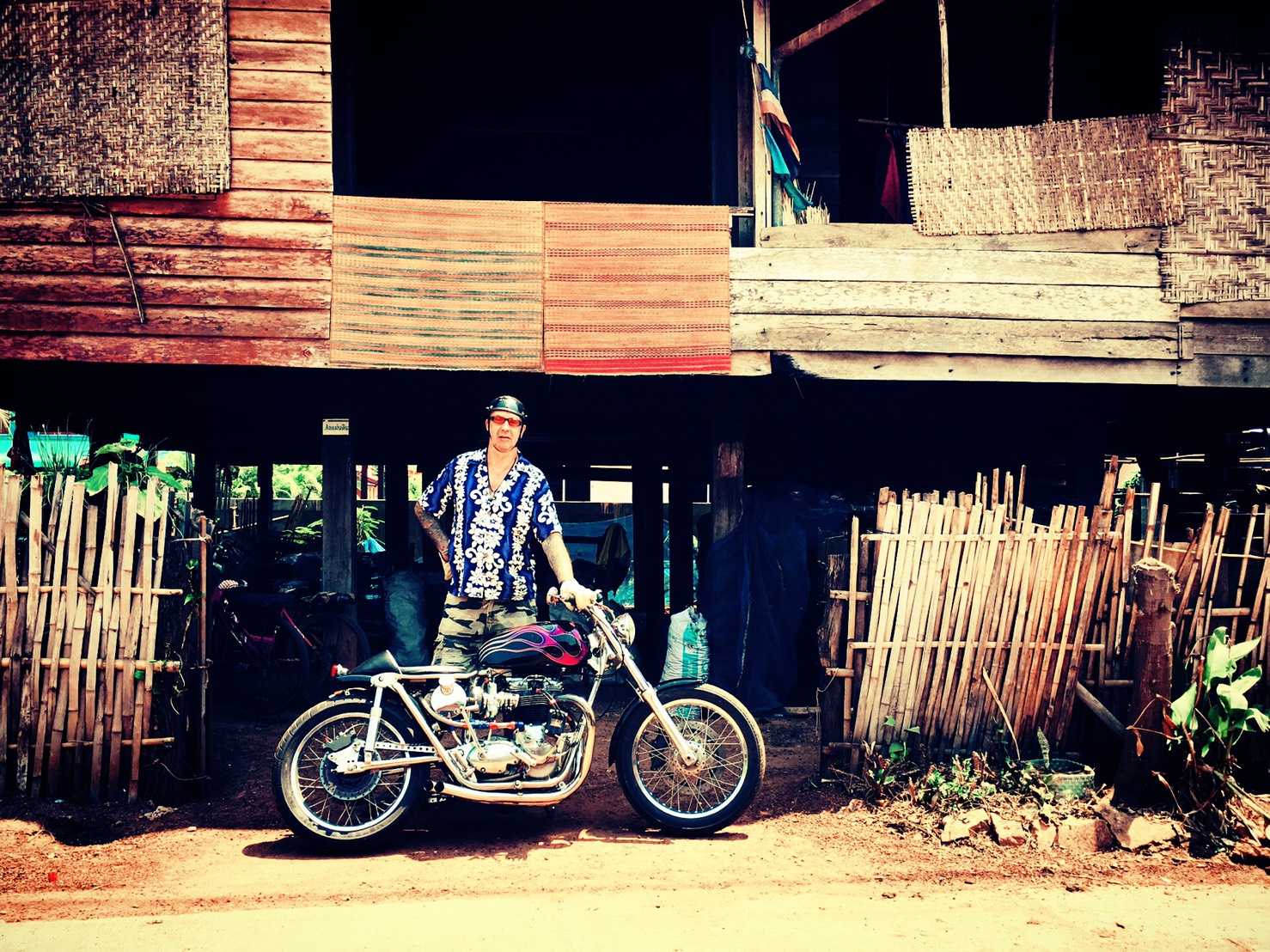

It's either all or nothing with PROPER plating.
So your "bit of a frame loop" would have to be detachable.
Here's a pic of my '79 830cc T140 with the frame and s/arm bright nickel plated.
Pics is from a couple of years ago, polishing and plating was done in 1994.
