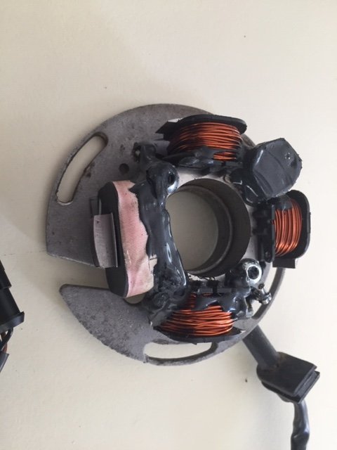

Bernie Onthacoast Posted November 5, 2019 Share Posted November 5, 2019 Hi Trails gurus . I have a Sherco 2.5T 2010 . the gas tank in the seat model . It has no spark after parking up from a ride , when i went to start it a day later there was no spark . From other threads here it does not seem uncommon . However when i tried to source a new stator i am told its no longer available . My one appears to be off an earlier model 2007 , it has 3 windings and a trigger coil . it meters out ok as per specs i got here . Would anyone here know of the meter readings for the CDI . mine is the CDI coil in one, mounted behind the engine high in the frame. I have been quoted $ 690.00 NZD to upgrade to a 013 stator, coil, and CDI . I am reluctant to spend this untill i know exactly what has failed on my bike. Any help is appreciated. Cheers Bernie . Westport NZ Quote Link to comment Share on other sites More sharing options...
Richard Thorne Posted November 5, 2019 Share Posted November 5, 2019 That looks like the one in my 07 sherco iv just had it rewired and sorted for £135 12 month guarantee so if you can find someone over there to do am sure that's your problem mine started 2nd kick after not working for over 12 months ...to replace mine would have been £420 ? 1 Quote Link to comment Share on other sites More sharing options...
cascao Posted November 5, 2019 Share Posted November 5, 2019 Splat Shop used to rewire them. Worth a try 1 Quote Link to comment Share on other sites More sharing options...
pauls320 Posted November 6, 2019 Share Posted November 6, 2019 try motoplat uk, I believe they are the ones that can fix your old one up. best of luck 1 Quote Link to comment Share on other sites More sharing options...
tony27 Posted November 6, 2019 Share Posted November 6, 2019 Send me a PM Bernie, I have a new stator like that from memory that I could possibly send to you to try when I get back from the Gold Coast next week 2 Quote Link to comment Share on other sites More sharing options...
