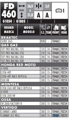

Factory 300 braktec front pads
Anyone know what other bikes use the same front brake pads as the 15 Factory 300?
They do not have locating pins, but rather rounded areas that lock into the caliper.

Sorry, I should have said I don't know what pads the ossa takes but I do know recent gasser with braktech brakes have pads that don't use retaining pins.
The Galfer catalogue quotes FD460 front and FD224 rear for the 300i Factory R
Other bikes to use the FD460 are GG TXT Racing 14+, Honda 4RT etc 15+ and Vertigo 300 Camo and Ice Hell.

Thanks, it does look like the FD460 or EBC shown
