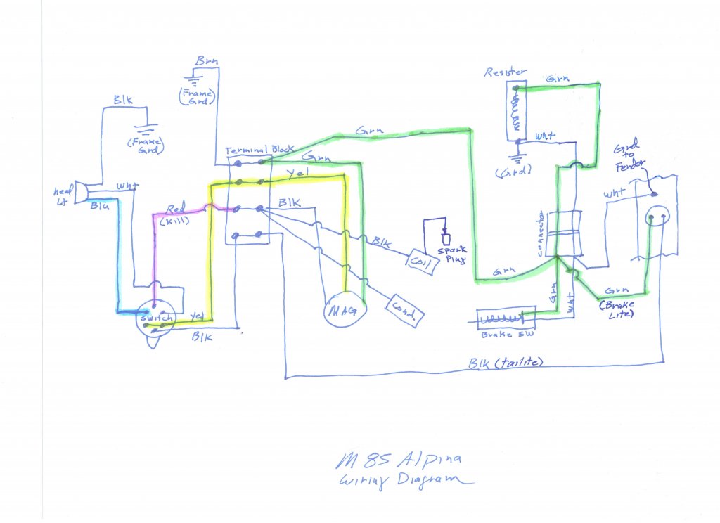

Just recently completed restoration of my model 85 Alpina I purchased new back in 1974. Did a lot of dirt bike riding back in the 70s and 80s before it was put into storage for nearly 25 years. Took a lot of photos as I went along so I could get it back original. Engine fired on the forth kick and runs great. Head light and tail light both work as before, however the brake light doesn't function when operating the rear brake pedal.  Bulbs and brake switch are new and check out using a volt-ohm meter. Have attached a wiring diagram of how my bike is wired. Could someone please review the diagram and see if I have missed something or wired it incorrectly. Any other suggestions for possible solutions would be appreciated also.

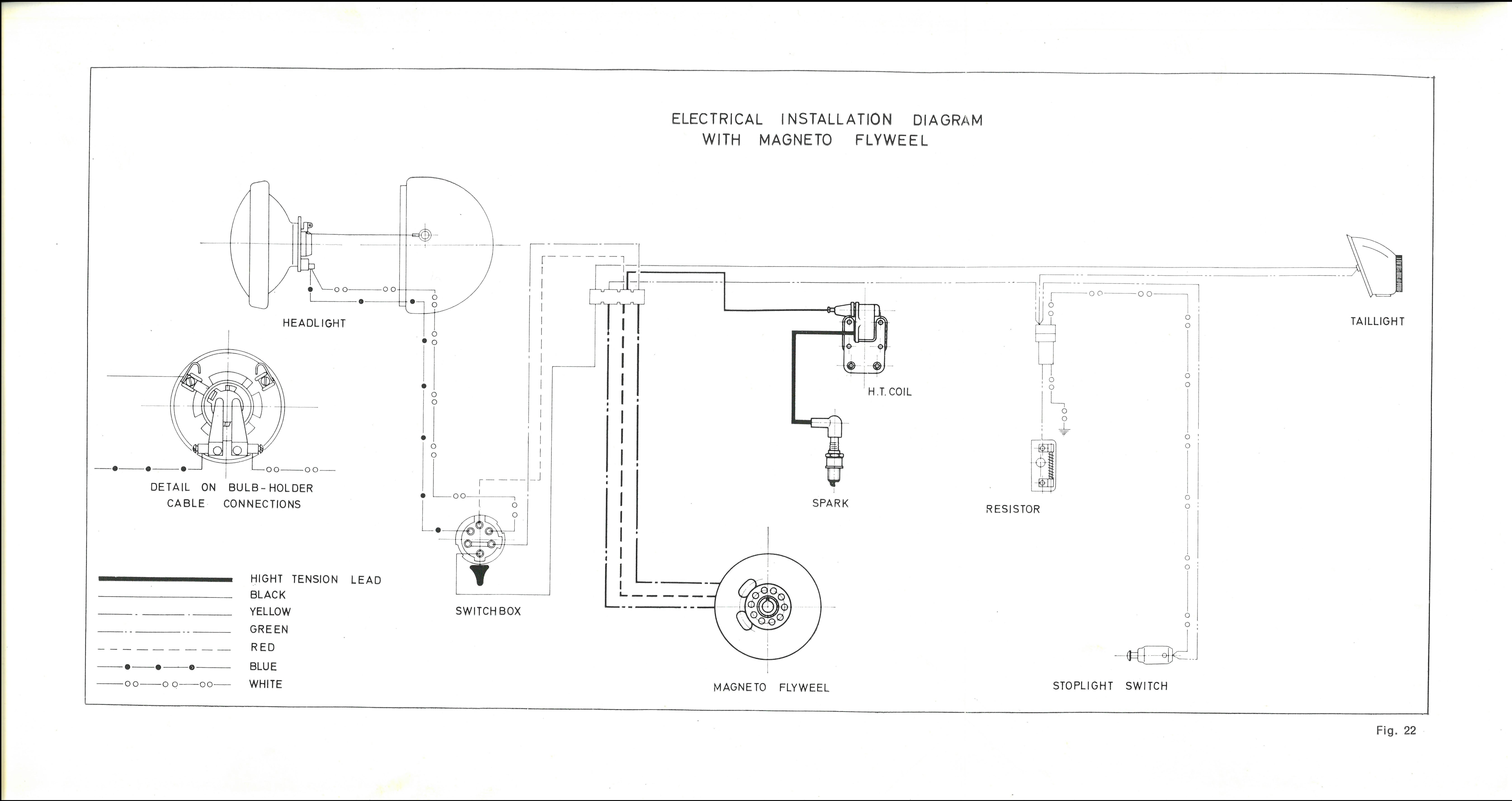

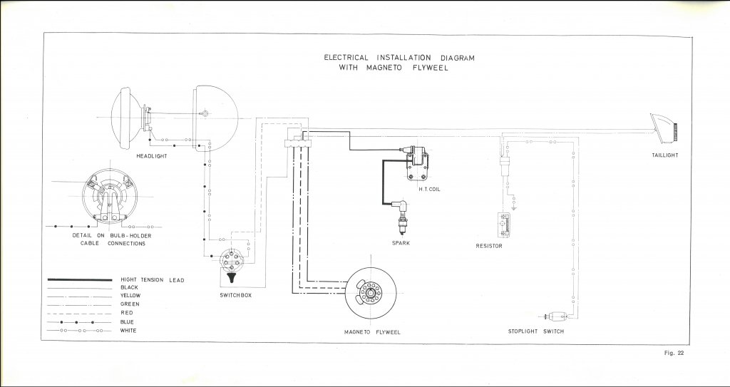

Attached is a scan of a M91 owners manual wiring diagram which basically is the same as the Alpina.
I am not an electrician but I think the brake light switch should have power in on one side, power out the other to the bulb, which then earths through the bulb holder? Your diagram shows the switch earthing directly back to the resistor. I think the green wire from the bulb should go to the switch side that is currently earthed, not to the connector giving you two greens at the switch........... but as I say I am no expert and if the bulb holder is not earthed then I have just talked rubbish, so someone else may be along soon with better advice.

Thanks for your response. The wiring diagram you attached is the most legible one I’ve seen so far, thanks.  The brake switch operates as expected; when plunger is depressed the circuit connects and when not depressed it is open.  In looking over the M91 diagram, it appears to match my diagram.  I am starting to suspect there may be a problem with the green wire coming from the magneto.

Thanks Lorenzo for your input. My brake light switch operates as you have described.  Don't believe the wiring diagram is for my Model 85.
Mikey -
The wiring diagram is correct for a standard mod. 85 with direct (AC) lighting. I have an original owners handbook; this uses the same diagram exactly.

I have correct bulbs installed (6V-4.5W and 12V-18W), checked them with meter and they are both OK. I guess what threw me off on the copy of the circuit you sent me was the front brake switch; my bike only has a rear brake switch. I disconnected the green wire from magneto green wire and applied 6v DC power supply to the rear brake circuit and brake light worked when brake pedal was depress. So what does that mean?  Has anyone reviewed my schematic to see if it is correct?

.The earth/"ground" side of the igntion coil (the green wire from the magneto) must go through the brake switch (brake off/not applied) or through the bulb and resistor (brake on), thence to earth. You appear to have bypassed this requirement by earthing the green wire at the terminal block - Brn. wire to "frame grd"., meaning the switch circuit is not working.
Try removing the brown wire............

Going to remove the brown wire at the terminal block as you have suggested. I wondered if that might be the problem but remembered it was wired like that before I disassembled the bike.  I'll let you know the results soon.

I removed the brown wire and the brake light works now, however both bulbs illuminate bright. Are both bulbs supposed to illuminate when braking?  With the headlight switched on and braking, both bulbs are much dimmer.  That brown wire grounded to the frame has been that way since I bought the bike new in 1974, wonder why.  Feeling better about the wiring except for both bulbs illuminating upon braking. Your thoughts?

Fixed the issue with both lights illuminating when operating brakes. I had the headlight ground at the same terminal the brown wire was attached to the terminal block opposite the green wires. Removed the brown wire and grounded the headlight wire to the frame and all is working well.  Thanks for your help.
Mike
Mikey -
I was about to explain that the brake light and rear light bulbs seem to be sharing  a common earth/ground connection...........now we know  why !
