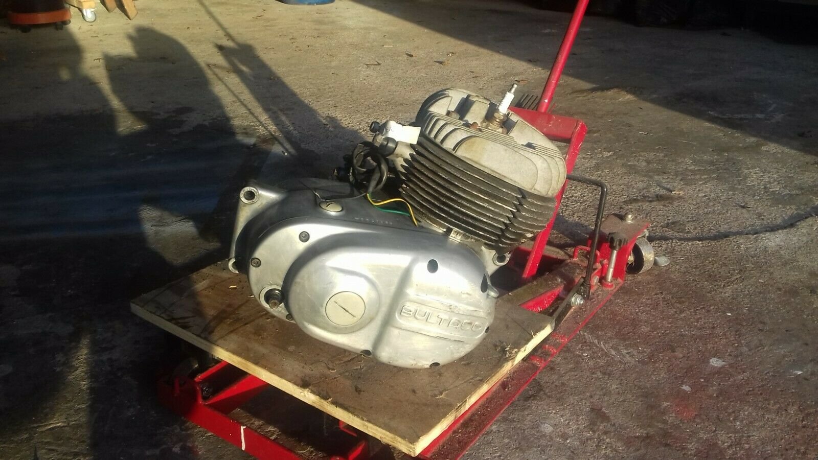

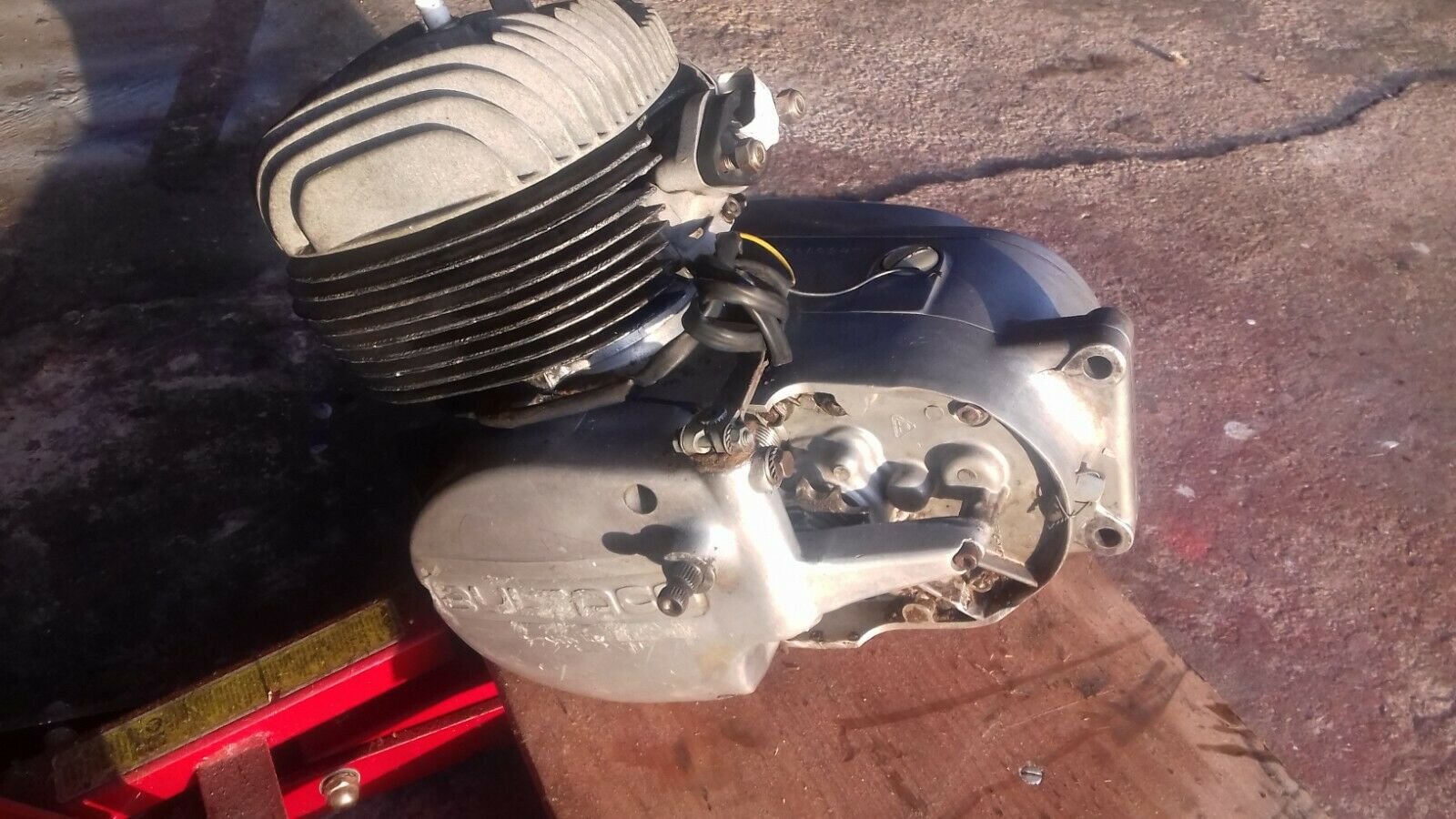

Hi   Purchased a Sherpa m80 100 cc , on ebay few years ago ,just engine , Installed new piston please look at pictures ,small head ,don’t see any 100cc  , on m80 ,, what you think
That doesn't look like an M80 engine to me.  M80s were all 250cc.  The cylinder heads on these are held on with 6 fixings not 4.  The ignition side case is too rounded for the M80 as well.
I think this is a 4 speed engine and the number has either been "restamped" or is a badly labelled M8 Engine from a Metralla.  These have the same cases as in your photos.

Thanks  rcgods , this engine has  me going back forth , I thought it was model 8   Then , some guy said Sherpa ,  maby a mis stamp   Not like 6 bolt   , round case  , small spacing head studs ,  ?  Model 78 Sherpa ? , lobo , or special order engine , some one might have the same , really just 100cc,larry
