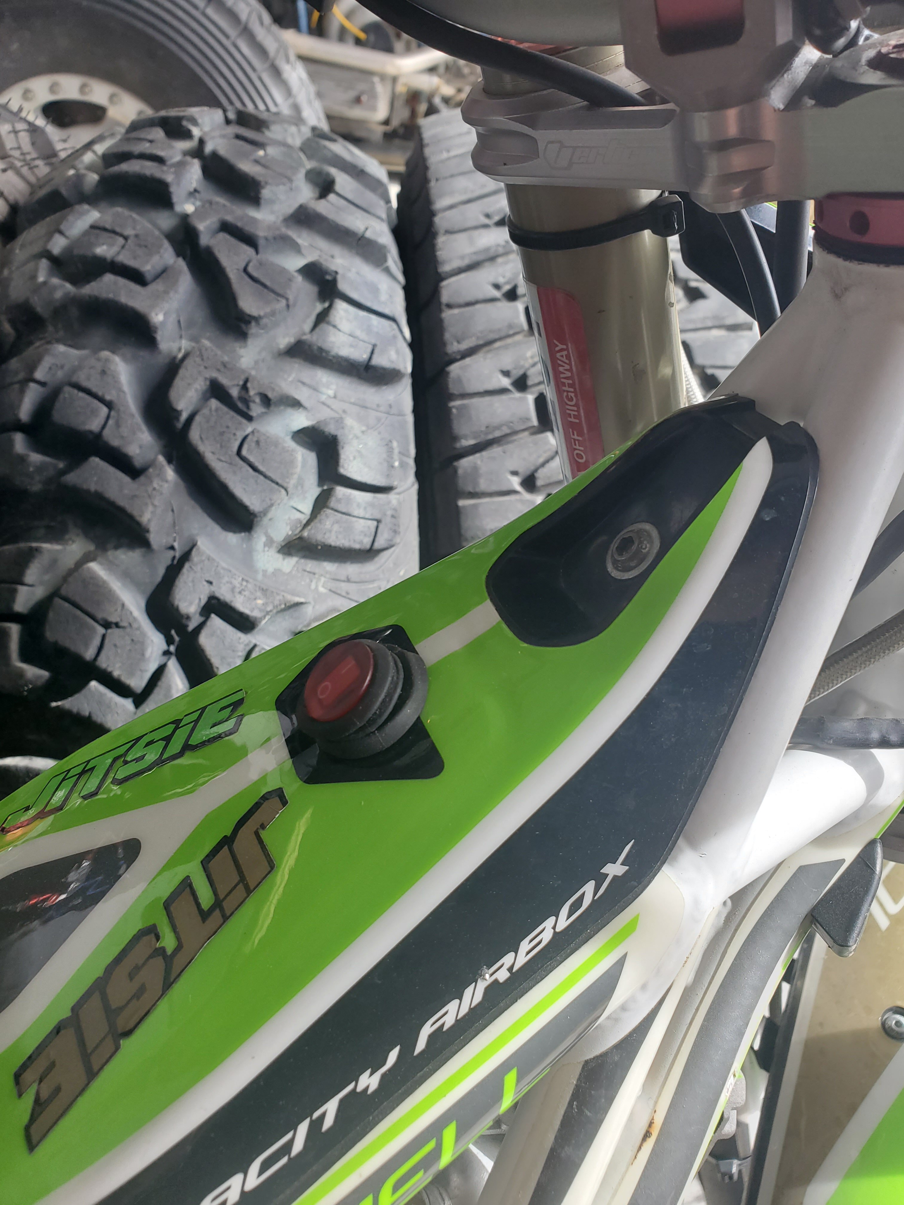

I had problems with my electric system 2017 300cc ICE Hell capacitor leading to fuel pump not activating/energizing properly at start up/kick...sometimes very hard to start!  I actually installed a tiny 12V Lithium rechargeable battery into the airbox 🔋  and a switch to turn off/on. Now when I hit the switch, I can hear the fuel pump energize and kicks first kick no problem every time. I don't like the capacitor being only source of initial power on the newest models, so I fixed it. Problem solved.
