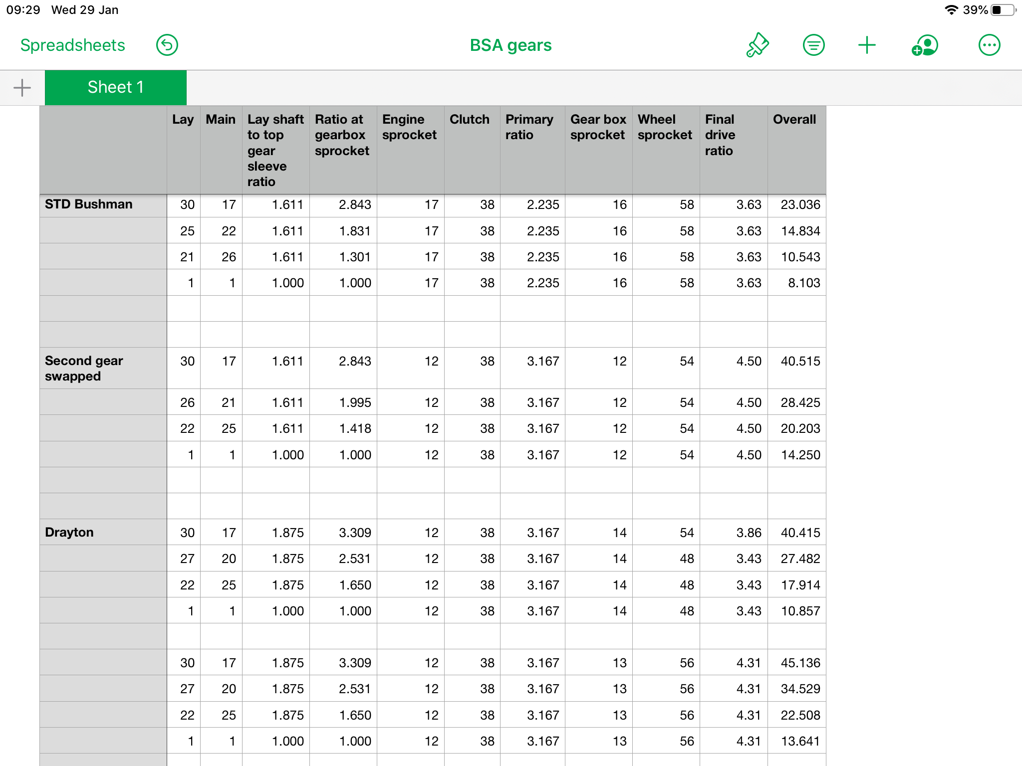

See attached picture showing all of the ratios, the swapped second gear can be used in sections ok depending on your sprocket sizes and rider weight . The best thing about the low second gear kit is the higher top gear!
Hope the spread sheet makes sense
Thanks for the spreadsheet ikb very interesting and Paulmac for the set up you have.
