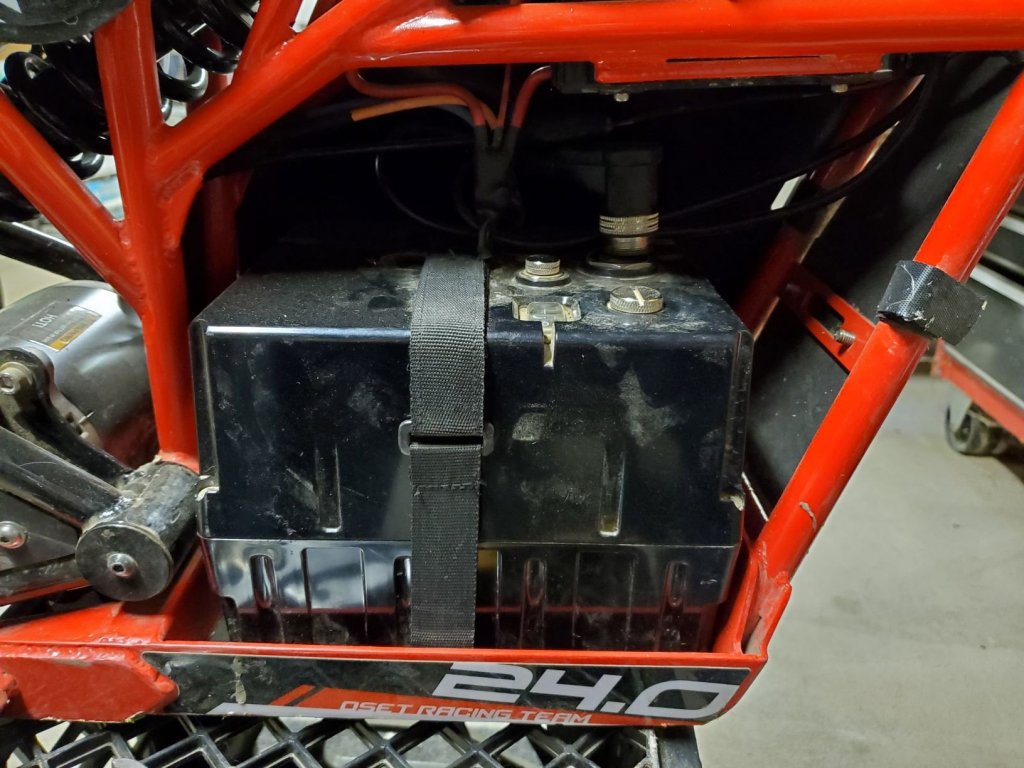

I have the 24 and it is just a cube with a velcro strap. For backyard riding the stock battery has too much capacity for me. It can last me three trials sessions. Fast trail riding will drain it quickly but slow technical riding uses little juice with my preferred setting of 3/4 speed on the top dial.It might be fun to make a battery pack that is half the weight and last just one session.
The battery is 8 1/4" long x 7 1/2" wide x 6 1/4" high. 2" above for connections.
