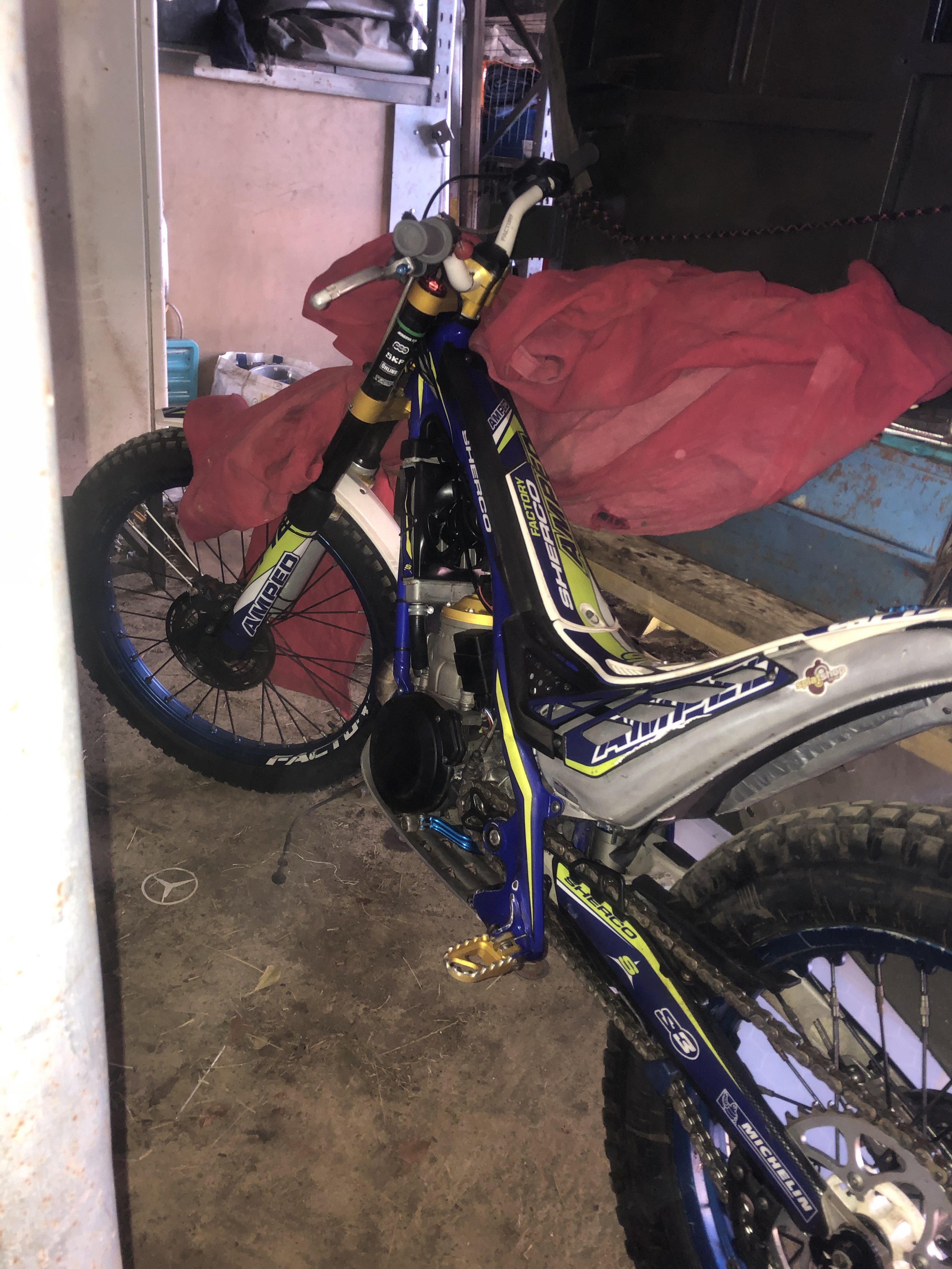

Hello there, I have just purchased a 2014 st300 with a cracked radiator. I have replaced this with a brand new item filled her up with new coolant. When testing the bike after a few minutes of riding it got very hot and coolant started to bubble out of the ‘release valve’?? A little brass thing at the top next to the filler cap? Just wondering what people’s thoughts are?
