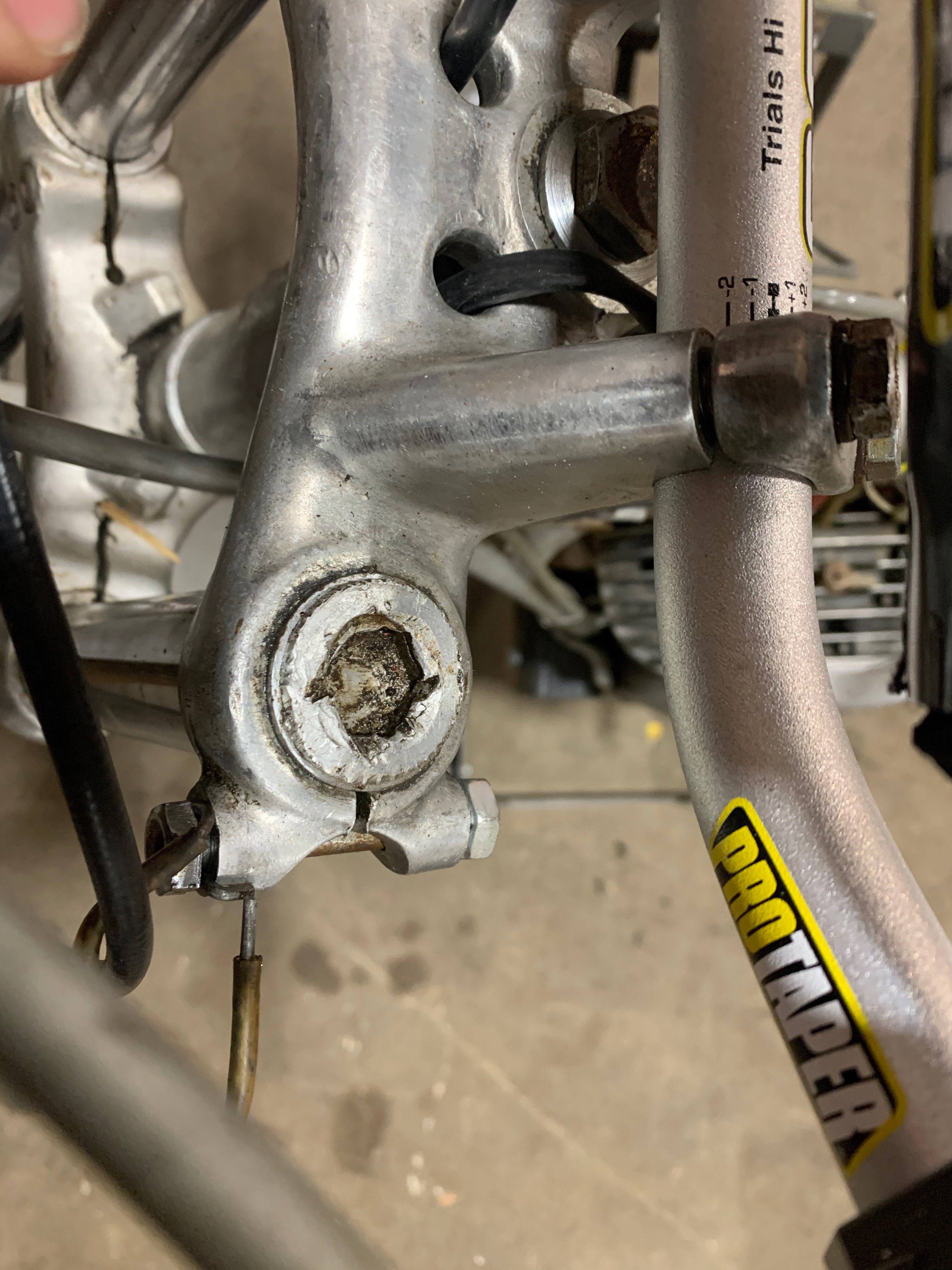

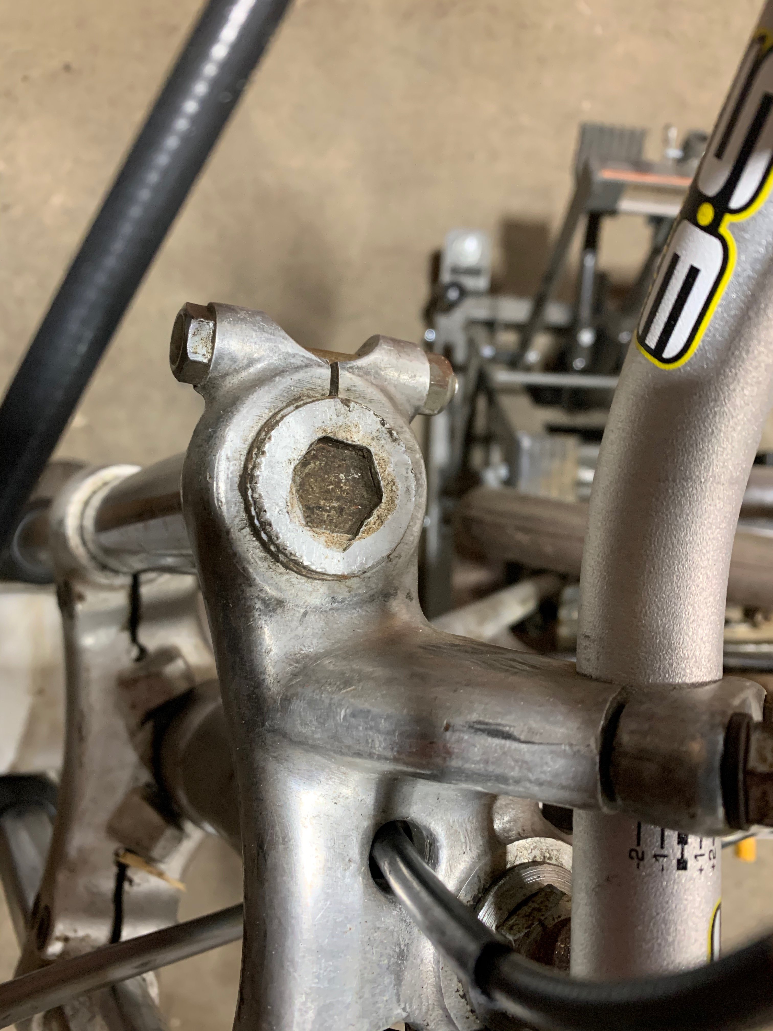

Hello all!
Does any one know where i can pick up a set of new fork caps for my 1974 Yamaha TY250.  They are extremely Bunged up from years of use and abuse or does any one know if another set would be compatible from another bike. Any suggestions or leads would be greatly appreciated.
Thanks,
Jon
In the US B & J Racing has them listed on their website. They are in TN. I,m not sure is something from a different model from the same year,like a DT, with the same diameter would work or not. If so you might get them cheaper on ebay.
Awesome,
Thanks for the leads.
Kawasaki KT 250 also fit.
Yamaha TX500 also and many other 34mm tube diameter Japanese forks made by Kayaba in the mid 1970s
