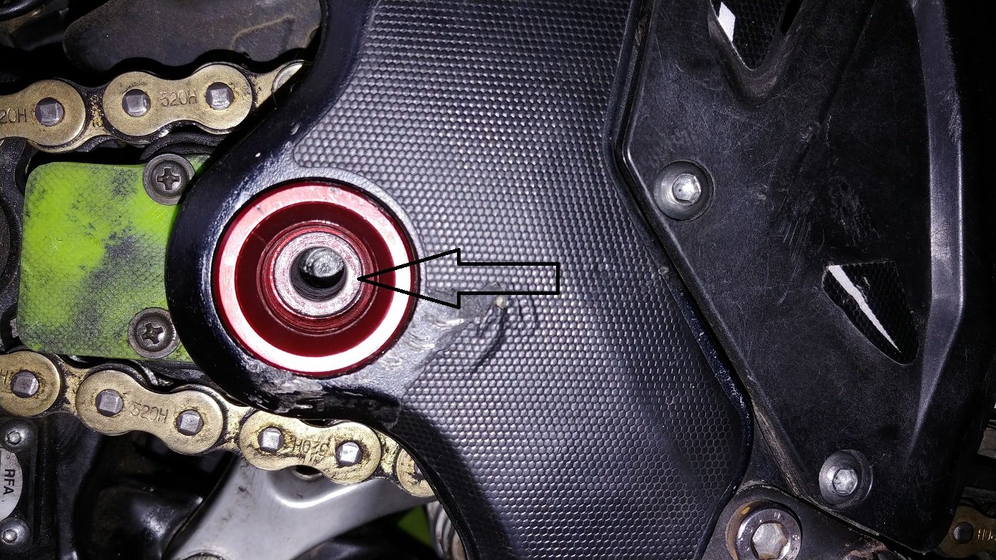

Hi, this is Ryder living in South Korea.
During maintenance, I found out that the rear swing arm fixing bolt was cut off.
So I want to know if I can separate the side frames.
Thank you in advance.
It's translated into a translator application, so I understand if there's a wrong sentence.
No you can't remove the side frame individually.  The left and right side are all one unit which make up the rear frame.
It is part number 8 in the attached picture.
Hope this helps.
