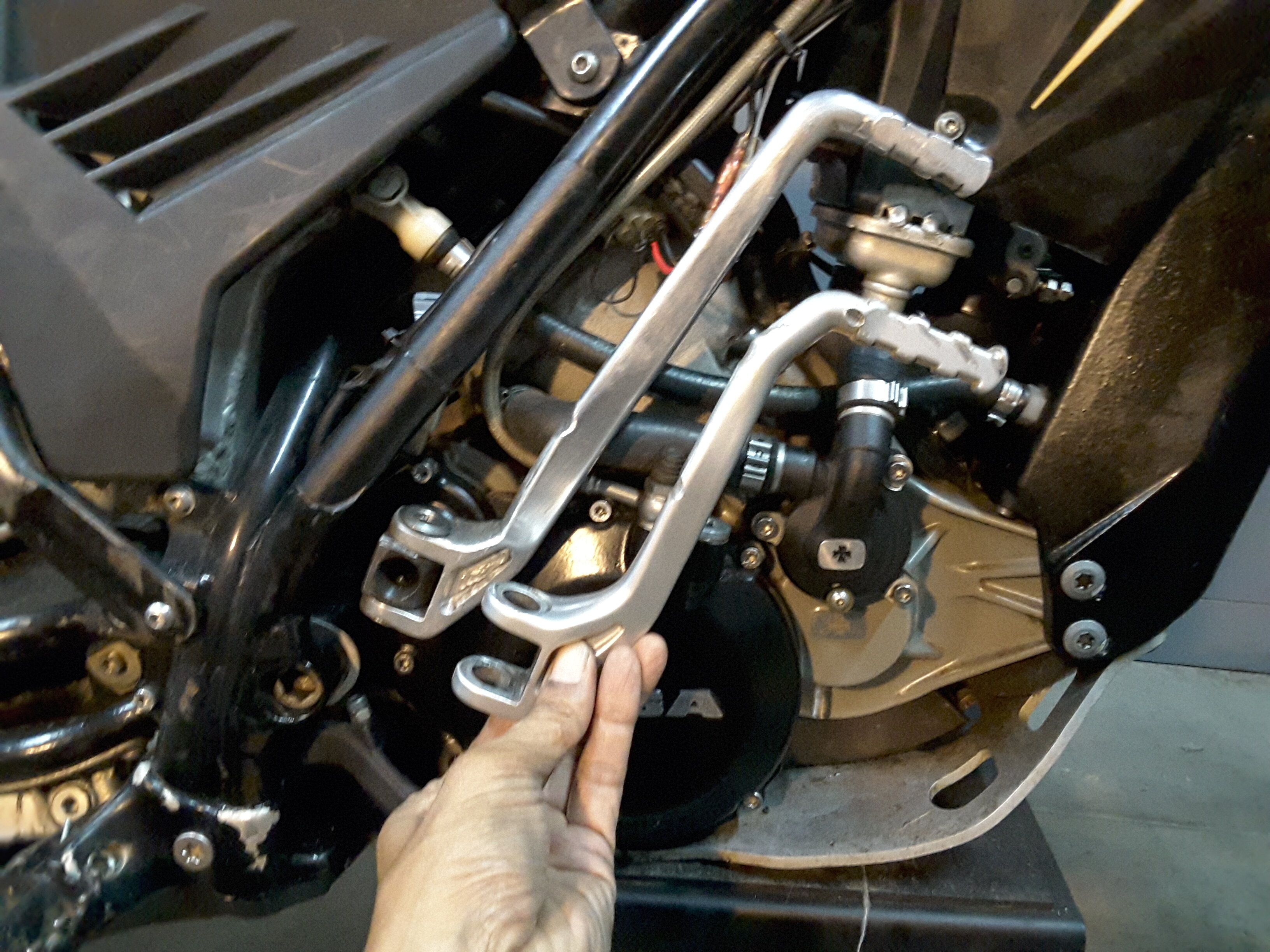

I decided to make my own longer kick starter..using aerospace 7075 aluminum, and basically "carved" it using saw and files..it work well.. but as you can notice it had several adjustment to clear the subframe bolts..
