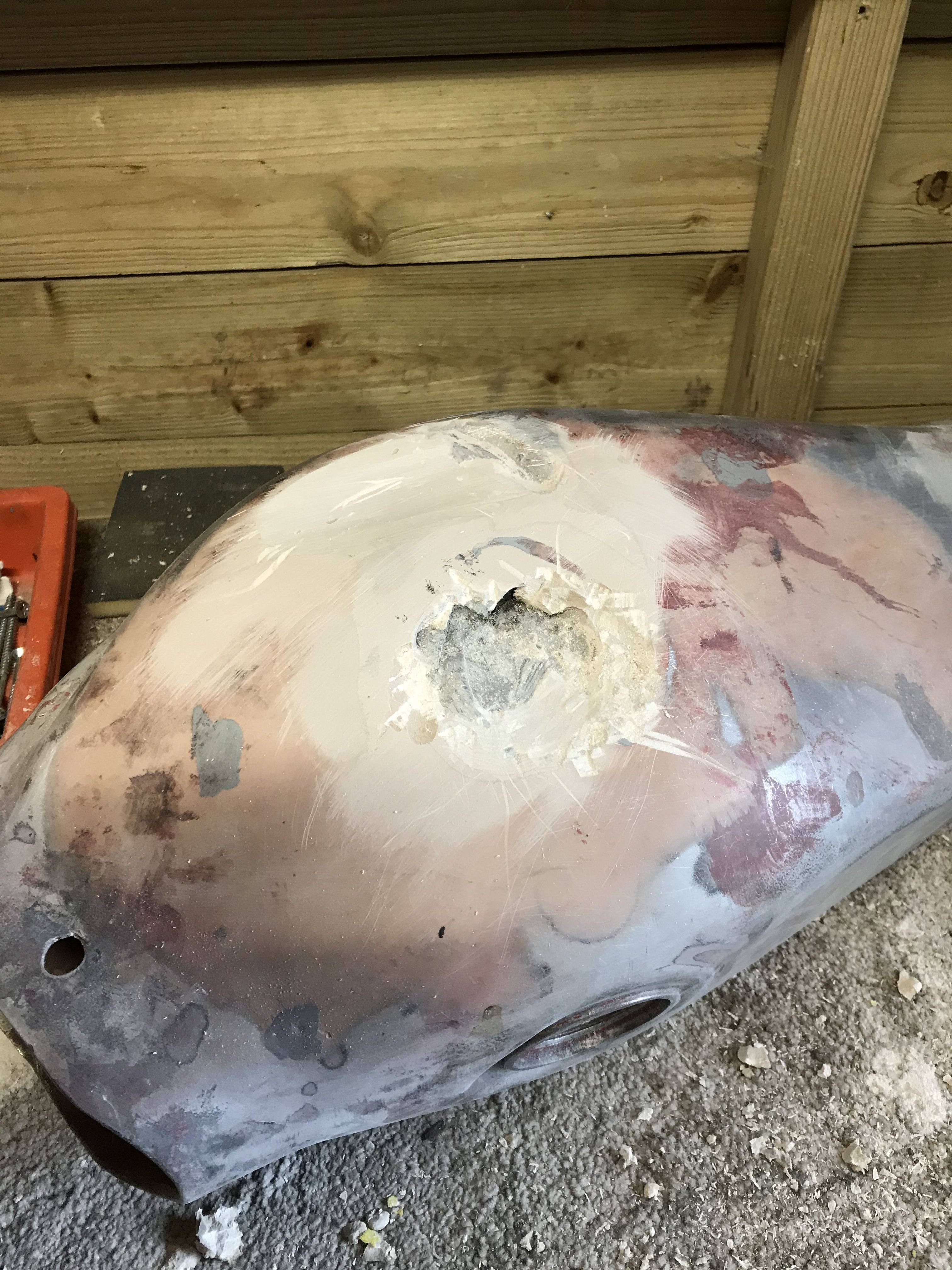

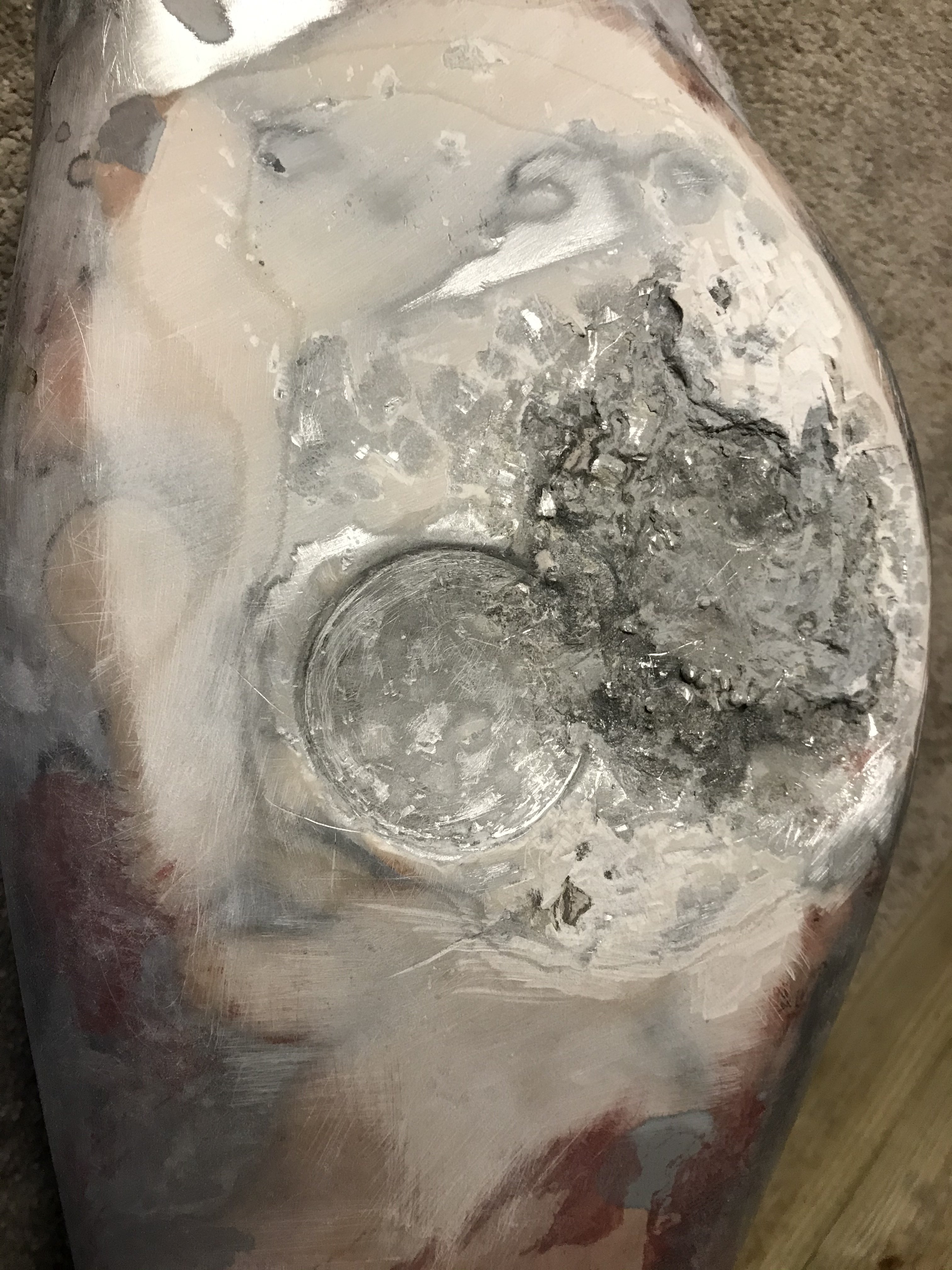

BUT now I have a petrol leek it’s an alloy tank but never looked very good on one side so off it came and stripped it. Wow what a mess someone has done
just wondered can it be salvaged ? Nice to know what you guys think would  really like to save it. Here’s a picture
Looks like hard work. Just get a new one from In Motion. Decals, or no decals. Your choice. They are quite well priced.

In the hands of someone who knows what they're doing (should be able to find someone in Sheffield if not nearer) it should be able to mostly be pulled out ... it'll still need a bit of filler, but only a skim rather than a whole tub's worth.
If the leak is from the dented area it'll need welding, too.

Thanks for the advice guys. Taken all the filler off looks like someone as tried to use solder as there are big blobs all over
will have take some time and find the right person to sort it. I have a plastic spare for the time being. My other two bikes have fibreglass
tanks they have been sealed but you can not leave petrol in them. The removal of ethanol looks good Do others use this process.

If you can find someone who does ally gas welding they'll be able to do it right, check places that do classic car bodywork.  It's worth sorting, ally tanks are brill :)
