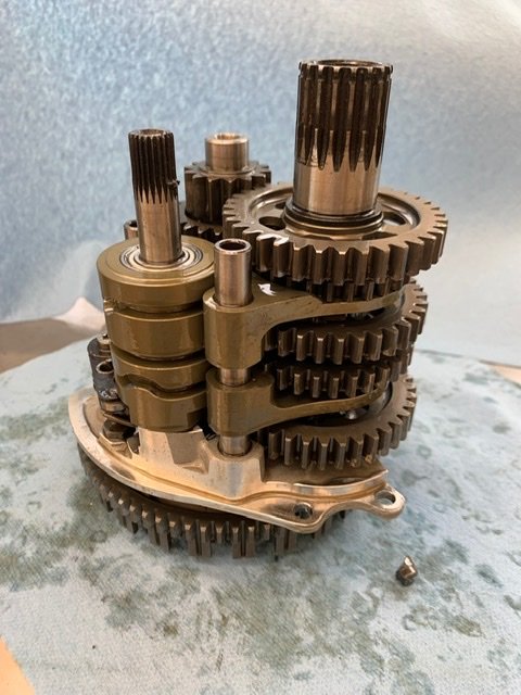

I have a customer 2012 Explorer (with fixer nut).  It was stuck in 6th, I popped out the gearbox and found a broken gear. 6th drive gear tooth/engagement dog if I have it right.  It appears on 6th the teeth just extend out to make an engagement dog.  Not very thick there so seems a weak spot?  But I always tell people to shift this slowly and gently and they will last great.  Start ‘jamming gears’ like an enduro bike and you could probably break it in an hour.

Here are some pics of the gearbox for those interested.   What a neat setup.

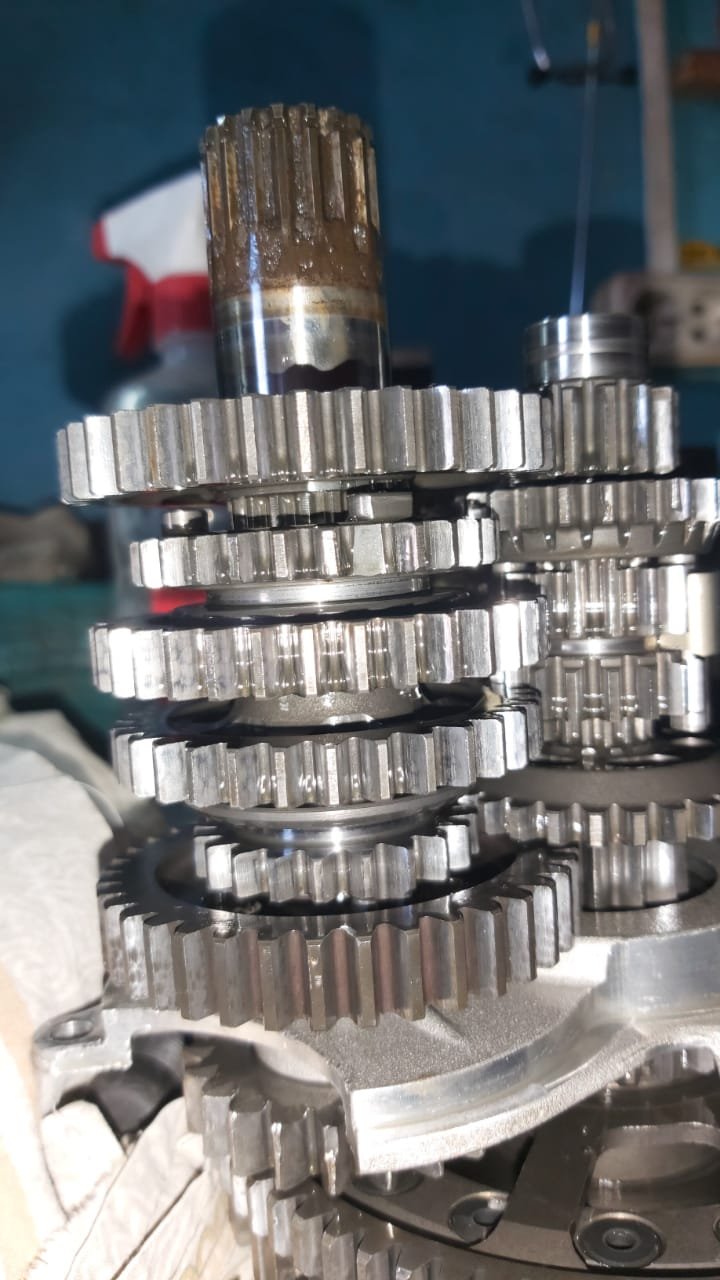

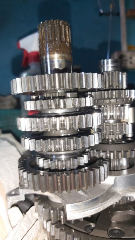

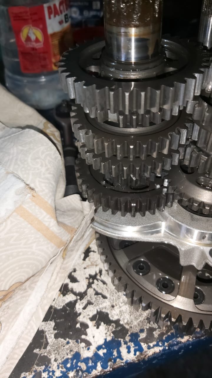

I have same problem. One teeth on 5-th gear was damaged. Is anybody know some internet-market, where can i buy parts for gearbox? Thank you!

Send a PM to "peterb" on here... They don't have a website but do have some gearbox internals ;) You can find him here on the Ossa forum and also the Vertigo one.
