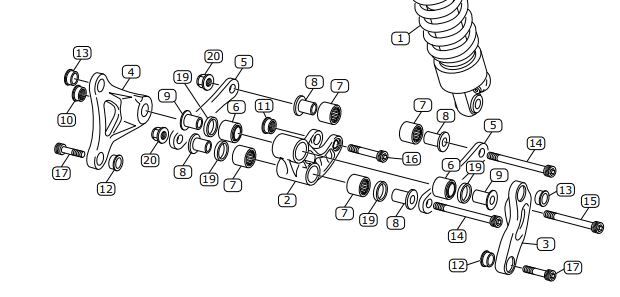

Hi can someone advise me on how to get the dog bone on the vertigo back between the two arms it has the  part number 4
Edited by dwb5151
For anyone having the same problem you need to loosen the swingarm off a lot, then do the same for the two bolts with the part number of 17. Then wiggle the dog bone back in.
  • 2 weeks later...
To remove part four, you must loosen bolt 15. 17 and also loosen swing arm bolts.
The yellow parts shown in the picture must be removed.
The parts you want will be separated.
