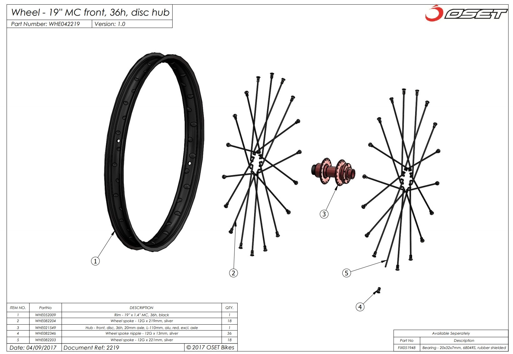

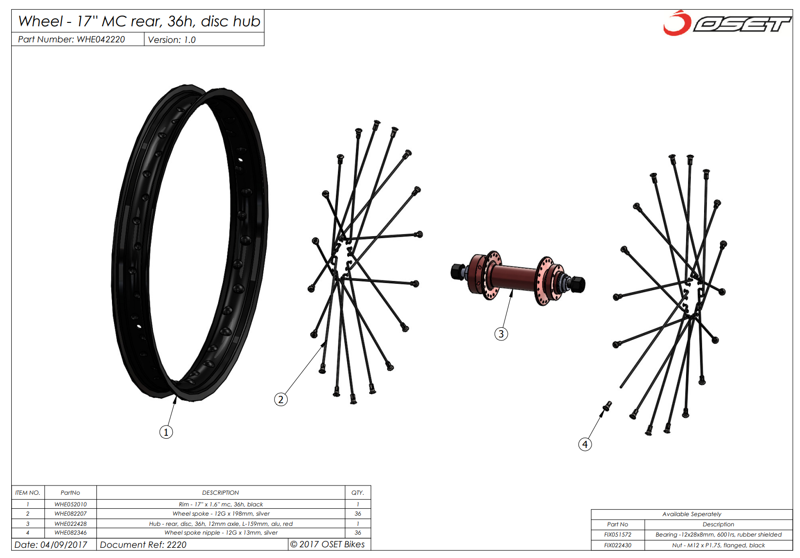

Thank you for the tip. According to these blueprints OSET 17" rim is 1.6".

I agree, the tricky part is where to find spokes. OSET uses in 17" rear wheel - 36 x 12G x 198mm with 13mm nipples. After a lot of research I found a guy how can make custom spoke set to size https://www.ebay.com/itm/264937086310
Now is the questions what is the right spoke length for the 18" wheel, if my math is correct based on (17" rim / 198mm spoke) (19" rim / 221mm spoke)  the 18" rim should have 209.5 mm spokes
