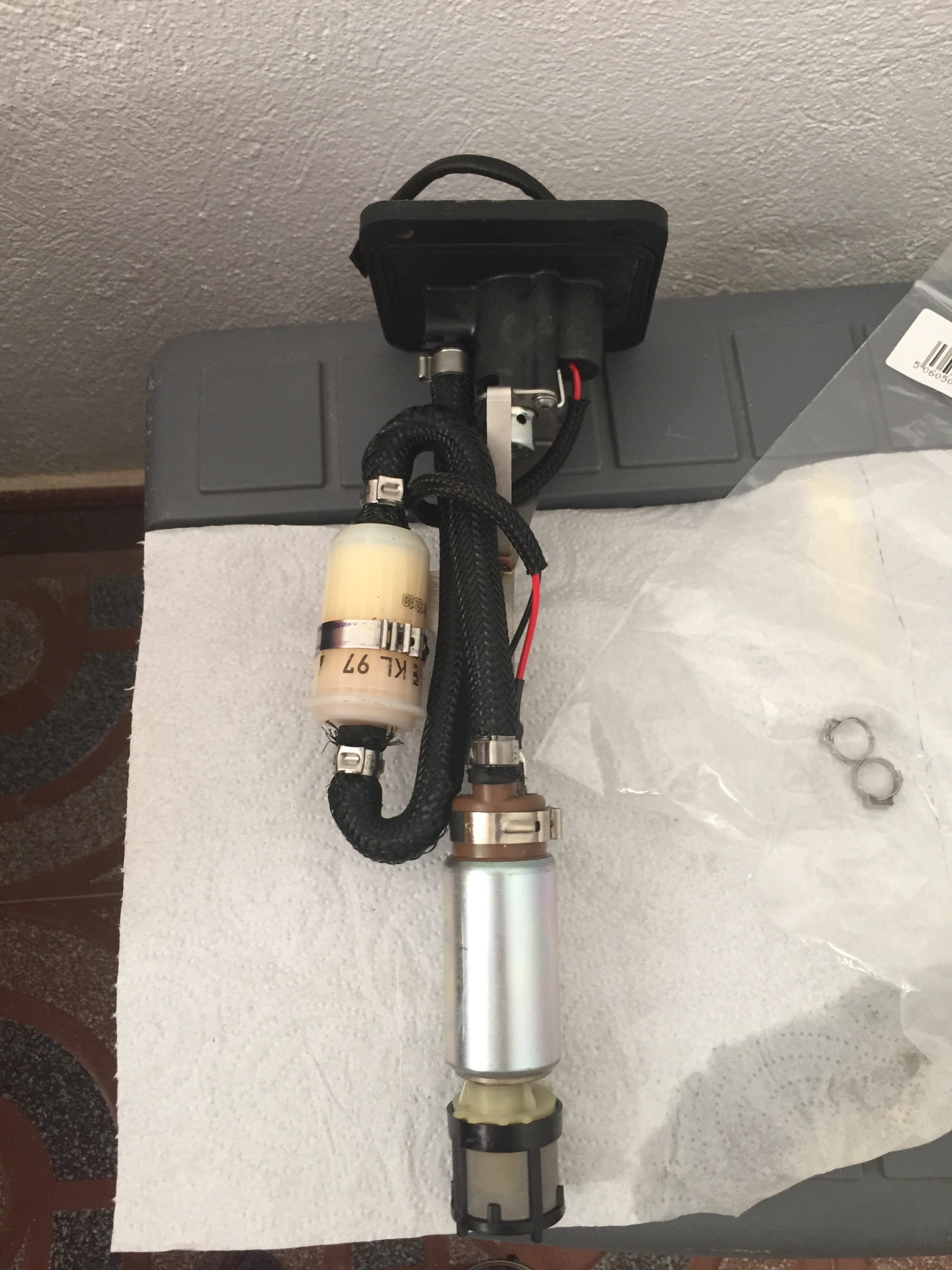

Here's a picture of mine assembled with the new filter ready to go back in the tank, that should give you an idea of how to go about changing it.
